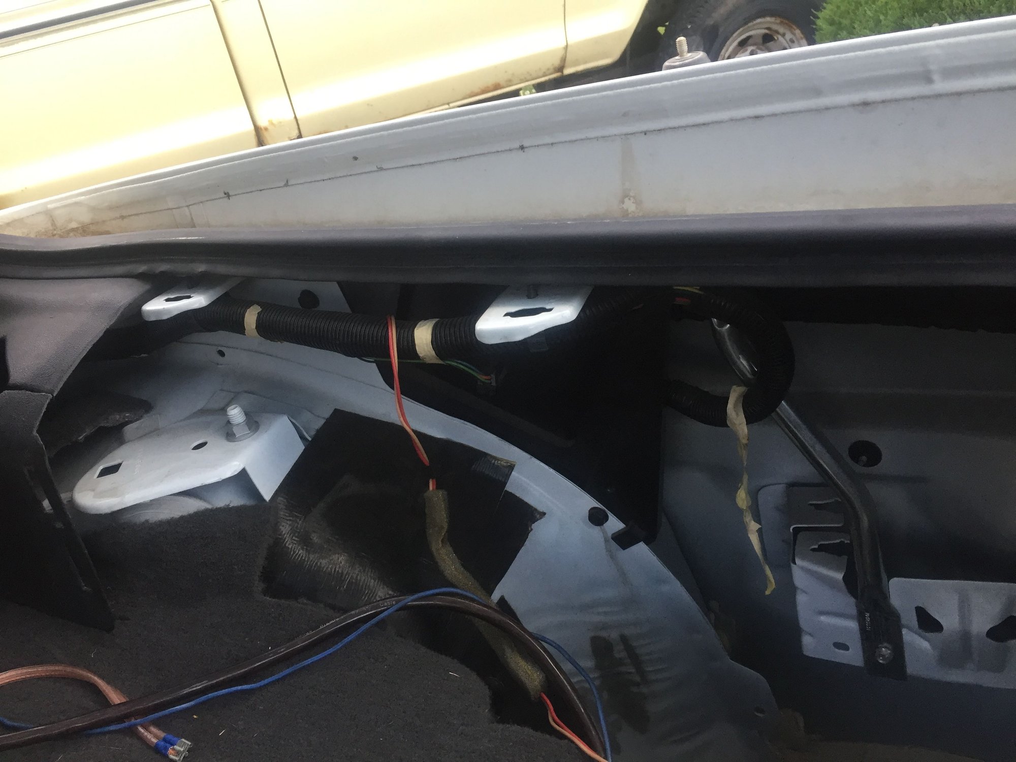

Originally Posted by VIP1
I believed you guys I have searched for the amp everywhere mine doesn’t look anything like a amp, it’s plastic.. it took this picture to realize what I was looking at..

Originally Posted by WhiteBird00
Since you have six speaker positions (which is actually eight speakers since the doors have component mids and tweeters), it is an absolute certainty that you have a Monsoon system... there was no other factory system which had six speaker positions. The amp is quite small and is mounted vertically to a bracket in front of the spare tire. You can find a photo of it in the Monsoon FAQ sticky at the top of the section. The amp doesn't have a remote turn-on wire like most aftermarket amps - it uses audio signal sensing to turn on and off. The correct wiring colors are also listed in the FAQ. Of course, if you had used a proper wiring harness adapter to install your new head unit, you wouldn't have needed to know the wire colors anyway.
i asked because you guys know, I was under the impression that it looked like a amp and was on the other side.. the wires I need to know are for the new hu to the new harness/kit.. so I guess it wasn’t proper?

WhiteBird00's Avatar
Ungrounded Moderator
Joined: Nov 2003
Posts: 11,330
Likes: 346
Installing a wiring harness adapter doesn't require any knowledge of the factory wiring colors. The adapter harness has all the standard aftermarket head unit wire colors so it's just a case of matching the wires of the HU with the same color in the adapter harness... red to red, yellow to yellow, etc. Once you have connected the matching color wires, the harness simply plugs into the factory radio harness connector without having to cut or splice any wires there.
