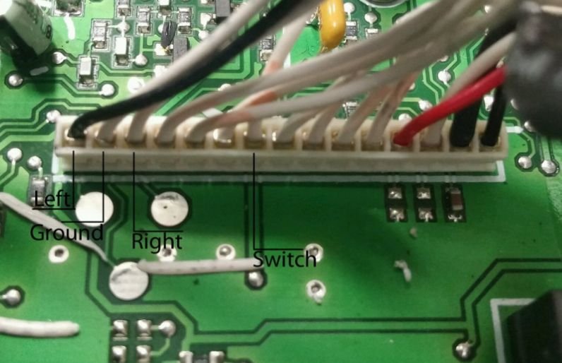

Does it make sense to solder/tap a JL audio MBT-RX in the stock monsoon HU for adding Bluetooth? RCA black to pin 1, ground black to pin 2, RCA red to pin 3, and power red to pin 7. 02 trans am w/CD HU w/o external changer.

I used the MBT-RX in my car with a PXDX aux adapter that mimics the CD changer. I didnt really want to go soldering in my radio (Im not very good with an iron). Setup works perfect.

I see, thank you very much for the response. So you “plug and play” that aux adapter into the CD harness port behind the HU? I’m guessing it doesn’t require the external changer either? If ya don’t mind, can you recommend or link the aux adapter you’re taking about please.
