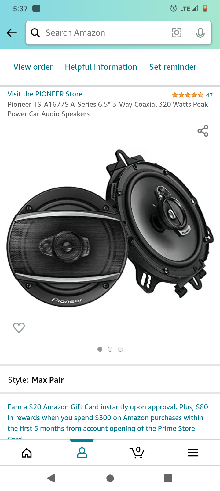

Hello I just installed a new speaker in my driver door while I had to panel off to replace the window motor and repair the cracked panel. The speaker seems way quieter than stock. I know it has a amp, new head unit, and sub (were in the car when purchased. I'm assuming to fix it I would need to direct wire them to the amp but I also have no idea. It's a 2000 trans am

Does the car have a factory Monsoon system or an aftermarket amp? If it's a Monsoon system then you have the wrong kind of speaker. Check the Monsoon FAQ sticky linked at the top of this section for more information.
If it's an aftermarket amp then you may just have the speaker out of phase (wired in reverse of the other speakers). Switch the positive and negative wires and see if the sound improves.

So for what it's worth I flipped the wiring and it sounds better but the other side (only have done driver side) still sounds a lot louder but it's blown. I think it's because these are not the right speakers so a 2ohm? Speaker would be better. It has a jx500/1d amp

Actually no... the difference between 2-ohm and 4-ohm speakers is noticeable but not a lot. It's only 3dB which is equivalent to about one click of the volume ****.
You don't have the wrong speakers - you have the wrong amp. The JX500/1D is a class D subwoofer amp. It is low pass filtered to produce a frequency range of only 10Hz - 150Hz so you'll only get bass to your full range door speakers. Without the higher frequencies, the speakers will appear to be much quieter even though they are getting the same power (it takes a lot more power to produce the same volume in lower frequencies than it does in higher frequencies). That amp would be more suitable for the sail panel subs that came with the Monsoon system (if you still have them), but it is definitely not for the doors.

There's nothing wrong with the speakers you got even though they don't match the specs for the Monsoon system. They're close enough that they should work fine. If you had a Camaro, there would be more of a concern because the factory tweeter is mounted in the middle of the speaker rather than separately like in Firebirds.
No, you could not move those speakers to the back later (well, technically you could but they would sound worse than they do in the door). They won't fit in the hatch area and the sail panels are designed to have subwoofers rather than the full range speakers you bought. Plus the Firebird has dual voice coil subs in the sail panel, so there are two pair of wires while your speakers only accept one pair.

Alright replaced both speakers and I'm happy with the sound up front. Now turning it up enough for the front makes the sails sound terrible so debating on killing the power to them or replacing them. It's never ending the things I want to do
