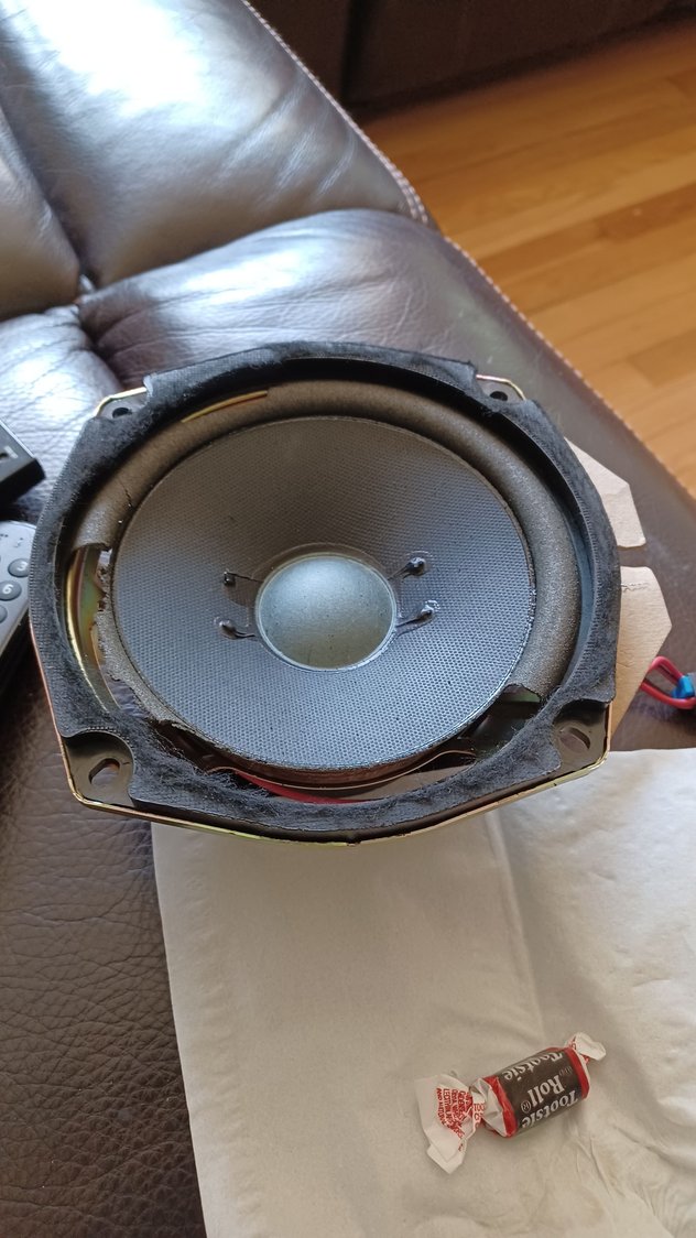

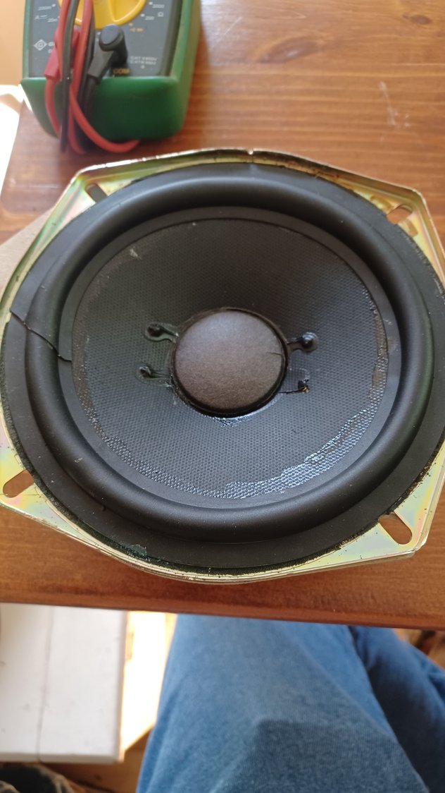

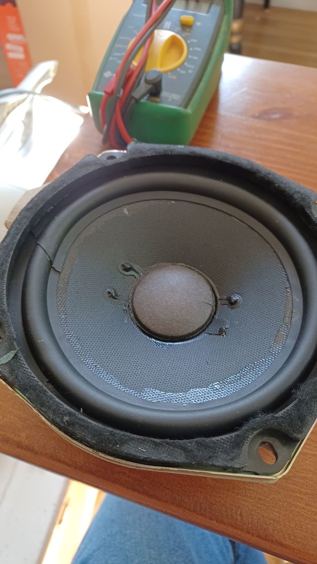

The sail panel speakers foam went away. These a re 4ohm/4ohm dual coil spacial speaker. Could not find a replacement in my price. Found these re-foam kits. check out these pics. Only about $20 a speaker.

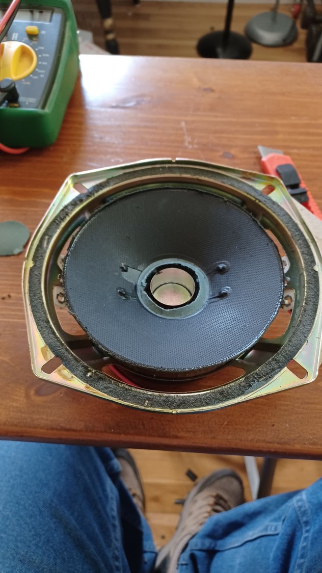

OK, forgot to comment the pics. First of all, Tootsi Rolls are a mandatory part of speaker repair. LOL.
Instructions say if the foam is not an exact fit, then cut and glue. And I did. As per the pictures, I cut the foam at an diagonal just because... The foam was just a little too big and had to be cut. It worked well .

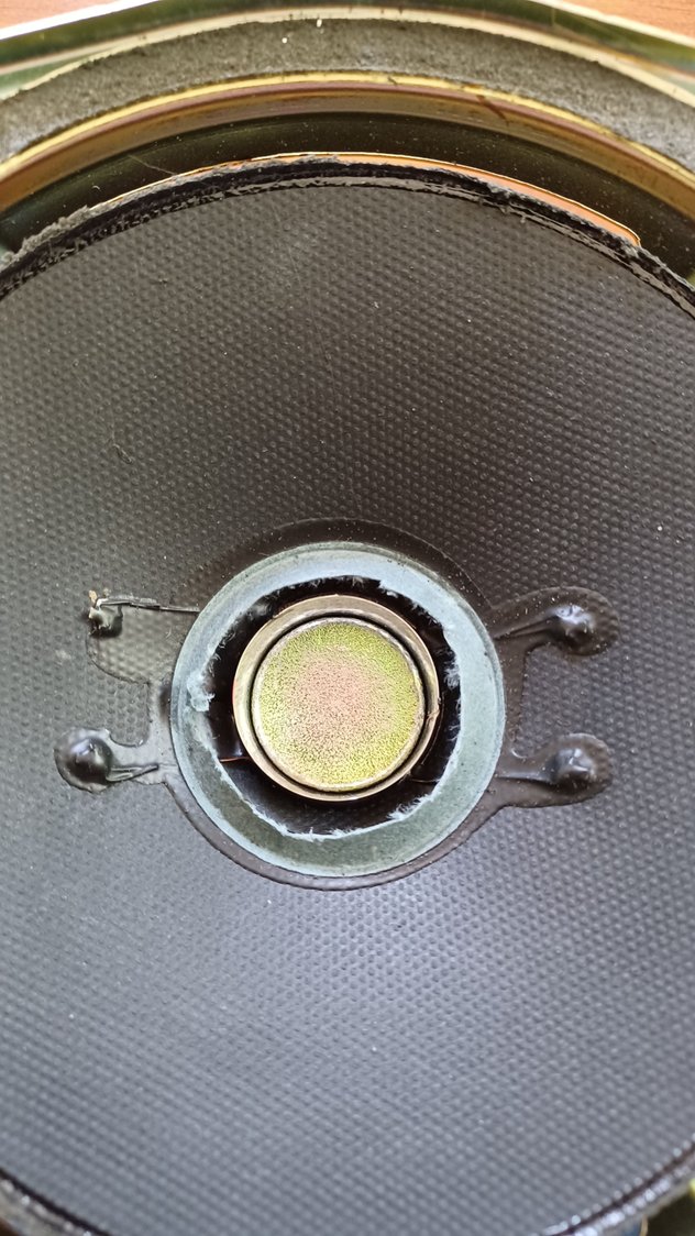

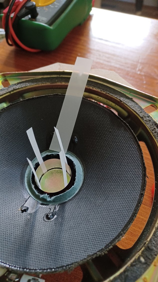

The kit comes with plastic spacers for the voice coil. That keeps the coil from rubbing the magnet, etc. The spacers were too wide for the small diameter of the OEM coil/magnet. I had to cut the spacers to about 1/4 of their size to work and space the coil properly. The one pic shows the original spacer (rather wide) and my cut/trim spacers sticking in the voice coil. Yeah, you have to take a razor and cut off the paper cone. Then glue on the new one they send.
Put the meter on the speaker. Reading was 4. OHM on one coil, and 3.99 on the other. So I'm guessing these speakers are OK. On the back side of the speaker is printed is "4 ohm/4 ohm". for each coil.
