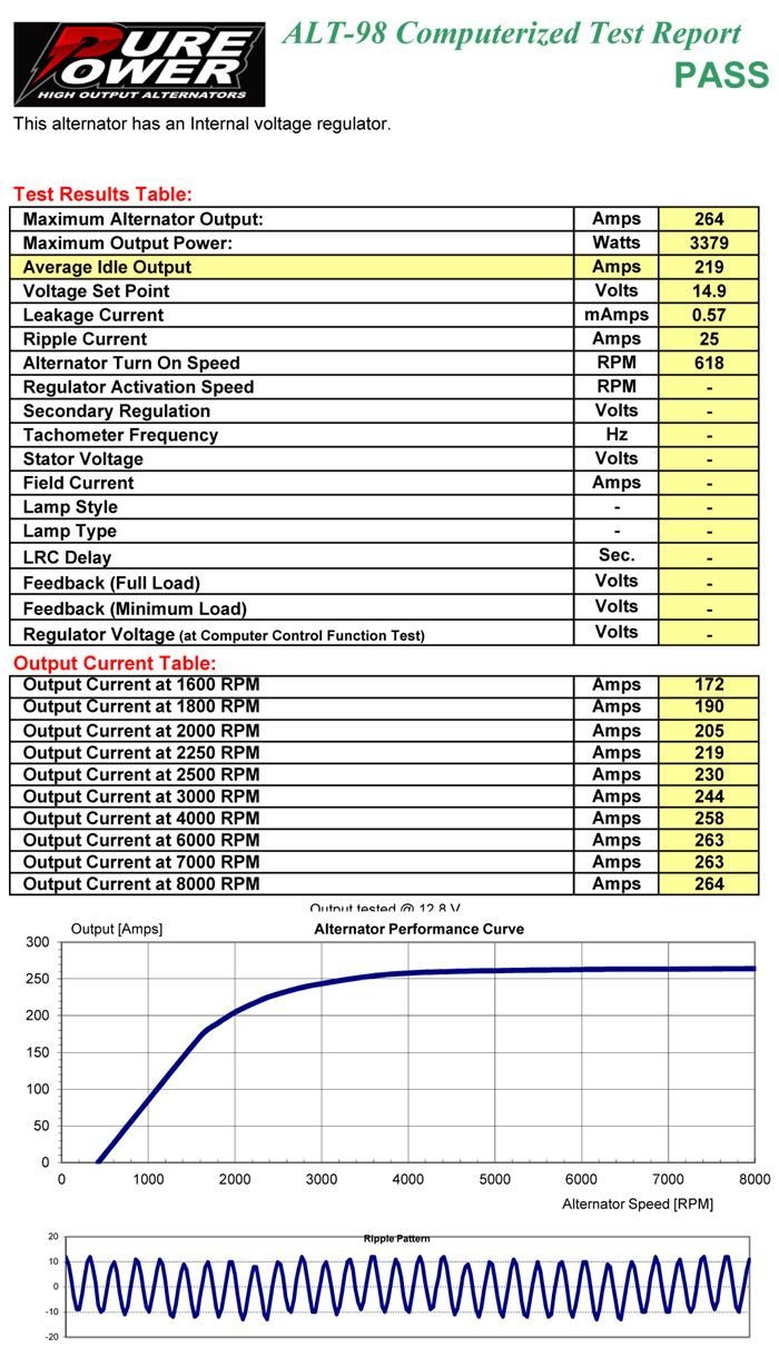

Before you buy, always ask for the alternator output profile. What will the alternator output for amps and volts at idle RPM? It does you no good if the alternator does its best work only at far, far above idle.

And this would be the data for my Tuscon 250A Alternator:
