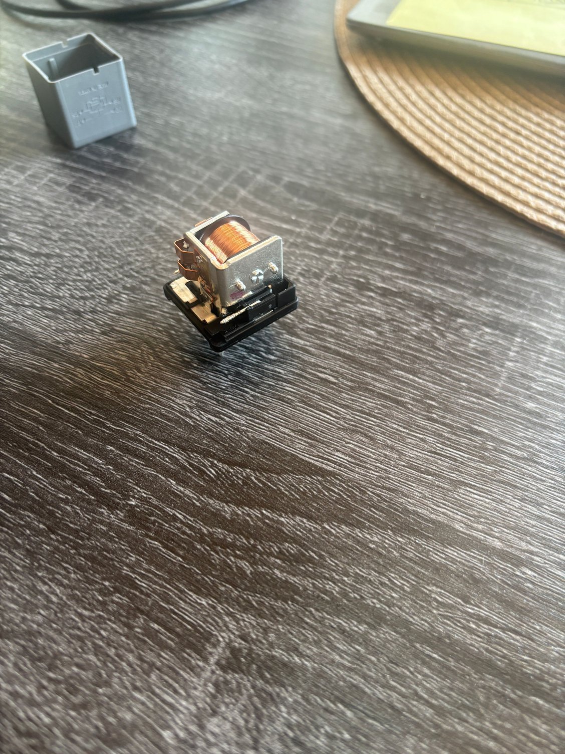

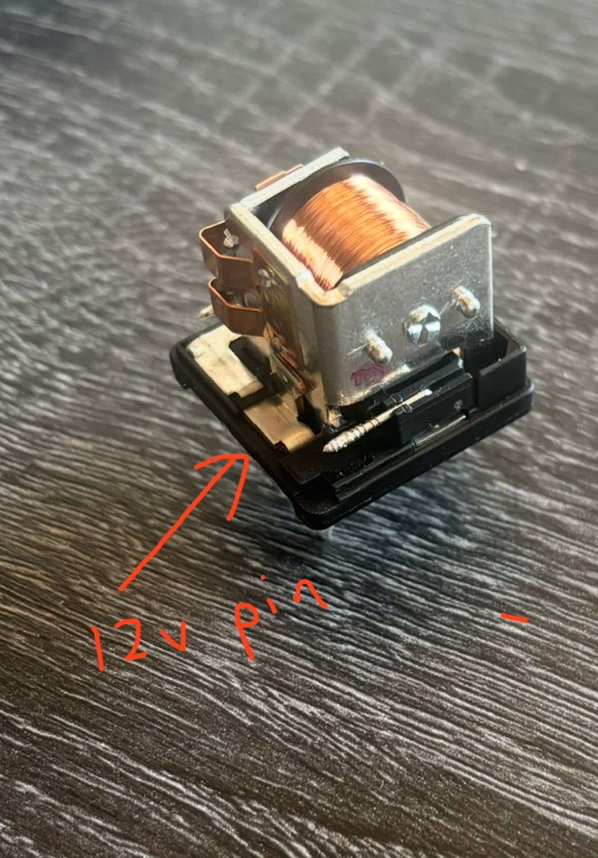

For a non-electrical guy........how do I interrupt one of those pins using an on/off toggle switch while the car is left parked, off and unattended?
That company 4211 sends us a Type 1 relay like ours with a wire soldered somewhere inside and it works. I just don't know where to solder that wire. I took the top of the relay switch off but have no isea whats what.

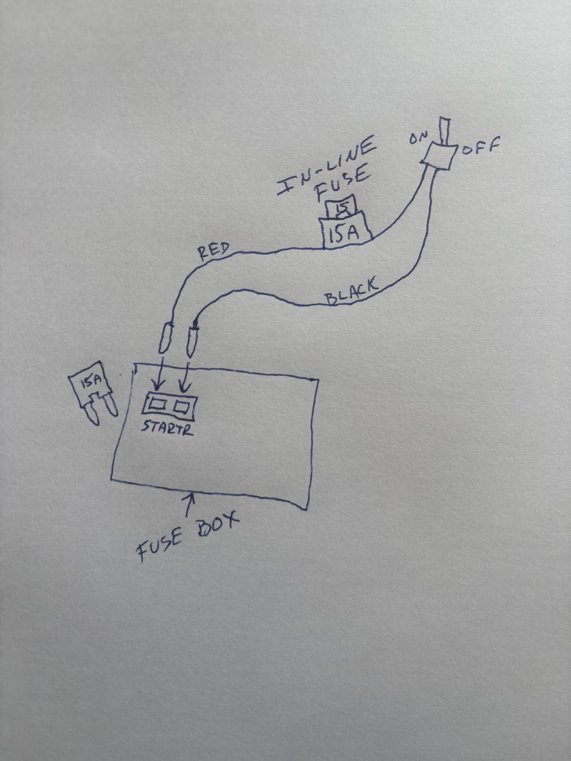

I found a YouTube video last night of perhaps the easiest way I’ve seen so far. Not using the big starter/relay. But pulling one of the small 15a fuses from the STARTR port. Splitting the two prongs and soldering each to the appropriate wires and plugging them into the START port. Done.
O was gonna do this today. But let me know what the Neutral Wire method is.

Well, yeah, that's an incredibly ghetto-looking way of doing it. Or you could just add the interrupter switch AFTER the fuse, and keep your fuse box looking normal.
The neutral-safety switch should be inline with that circuit, so you wouldn't need to go under the hood to add the extra switch.
yea, doesn't look the greatest, but does the job. But yes....I prefer to do it your way to leave the fuse box factory looking.
You mean leave the fuse in the port as-is. Then go underneath the fuse box where the two wires come out of that STARTR fuse port and tap into the positive wire with my on/off switch....and I will not need to add a fuse on the positive wire....?
I never removed that fuse box, i'll have to see how to get it out and flip it over to see the wiring.
ok, so i can put a neutral-safety switch on this same STARTR fuse port? I'm not understanding how it's attached compared to the on/off toggle I was going to use.
If its easier than your first idea i'll do it.
Does it stop the STARTR from engaging while the car is in PARK....?

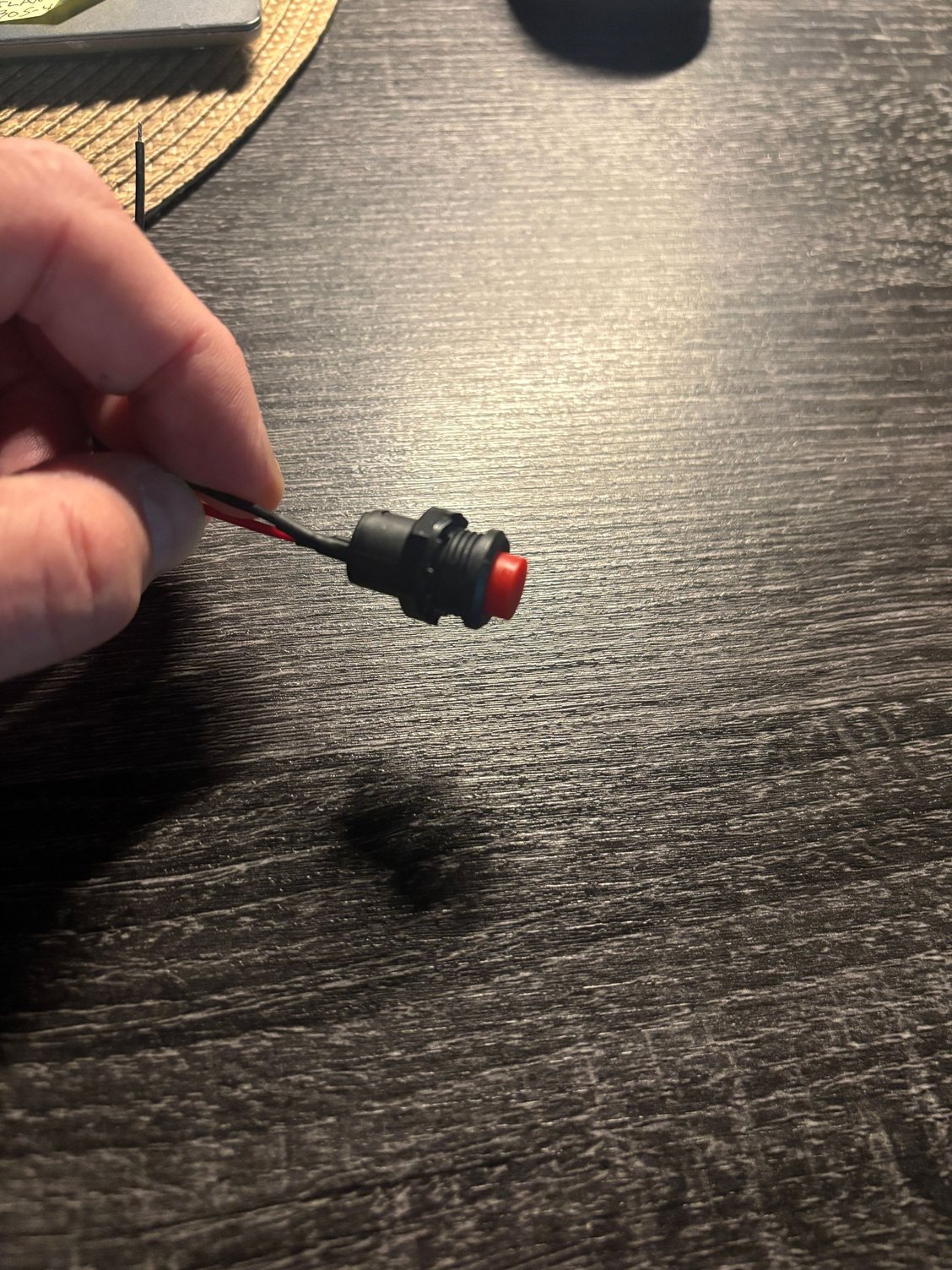

I have a bag of these. I’m gonna put it under the carpet in a place that never gets touched, so it’ll be 100% invisible. I’ll know where to push. This switch stays in, flush when closed circuit. Button out when open circuit.

Best way I think is the way I diagrammed it in post #7. Why? If the switch ever breaks it will require me to stand there and do some wiring work to get the car started. The way in the diagram, if the switch breaks, I pull them out and pop a spare fuse in and start the car in 15 seconds. Then later replace the bad switch.
As far as it looking ghetto.....Yes, but I'm the only person that will ever look at my fuse box so thats not an issue. I have a Medeco keyed, fully hardened steel hood lock so nobody can ever pop my hood to disable anything. Installed that 27 years ago on this car.
I just need to get 14 guage copper wire and solder it to the switch with an inline fuse for the positive wire. Thats it. And a company makes a plug thats made to pop in there as a dummy fuse that you can solder your own wires to and it actually looks pretty good.
