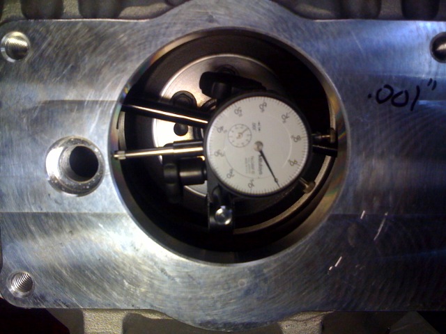

Don't forge to check the bellhousing for run-out and trueness to the block:
