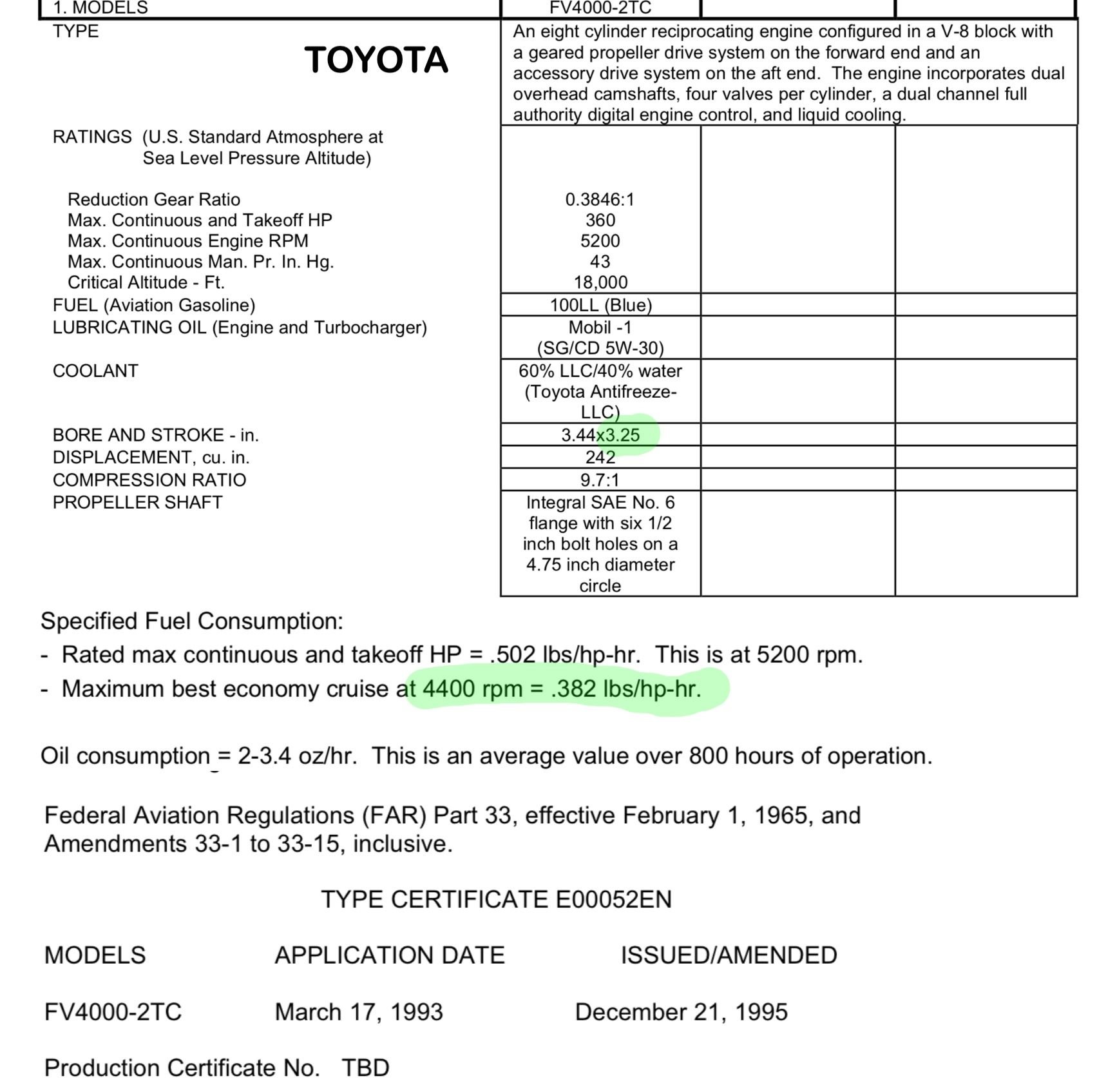

Another inspiration, besides the LS series of engines, is the Toyota FV4000-2TC engine that was FAA certified in 1995. I believe is has DOHCs and chain drive, because that’s what Toyota designed for their cars.

Toyota got this done with a 3.25” stroke, in an 8 cylinder engine that produced 360 hp at 5200 RPM. I plan to test 3.25” through 4” stroke, with the goal of 0.38 BSFC.
We are limited to about 2700 RPM on the (geared) output shaft, but I’d like to be in the 1600-1800 RPM range for the 250-325 hp cruise power setting.
Mercruiser has DOHC engines that are based off the LS and the big block. The big block is an absolute unit and was available with twin turbos. It will run WOT at maximum rated power as long as you want to pay for the fuel going into it.
We are definitely NOT going to use a Big Block. There is an FAA certified one, Orenda, that weighed a ton (well, not quite a ton), and was rated for 600 hp. Too much power, too much weight.
