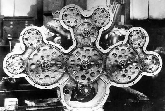

Originally Posted by G Atsma
This will not eliminate thermally induced gear lash.
Imagine how heavy that gear is!!! Hey, it was on a TANK!!!
Old Jan 19, 2025 | 06:57 PM
  #103
TonyWilliams's Avatar
Joined: Dec 2024
Posts: 83
Likes: 7
From: San Diego, California USA
In a geartrain, how does one adjust backlash where the gear locations are fixed?
I haven't heard of any methodology concerning that, and I believe that will be a stumbling block that can only be solved by overcomplexity, which I KNOW you'd prefer to avoid like the plague.
I don’t foresee any method needed to adjust for gear lash changes. There just needs to be enough lash at the coldest temperature, so that the gears cannot bind.
As they expand, we will have to measure what that is. It’s not like the camshaft EVER becomes unloaded, so even a “significant” lash shouldn’t mean that the gears are bouncing around.
Again, thankfully, this is something largely external to the engine design, and can be shafts / bevel gears like the old WW2 piston aircraft engines, or belts, or spur gears, or chains.

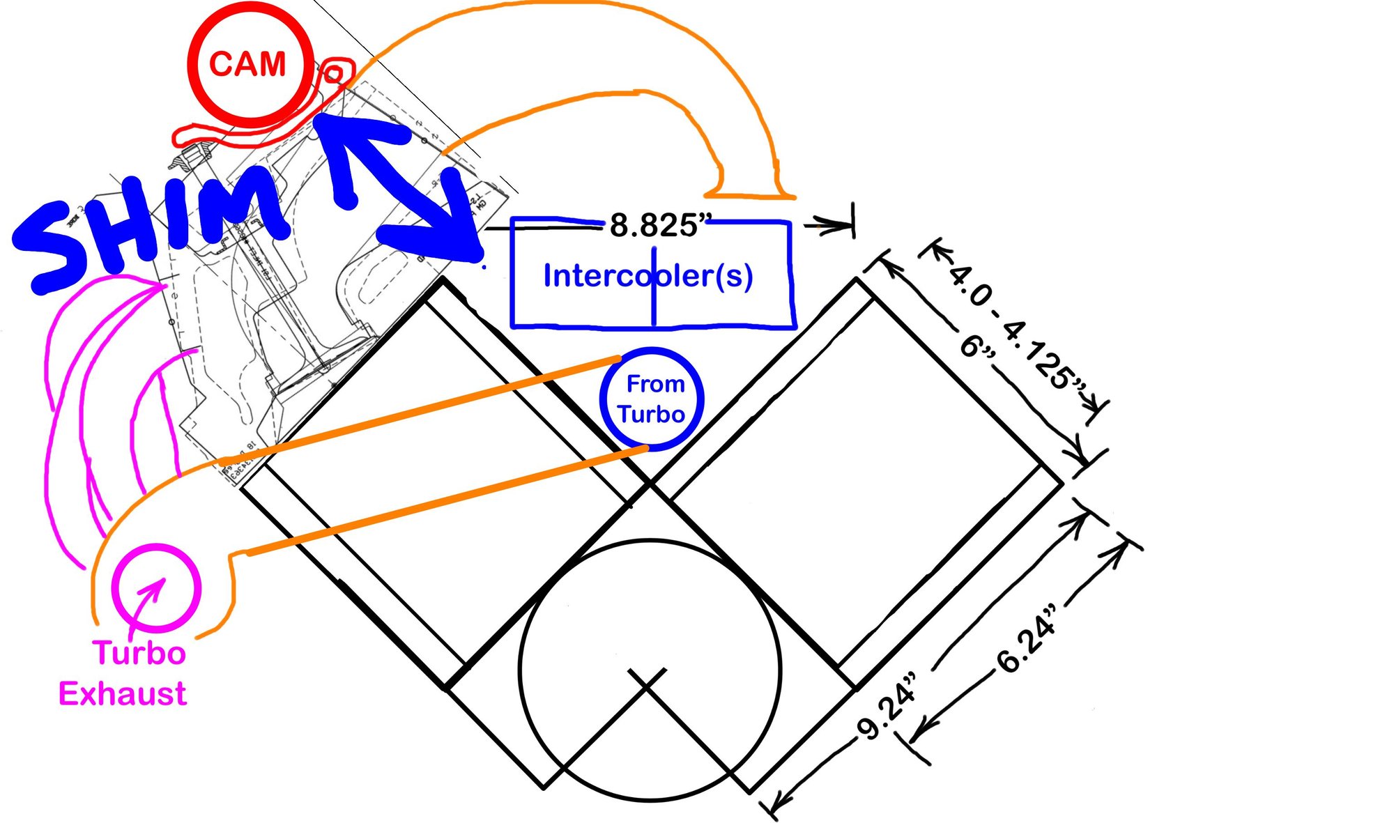

Right now, the only adjustment that I foresee for a gear driven overhead camshaft are shims under the camshaft mounts. Should the block or heads be milled, or the head gasket be a slightly different thickness, or just for manufacturing tolerances, there must be some provision for adjustment.
