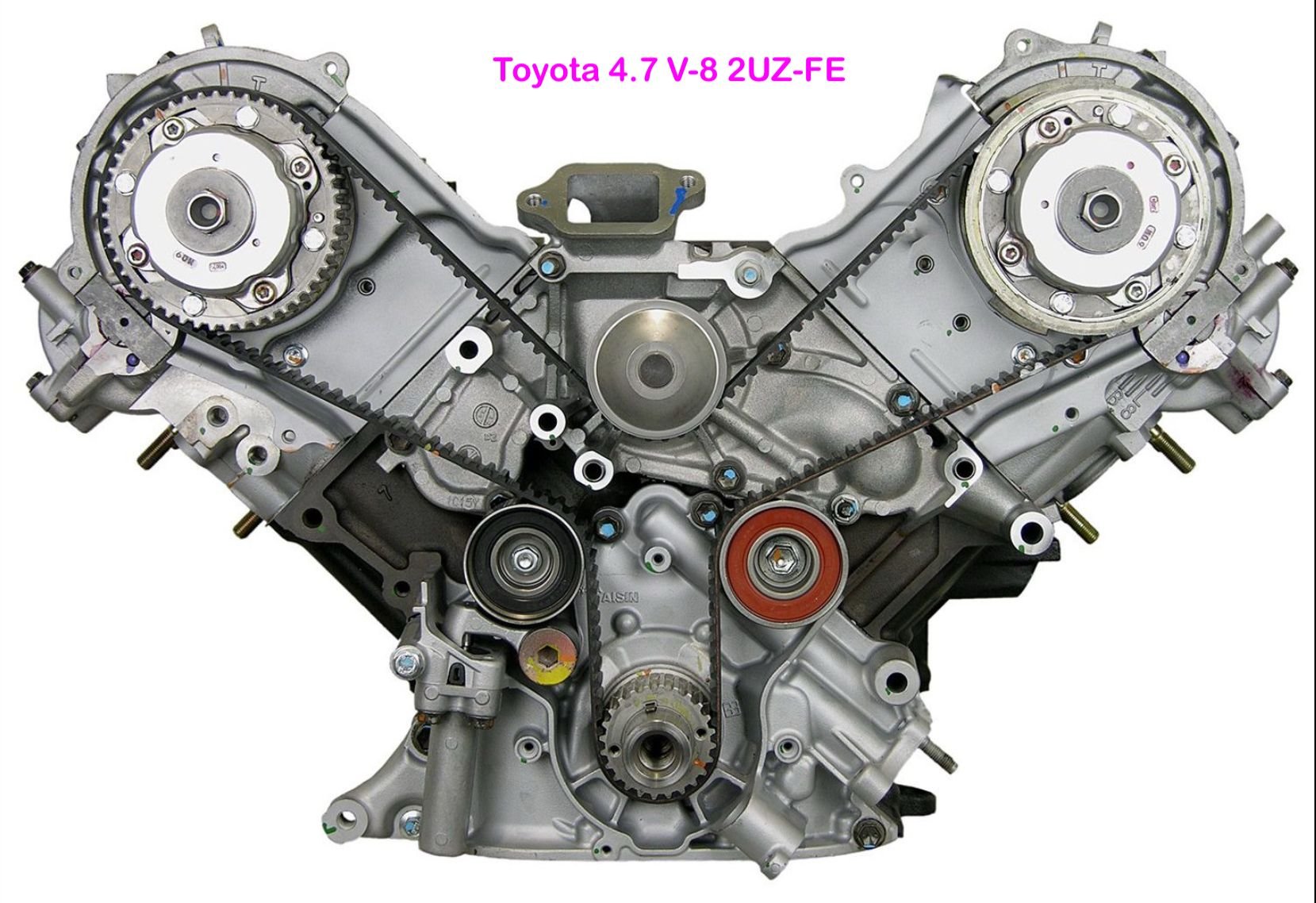

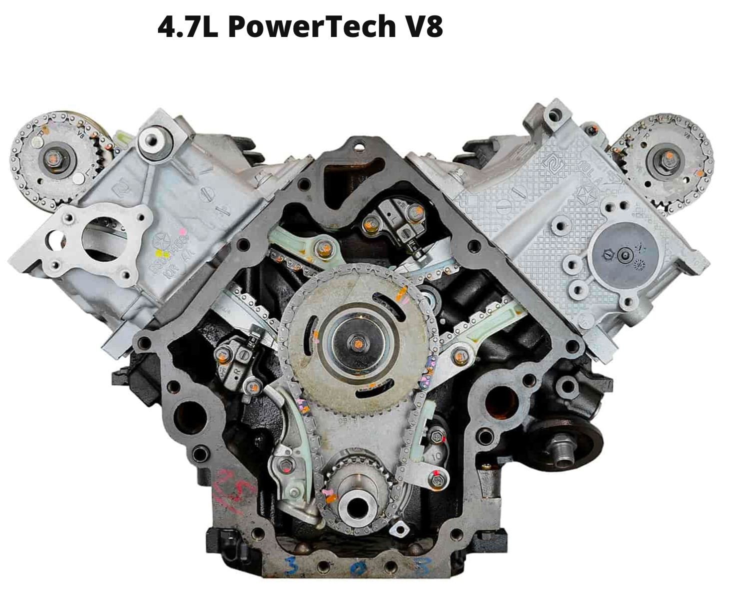

That 4.7 Chrysler chain drive for the camshafts looks like a substandard design (and apparently, is has a history of throwing chains). The Toyota uses a belt drive.
I wonder… if a dual belt drive might be “better” than gears?
The larger distances between crank and overhead cams makes ANY drive system more of a challenge.
I think it's a major reason GM chose single central cam for the LS and Ford for the new 7.3L Godzilla engine. It IS a simpler, more rugged system that is proven to be so. For a relatively low-revving engine, especially, it is a more logical solution for a dependable and rugged valvetrain.
It doesn’t appear that Toyota has had much trouble with their belt drive, and it looks wonderfully logical and simple. I think that I can agree with 500 hour intervals for belt replacements.
https://www.tundras.com/threads/4-7-timing-belt.14118/

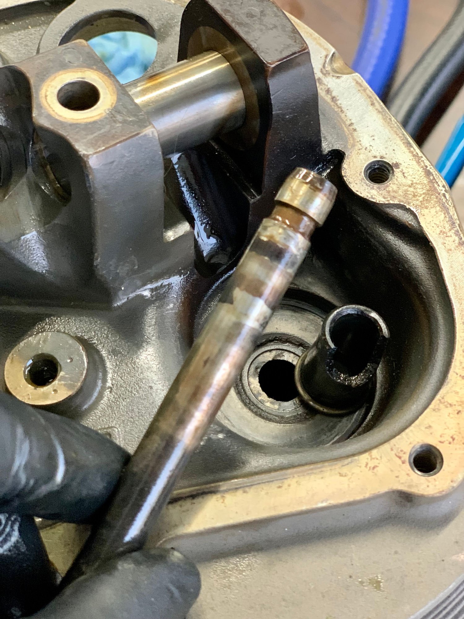

Broken exhaust valve guide - Continental TSIO-520-NB

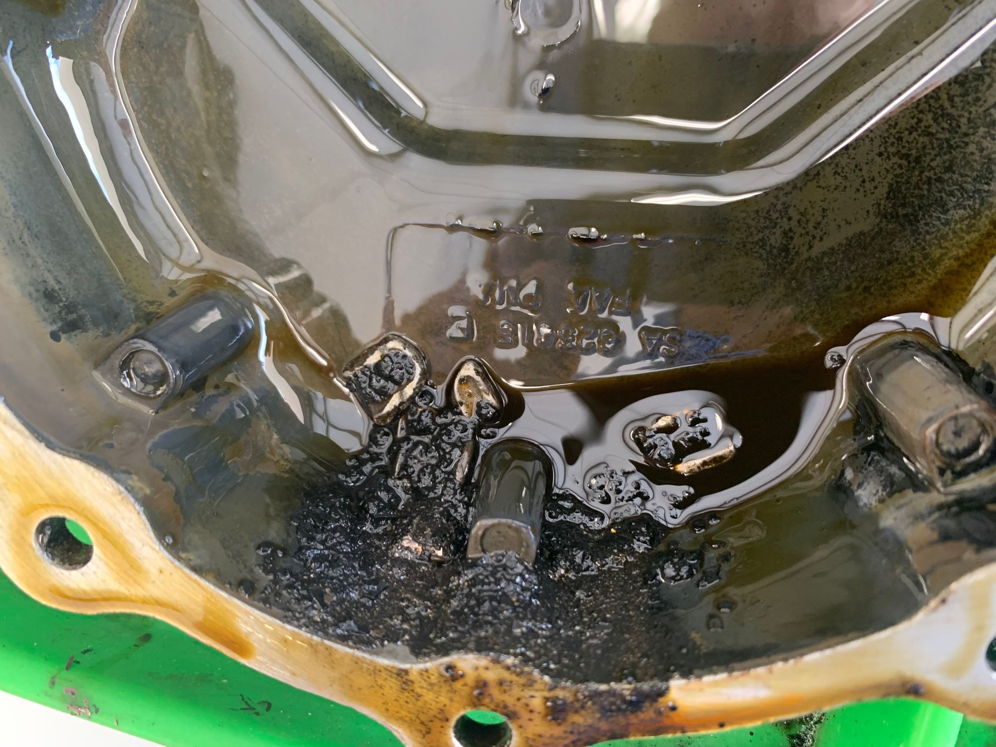

Broken exhaust valve guide debri in valve cover - Continental TSIO-520-NB

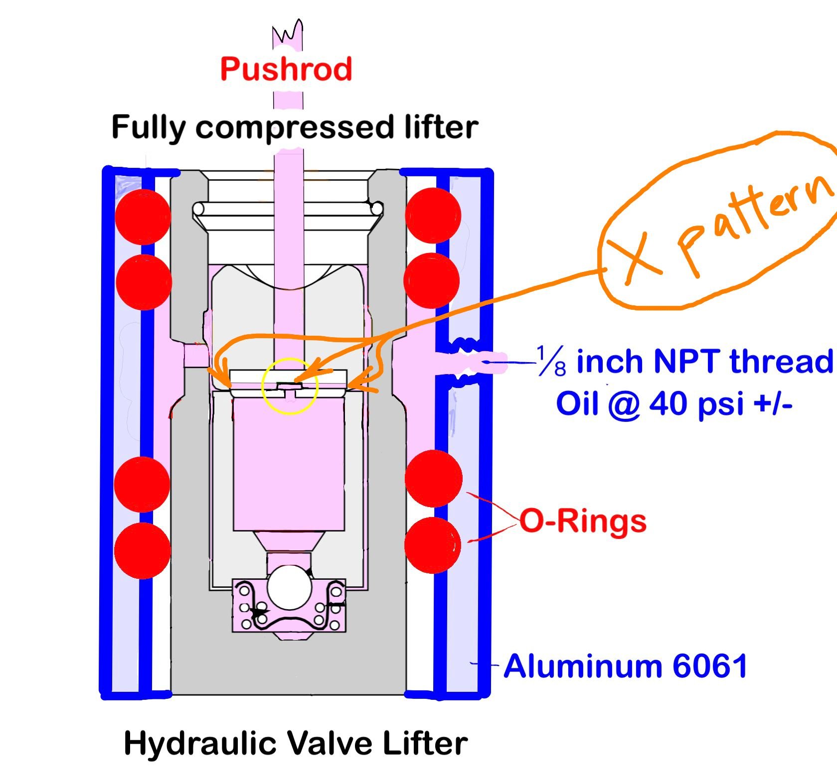

Jig that I designed to prove that a hydraulic valve lifter was properly pumping oil, or not - Continental TSIO-520-NB
