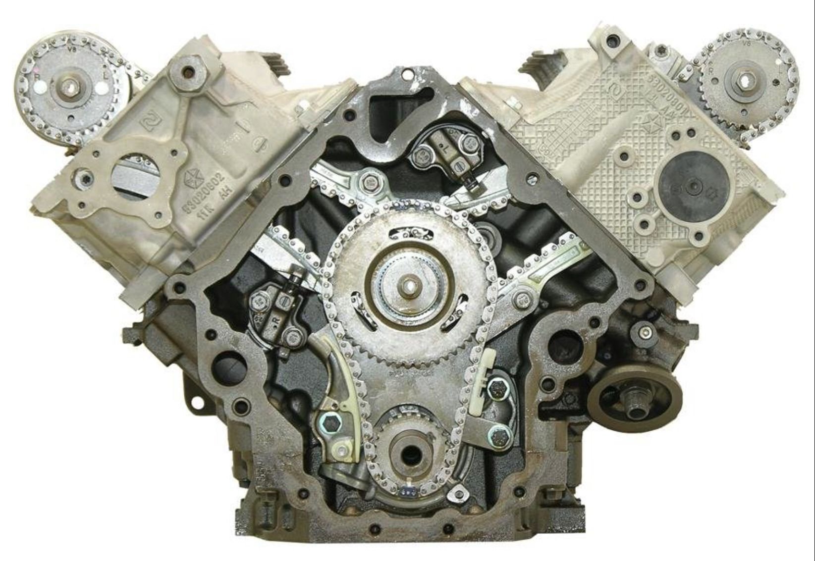

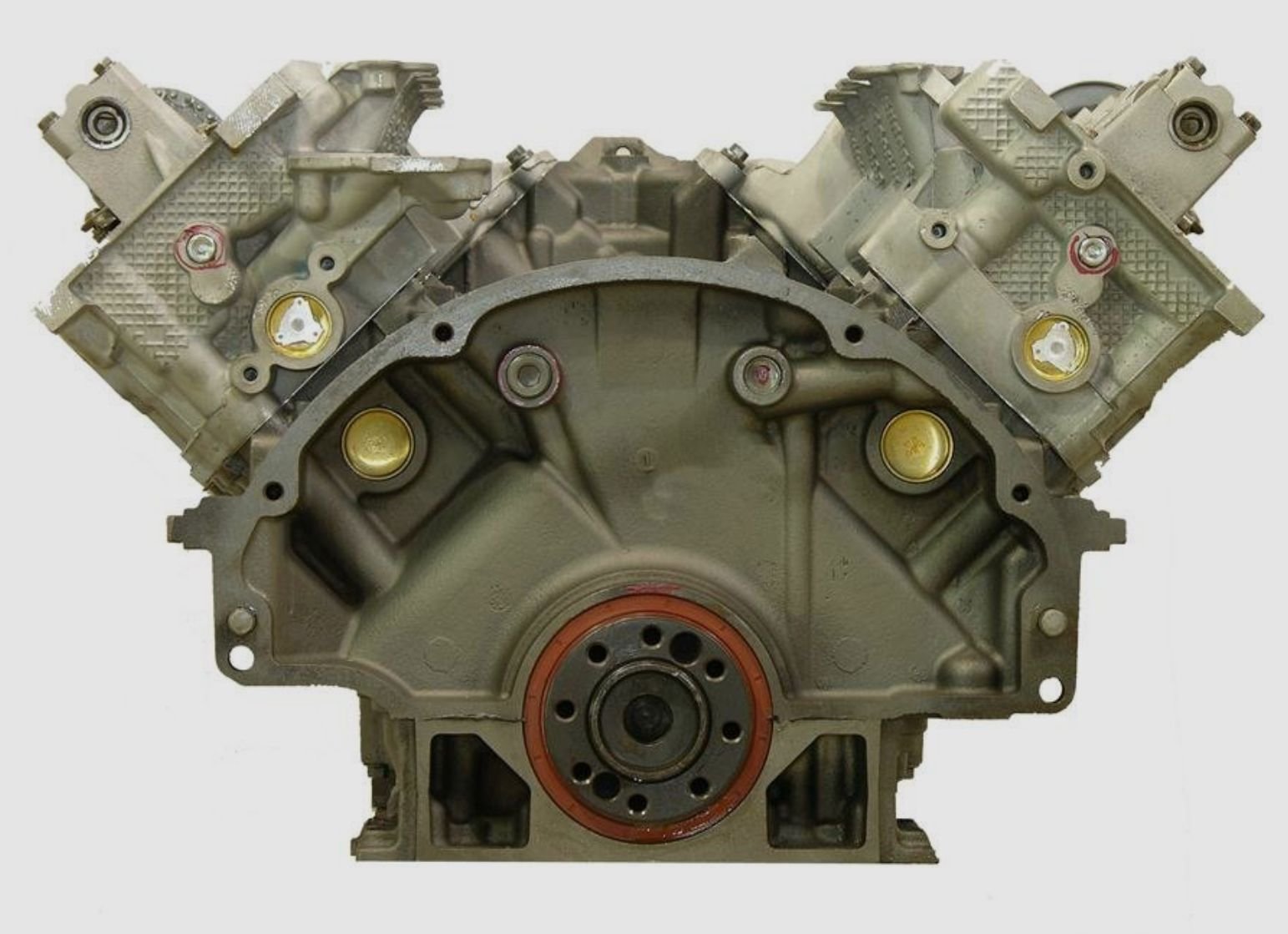

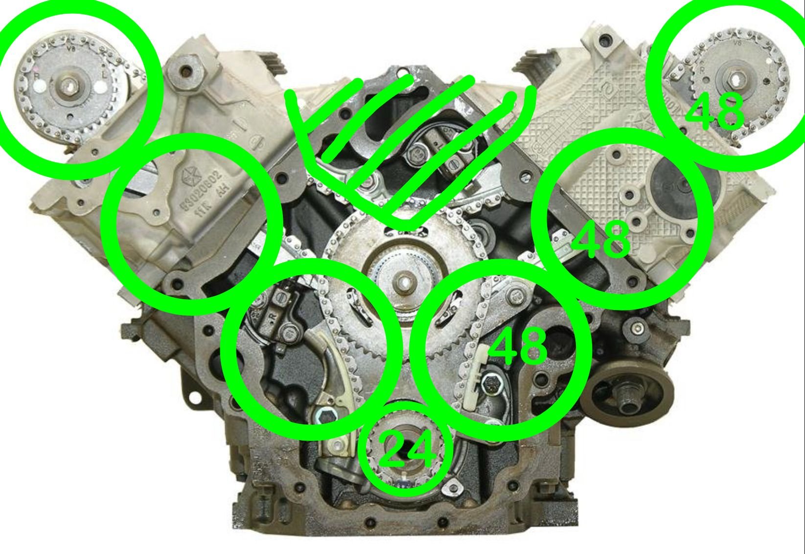

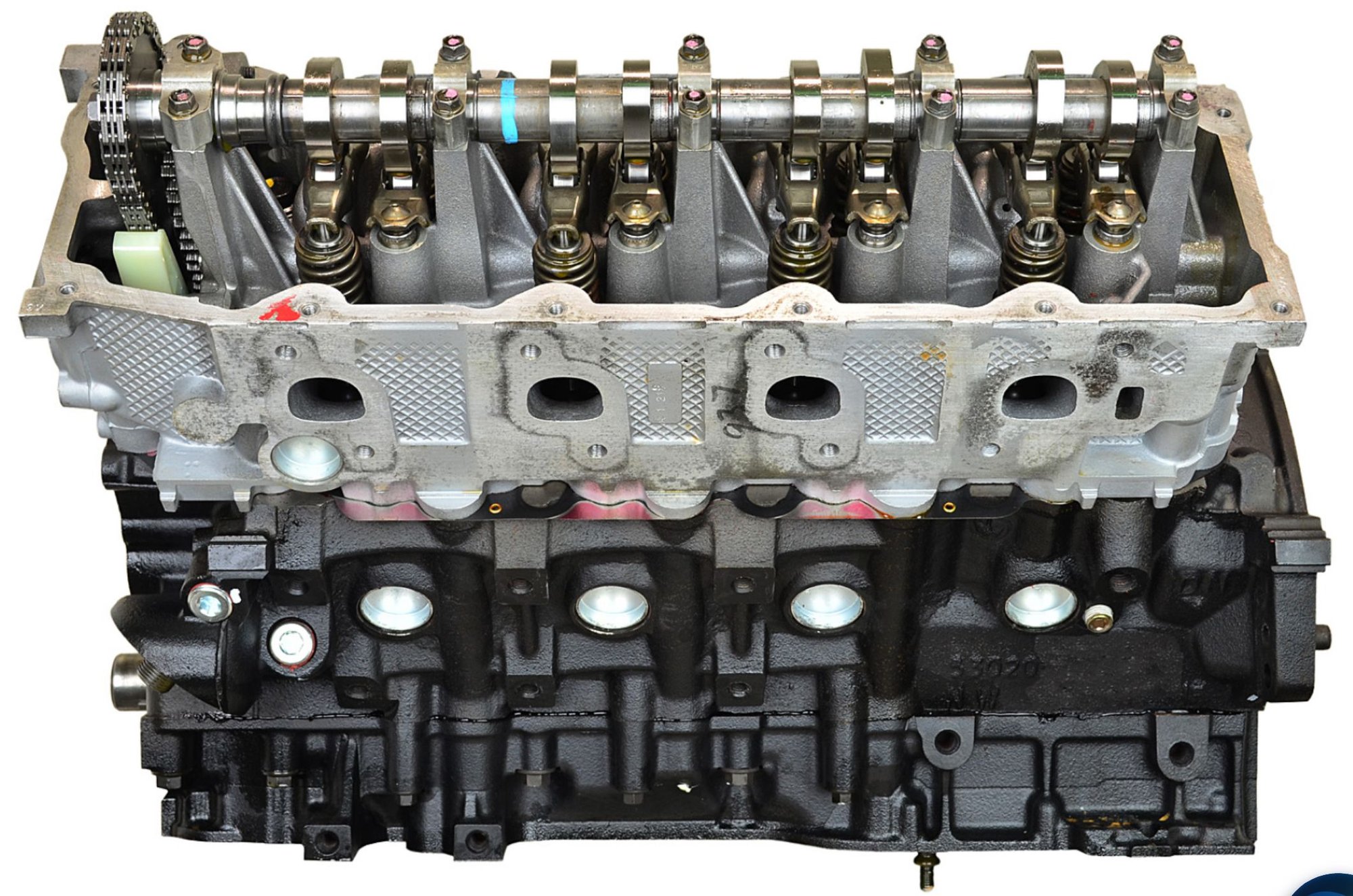

Chrysler Group 4.7 SOHC V-8 piston engine - side view
Chrysler Group 4.7 SOHC V-8 piston engine - front view
Chrysler Group 4.7 SOHC V-8 piston engine - rear view

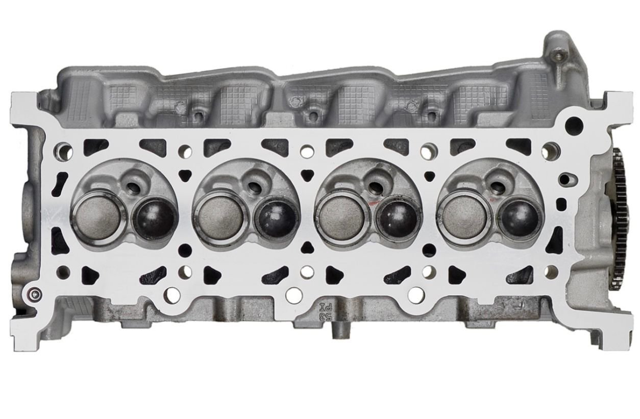

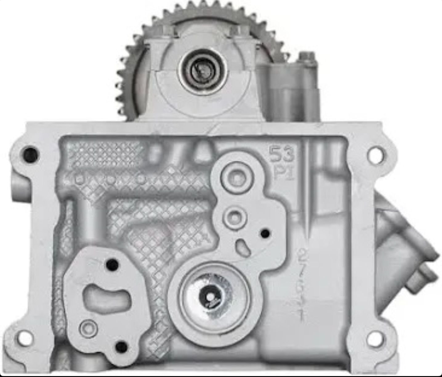

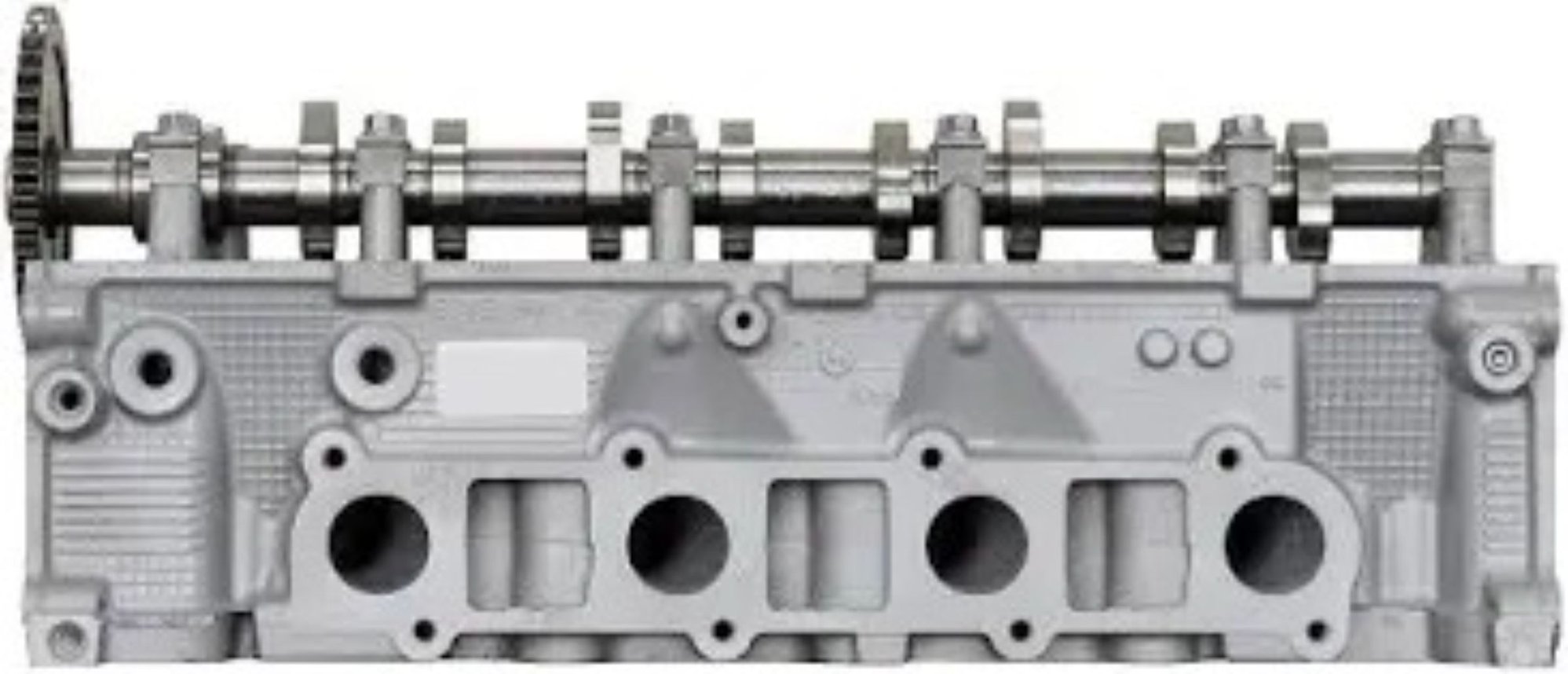

Ford 5.4 V8L “Modular” SOHC Cylinder Head - 1999-2004 - end view
Old Jan 24, 2025 | 07:14 PM
  #146
TonyWilliams's Avatar
Joined: Dec 2024
Posts: 83
Likes: 7
From: San Diego, California USA

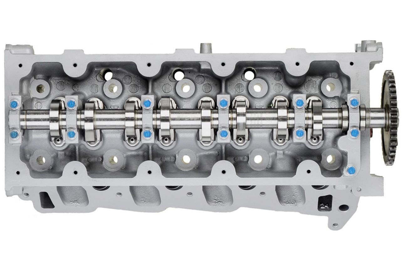

Old Jan 24, 2025 | 07:46 PM
  #147
Joined: Dec 2024
Posts: 83
Likes: 7

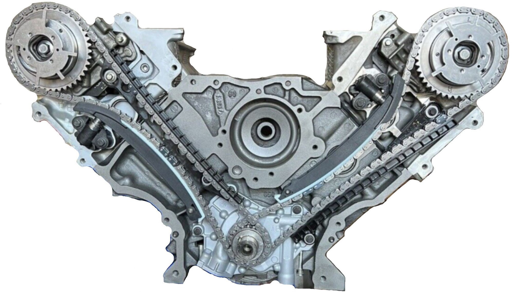

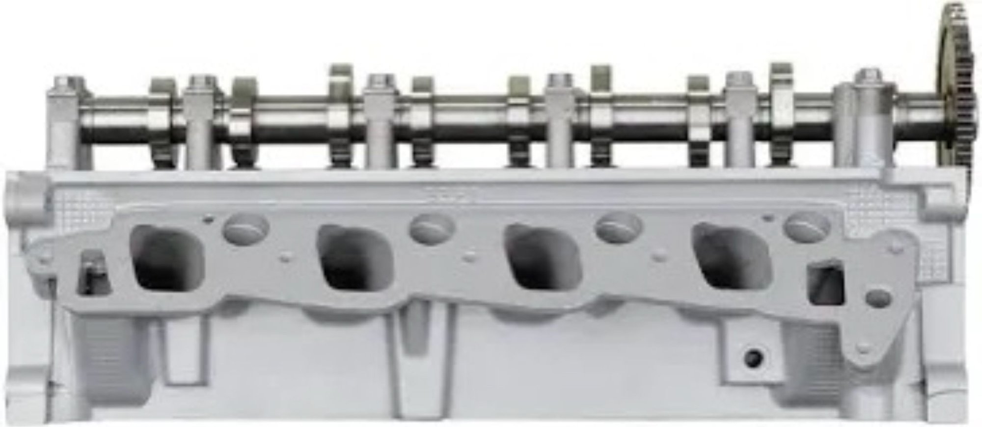

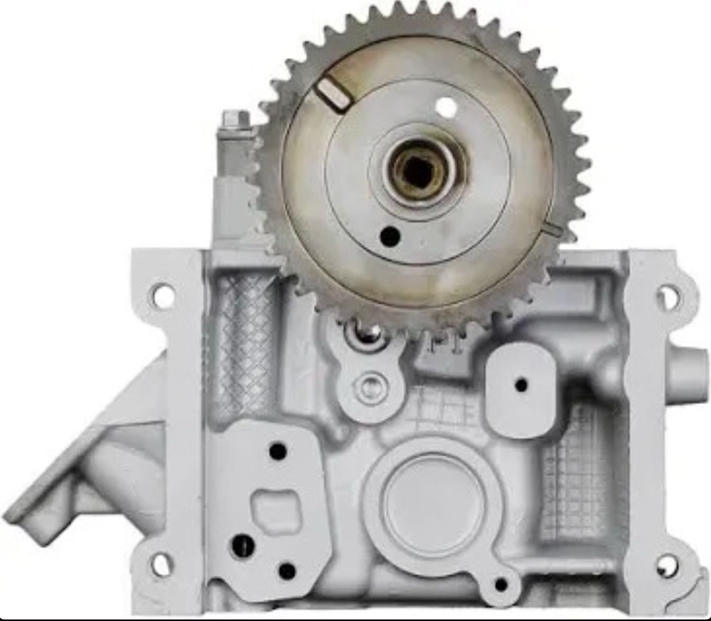

Ford 5.4 V8L “Modular” SOHC Chain Drive - 1999-2004

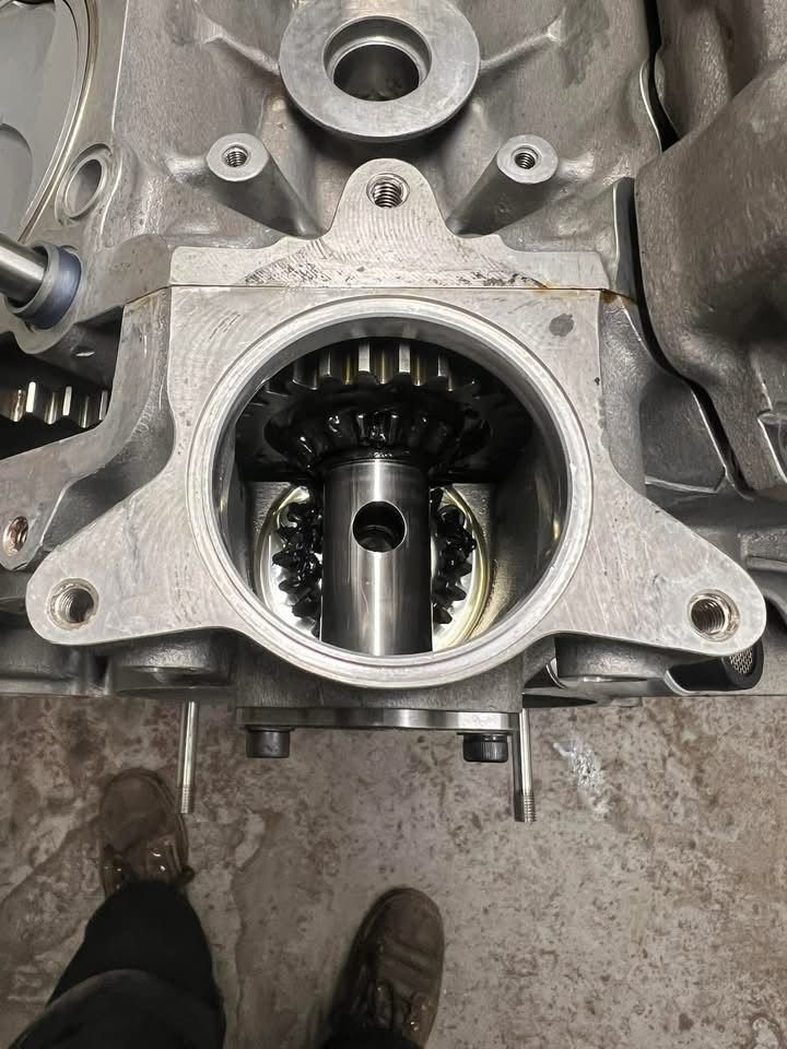

Old Jan 25, 2025 | 12:43 AM
  #150
Joined: Dec 2024
Posts: 83
Likes: 7
Old Jan 25, 2025 | 03:16 AM

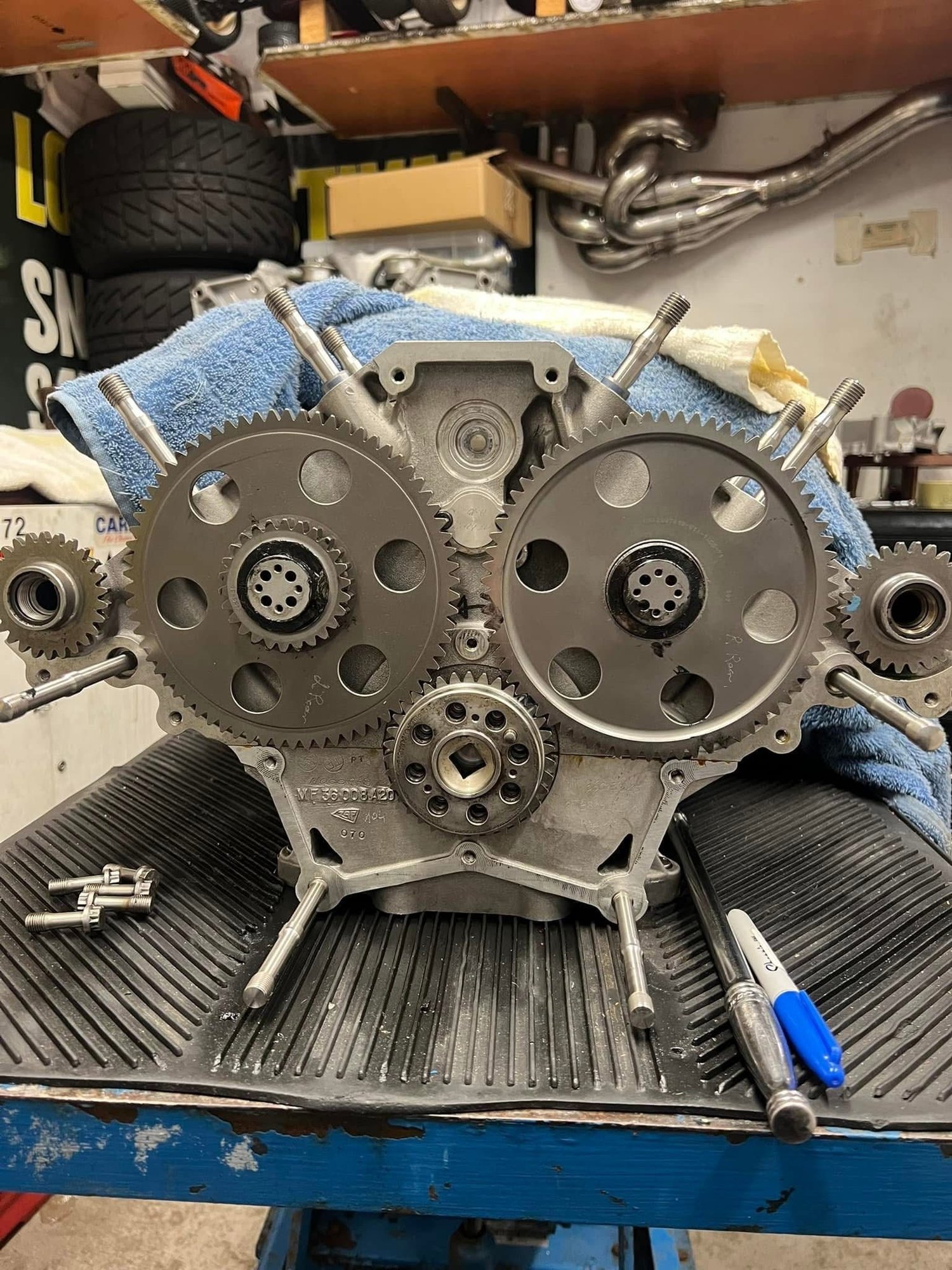

Old Jan 25, 2025 | 03:58 AM
  #153
Joined: Dec 2024
Posts: 83
Likes: 7

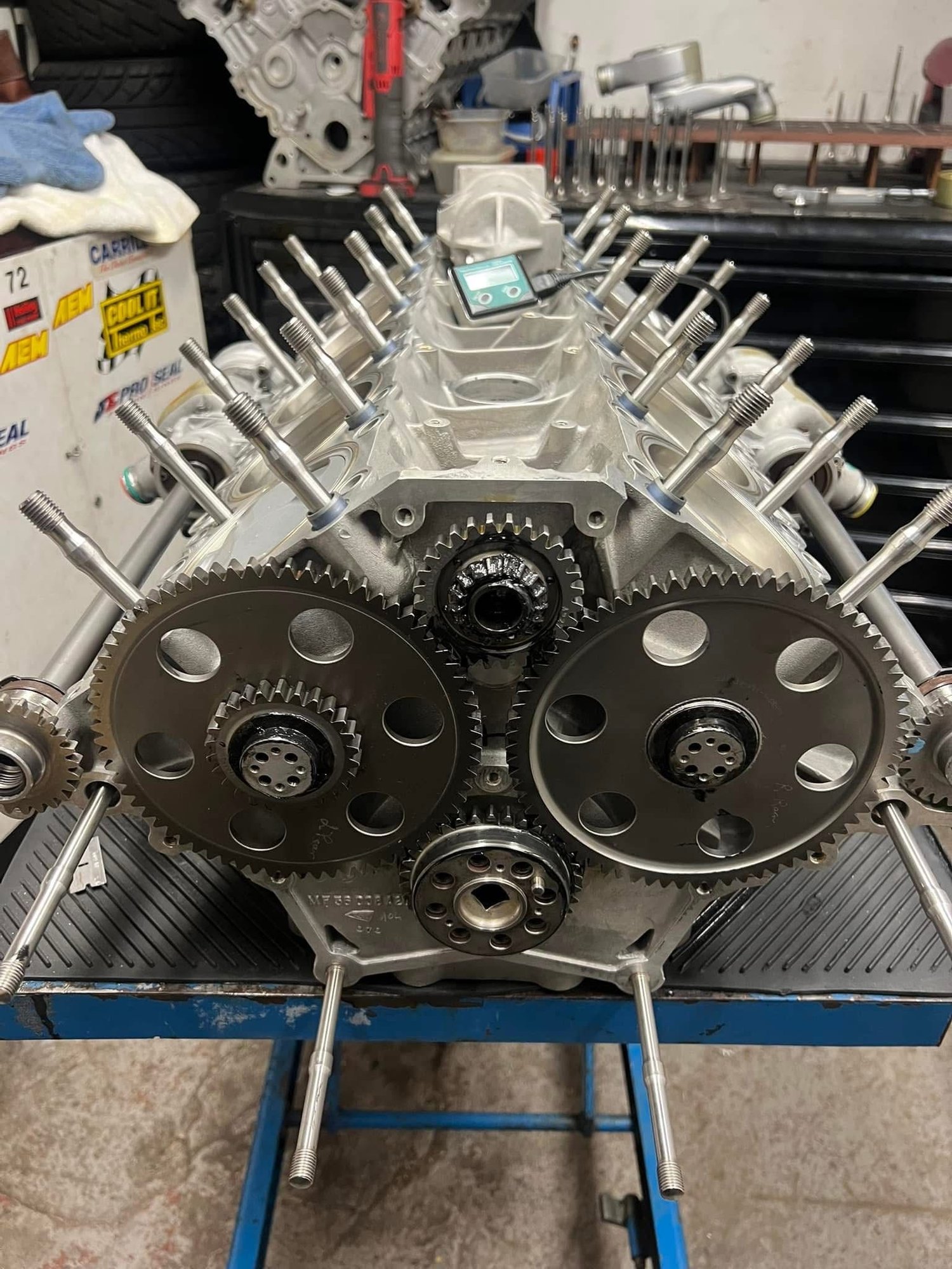

I think that it’s going to be gear driven camshafts. Here’s a concept, literally with only TWO different size gears. Now, to figure out where the starter / generator goes.

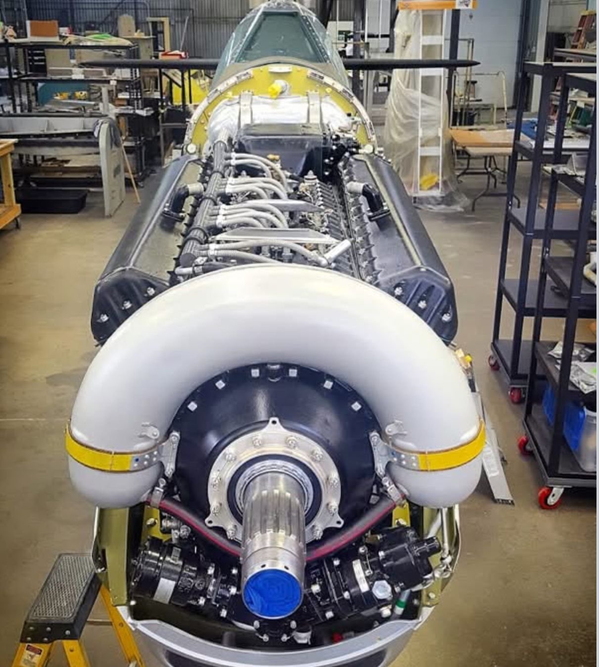

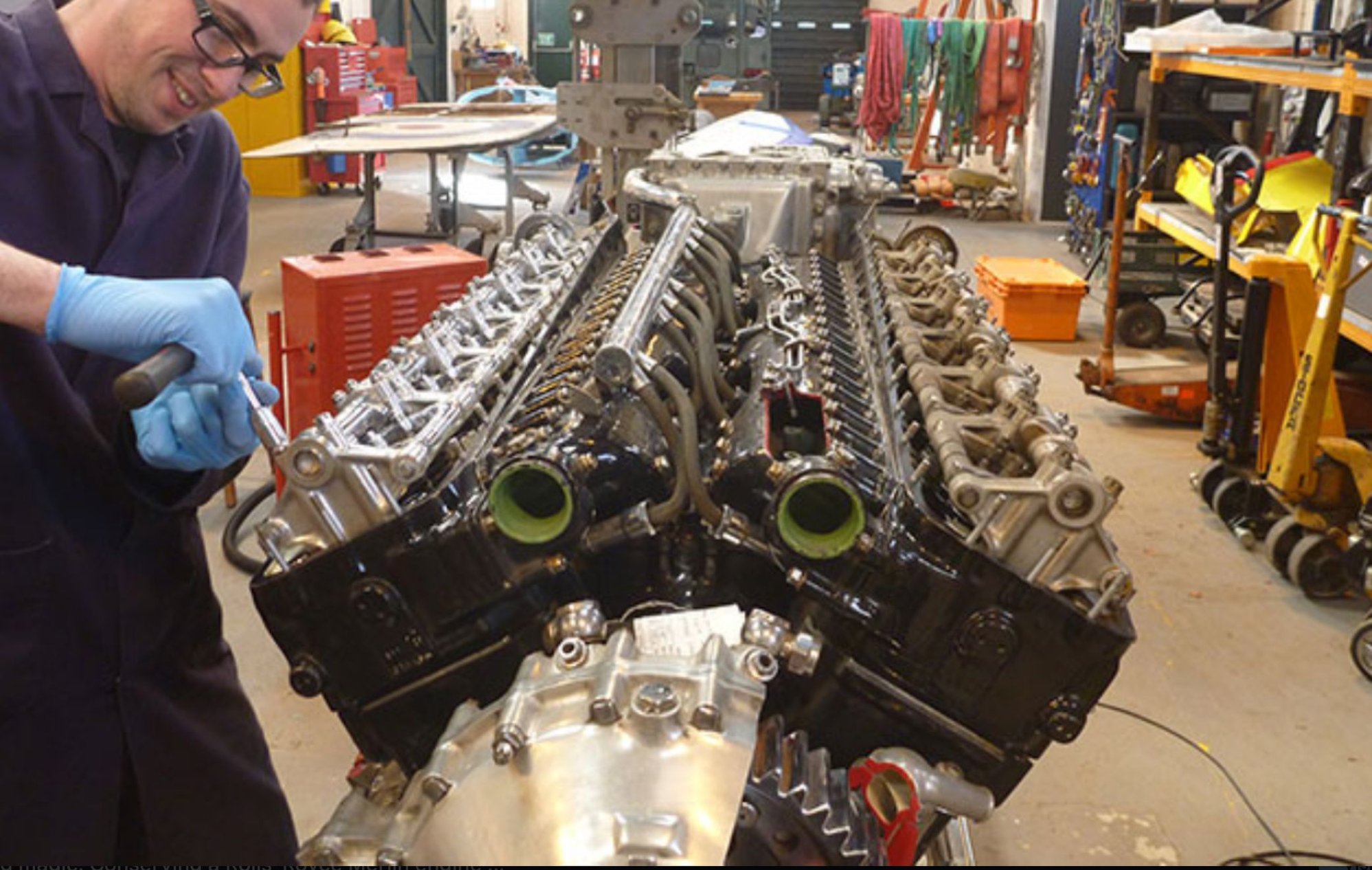

The Rolls-Royce Merlin is a 12-cylinder, piston, liquid-cooled, 60 degree V-12 aircraft engine. It was designed in 1933 and powered many aircraft in World War II.
It has SOHC and 4 valves per cylinder.
0.42:1 reduction gearbox to propeller
Takeoffs power - 1,670 hp (1,245 kW) at 3,000 rpm
War Emergency - 1,710 hp (1,275 kW) at 3,000 rpm, +18 psi boost (66” Hg MAP)
With 100/150 fuel - 1,860 hp on the P-51B airplane, with 75" hg. M.A.P
Specifications:
  • Merlin 33: 1,400 horsepower at 3,000 rpm
  • Merlin 35: 1,280 horsepower at 3,000 rpm
  • Merlin 38: 1,400 horsepower at 3,000 rpm
  • Merlin 45: 1,185 horsepower at 3,000 rpm
  • Merlin 224: 1,680 horsepower at 3,000 rpm
  • Rolls-Royce Merlin R.M. 14S.M. Mk 100 V-12 Engine: 1,645 horsepower at 3,000 rpm
  • de Havilland Hornet: Over 2,000 horsepower
  • Bore: 5.4 in (137.16 mm)
  • Stroke: 6 in (152.4 mm)
  • Displacement: 1,649 in³ (27.04 L)
  • Power-to-weight ratio: 0.96 hp/lb (1.58 kW/kg) at maximum power
  • Fuel: 100-octane gasoline
  • Cooling: Liquid-cooled
  • Supercharger: Two-stage mechanically-driven supercharger
  • Type: 12-cylinder, liquid-cooled, 60° V-type piston engine
Aircraft powered by the Merlin Hawker Hurricane, Supermarine Spitfire, North American P-51, North American F-6, and P-51 Mustang
Rolls Royce MERLIN V-12 piston engine

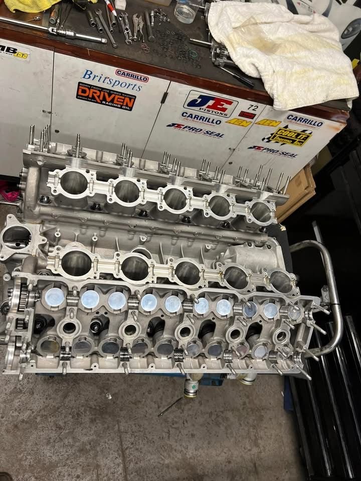

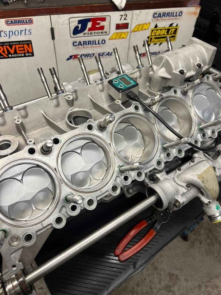

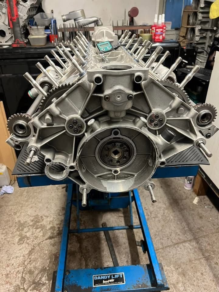

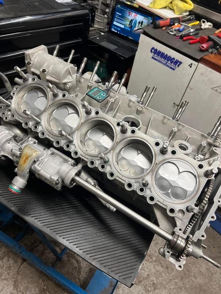

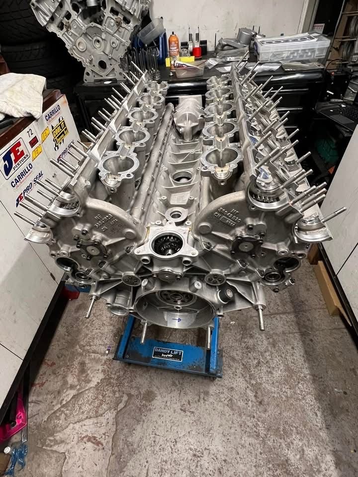

Formula 1 Jordan Peugeot 195/3
Old Jan 27, 2025 | 11:50 AM
  #159
Joined: Dec 2024
Posts: 83
Likes: 7
Old Jan 27, 2025 | 11:52 AM
  #160
Joined: Dec 2024
Posts: 83
Likes: 7
