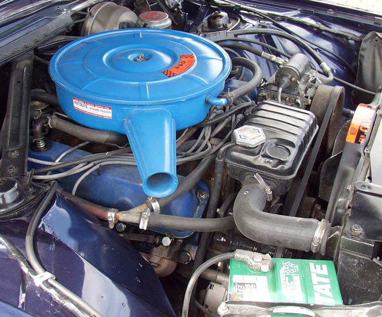

Detroit has spent money for metal on making horns on their air cleaners like the one above. As this just draws hot air from under the hood and has no ram air inlet that mates with it, they have to have some reason. Oh yes.... I belive its call Bernoulli's Principle. The horn serves no other purpose than raising the air pressure before it goes through the air filter to reduce the pressure drop across it, I would consider a .07psi increase signifigant by comparison.
After you consider how much money they could save on metal and labor making their air cleaners like the one below this must have some real bennefit. I mean they have done this for decades and these guys are so cheap that they wouldn't spend a penny to keep their mothers from being thrown out in the street. (Note to self, don't raise children to be auto execs)
Conclusion....
If detroit will spend money on getting minor gains with a horn on an air cleaner then ram air must be well worth it.
If you think your time would be better spent doing something rice like putting a leaf blower before your intake feel free to do so.

Detroit needed to use the THERMAC device on air cleaners to keep the air hot enough in cold weather to keep from freezing the carbs. They'd take hot air off the exhaust manifolds with that device (with thermal switch and vacuum control). Also that horn helps QUIET the intake noises quite a bit. It's hardly for the tuned HP increase.

not all air cleaners with air horns had THERMAC units. THERMACs mainly came out after passage of the clean air act.
Edit: Note this is a picture of a 66 t-bird air cleaner. My 63 doesn't have a horn. A 66 t-birds engine noise is no quieter than a 63 .
