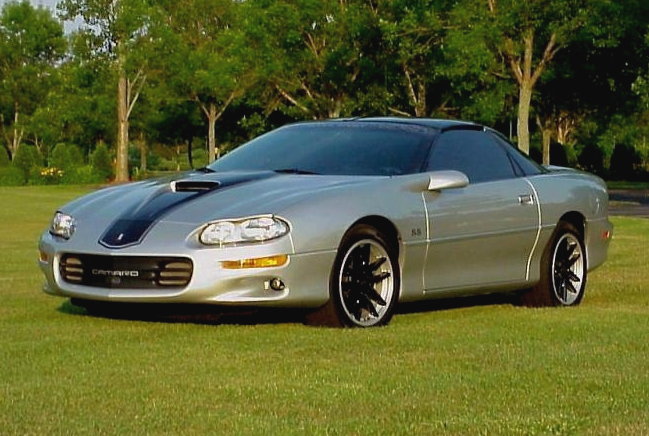

Damn KillerD, I'd have to say that is one bad *** ride! (I'm biased to the Blues ones)...tell me, are your SS badges the chrome ones from RKsport?....thats what I want on mine.....

Old Jan 15, 2003 | 08:35 PM
KillerD's Avatar
Joined: Jan 2002
Posts: 390
From: Atmore, AL
Default Re: Mesh behind stock bumper
</font><blockquote><font size="1" face="Verdana, Helvetica, sans-serif">quote:</font><hr /><font size="2" face="Verdana, Helvetica, sans-serif">Originally posted by Blu Beast:
<strong> Damn KillerD, I'd have to say that is one bad *** ride! (I'm biased to the Blues ones)...tell me, are your SS badges the chrome ones from RKsport?....thats what I want on mine..... </strong></font><hr /></blockquote><font size="2" face="Verdana, Helvetica, sans-serif">Sure is. I love em. Going to order another set for the front grill
<img src="http://images.cardomain.com/installs/266000-266999/266247_2_full.jpg" alt=" - " />
