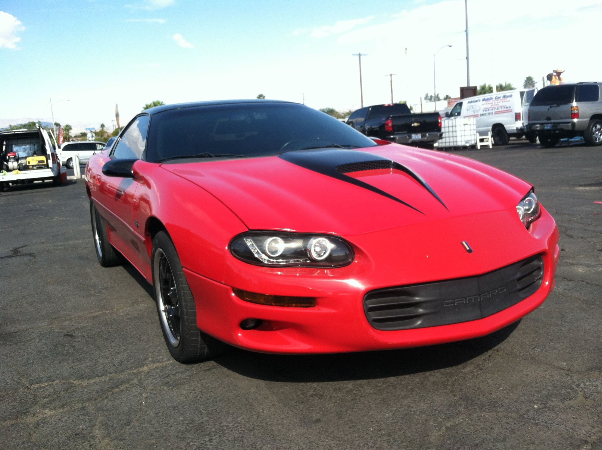

Old Apr 8, 2015 | 11:18 PM
Bamf_ss's Avatar
Joined: May 2014
Posts: 7
From: Las Vegas nv
Old Apr 9, 2015 | 06:13 PM
98z8uup's Avatar
Joined: Apr 2008
Posts: 1,111
From: Covington ,GA
Looks nice. How hard was it to do?
Old Apr 9, 2015 | 06:14 PM
jaxcam02's Avatar
Joined: Jan 2010
Posts: 1,642
Likes: 19
From: Jacksonville, Fl
That one looks like a paint
