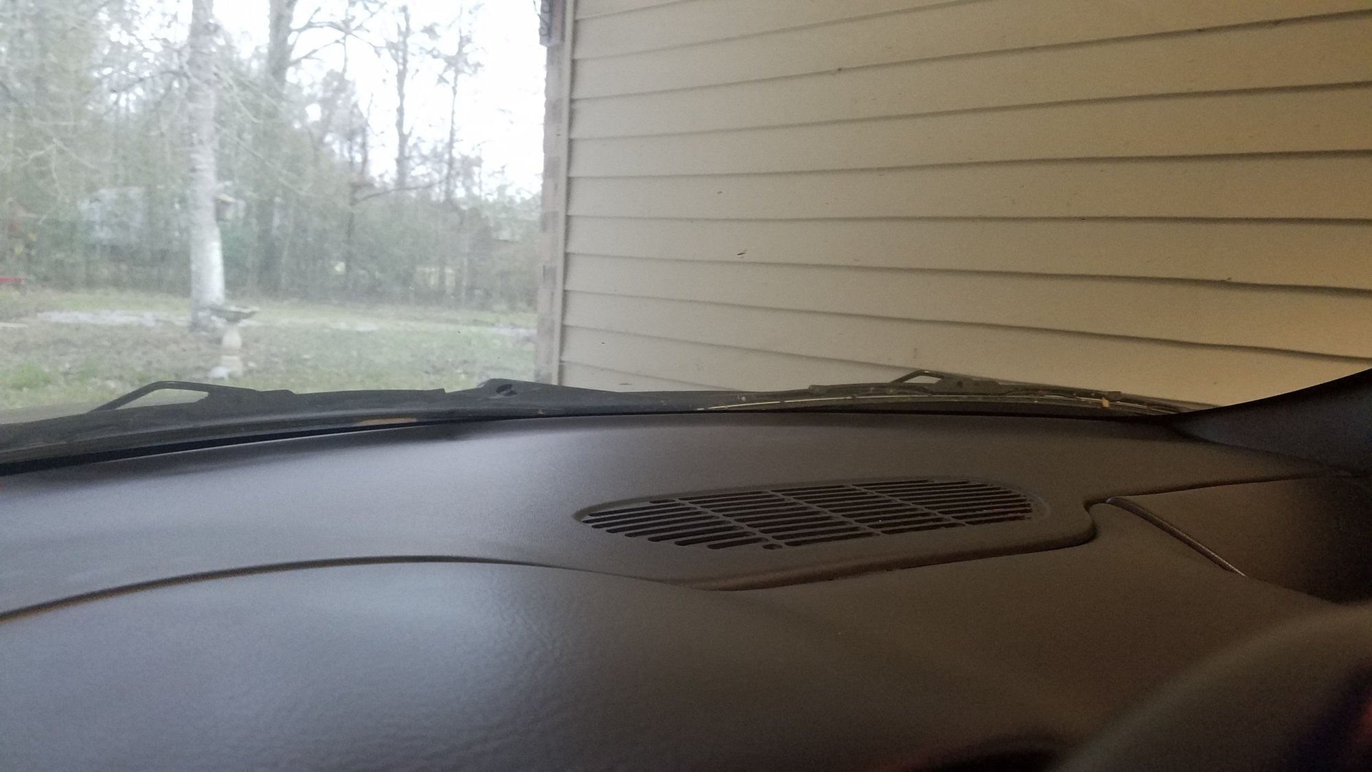

Install pics.... the front velcro strips dont come close to the stock strips to adhere... but i can live with it as long as my installed pin hold.... and they do. The velcro near the grille does not come close either. May have to figure something out in the future, but for now I am good

I'm sold. That looks great. What year is your car, and what color did you order?

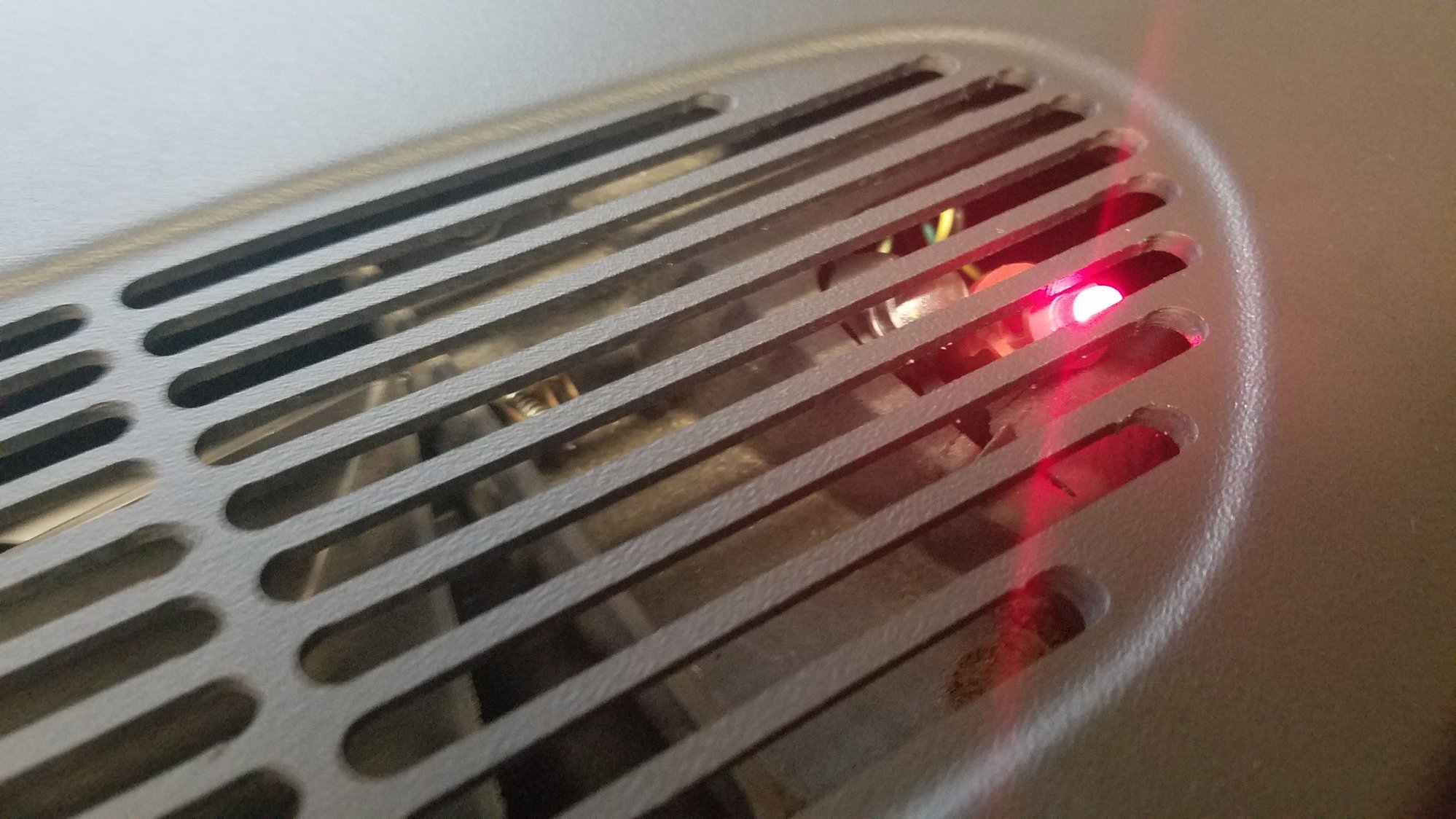

I want to thank you guys for this post! I just did this using blownbayou's pin method. I also added a pin by the defrost were factory "velcro" would be, I simply drilled a hole there and added the pin. Then I drilled a hole thru the cover that allowed just the bulb to come thru from the security light and plastic welded the base to the under side. The whole thing looks factory and I'm very picky, love it!! Thanks!!
