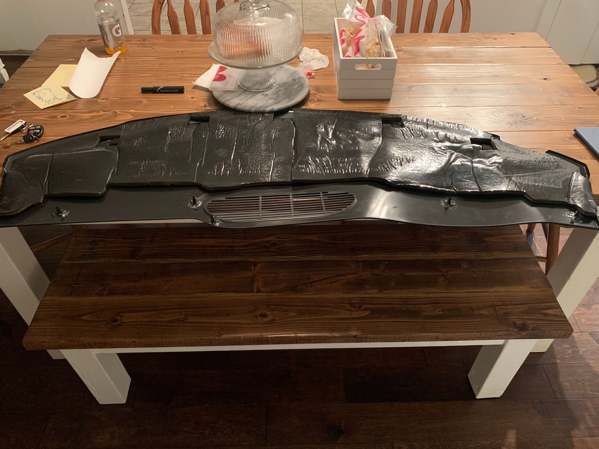

I put the clips (trees I call em) into the mounting holes just a tad.... Put a dab of silver paint from a marker on the top of each... Line up the pad and set it down.... Lift it out and you should have some nice little dots for a template.
Side Note
Make sure you add the front clips ( the two velcros in front of the vent ) to your job as well.... I put one after the fact and it helped, but the not having one in the other spot has my pad popping up due to heat I guess. Will be fitting another tab onto that one to lock it down in that spot

Well, that turned out much better than expected. I used the plastic weld to adhere the push tabs and the final fit & finish is awesome. Plastic weld is very strong too. I added two push tabs in front of the vent and it worked beautifully. Lastly, I was able to reuse the twist lock chassis to mount the photocell and security light.

Update: My push tabs must have not been aligned well. The dash pad has become wavy in a few spots. Mostly at the defrost vent location and at the passenger side airbag area. I'll upload pics. I think I am going to either order a new one and use the factory velcro or see if i can find a genuine replacement. Ugh.
