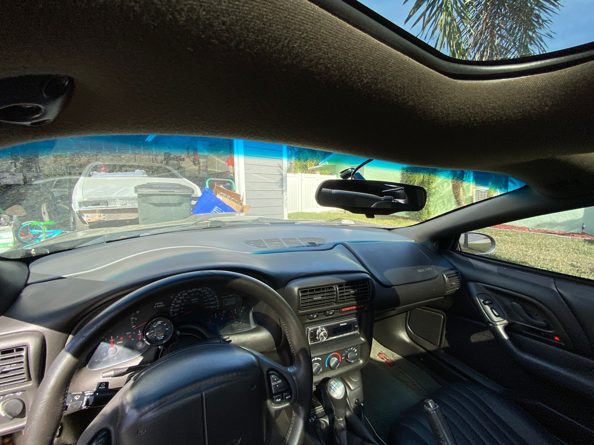

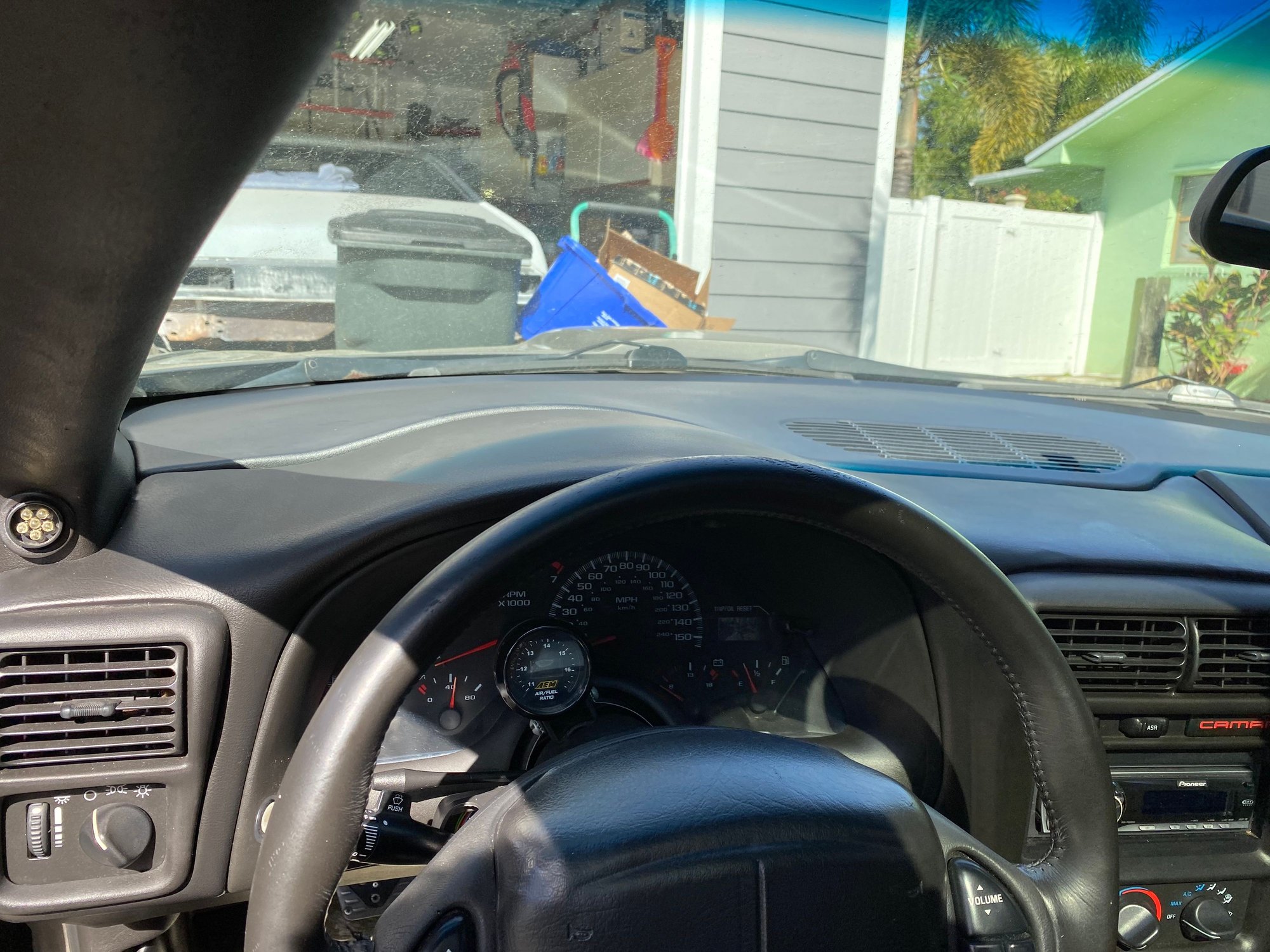

Got mine installed, Ordered the Black color, $90 shipped, great packaging. The material is a nice flexible rubberized plastic. I did have to trim mine a little bit due to a previous windshield replacement but was able to easily trim with some shears. I did the method above with the fir tree clips but the plastic weld would not stick, they popped of immediately. Then I tried the "goop" stuff that came with the skin and the popped off also. I ended up using gorrilla super glue gel for the tree clips.
For the money and the fitment you cannot beat this dash pad. Id recommend it if anyone is on the fence.
