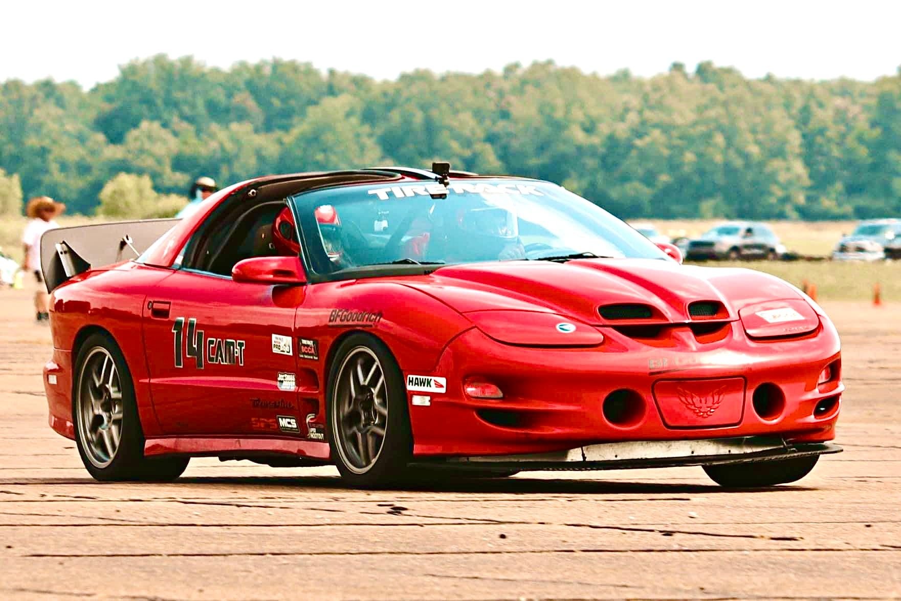

If it is all for looks, why bother with CF, if you are serious about downforce, none of the options out there are functional.
I run up and over 160mph on track and our cars get really unstable above 140mph so I ended up designing my own. Lots asked if I would build them, but it would cast me upwards of $1600 or more with no profit or shipping. I have a good job so I am not going to **** time away on it. I might upgrade mine to CF, currently an aluminum plastic laminate. Just pointing out these plastic cutouts are in no way a functional splitter, especially if you notice near the wheel well they sit 4 inches lower that the front edge, they should be flat to the ground or slightly lower in the front. The lower chin spoiler is gone and now smooth, all cooling air goes in below the lic plate, the visible opening, and to make it more effective I have added vents on the hood so the air goes over the car. Plus no one hole drilled in the bumper cover, all mount goes back to the bumper mounts on the frame.
