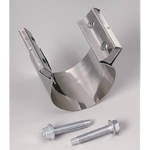

I guess I will have to try it and if it wont come down than I will have to cut it. Where would be the best spot to cut the ory. I don't wanna cut close to the headers cuz that makes me nervous lol
Old Dec 22, 2010 | 07:38 PM
Jays_SSZ28's Avatar
Joined: Aug 2009
Posts: 2,223
Likes: 56
I'd cut it nice and square and use butt type (not overlapping) band clamps to put it back together.
I have three of these on my Y and can drop the whole thing out.
