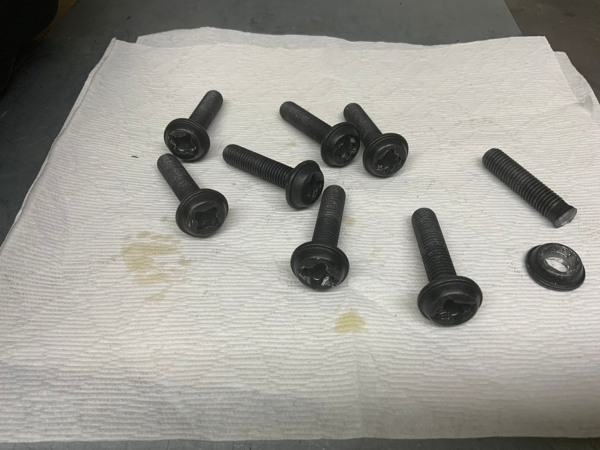

Old post but I need one of these bellhousing bolts that I had to drill the head off to get the BH off.
I do have a set of 4 of these mortorq bits. They are MTS-0 to -4. The -4 fits the 4l65e bolts.
Anybody know the p/n for this bolt? All I can find on eBay or Amazon are torx or hex head bolts.
I want the same as I took out, not a torx or hex head.

I have used just a plan old bold in replace of those bolts with no issues. Just make sure that they clear the torque converter.
