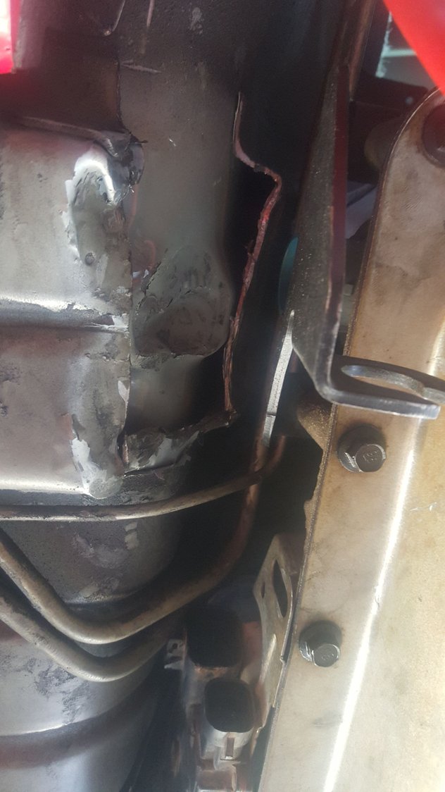

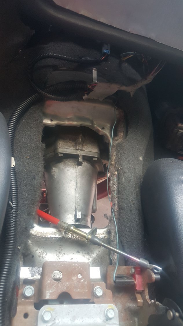

Here are some pics i took for you today this is how its been sitting since september cant wait to drive it away. D/S is getting shortened this week.

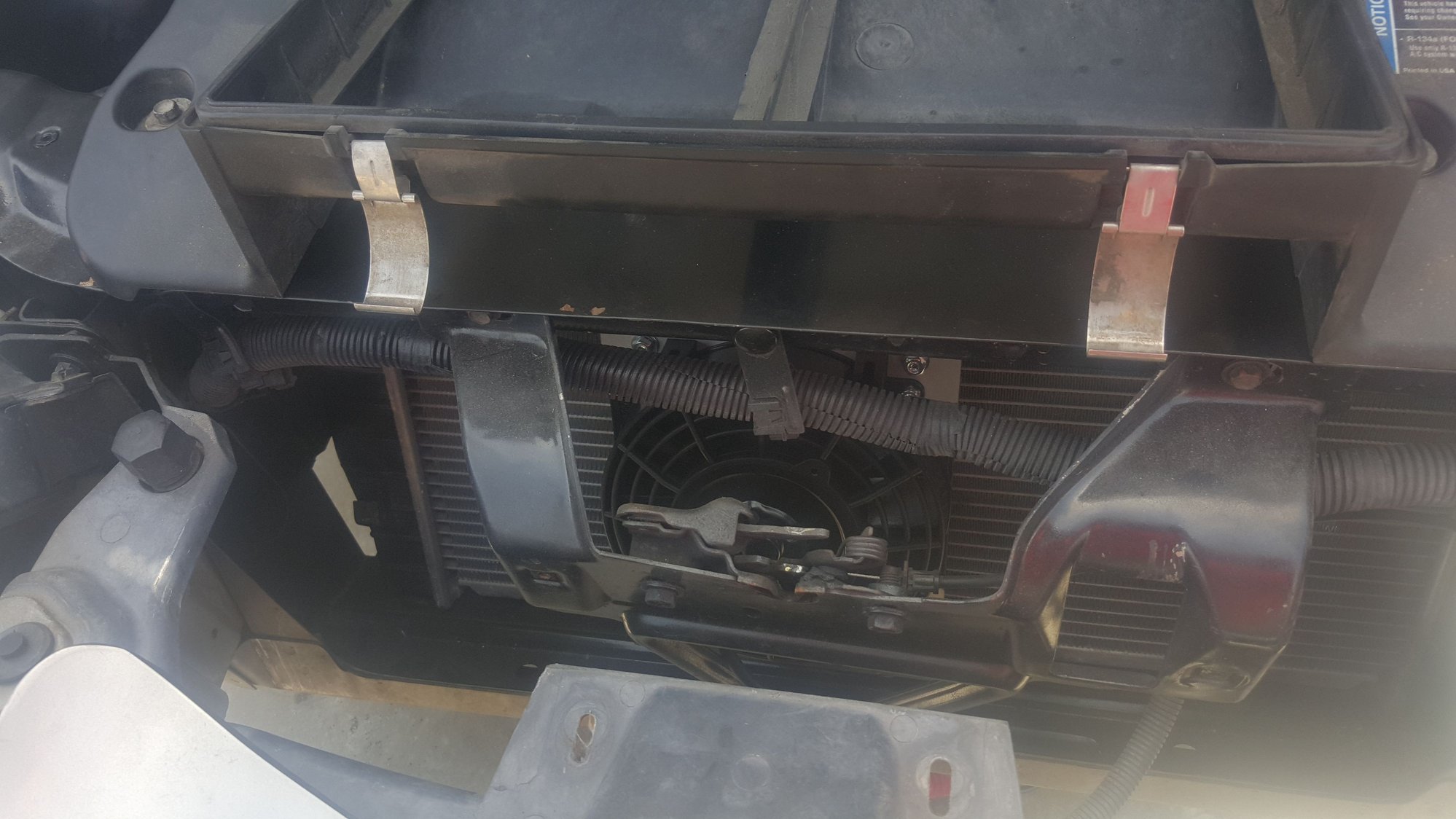

This is were my trans cooler will be

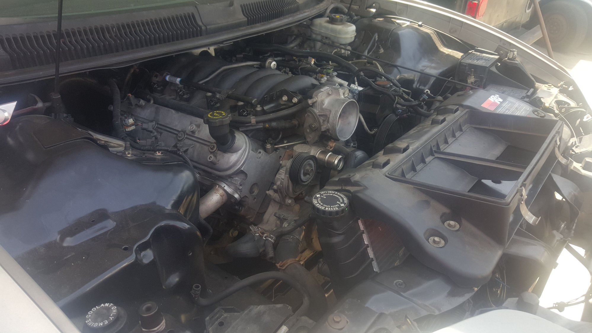

As you know i didnt just do the tranny swap. I also built up this lq4 so im excited to start that also.

Awesome man farther along than I am. That part that you cut out, what was that to clearance? Its hard to tell in the pic what that room is needed for. I know from researching that cutting will be necessary and in that spot but I'm not 100% sure on why.
I honestly did it before the trans went in thinking that i would need to. I dont i needed to do it. I assume some peoples set up might turn out a little different than others

I'll add what I had to do for my 4l80e swap:
In regards to clearancing for the harness plug, I took an air hammer and went to town on the area where the plug would hit. It dented in the metal just enough so that the plug would fit and no cutting was needed.

Ill check it out again for you, i cant really remember what was hitting what right now. I can tell you as stated above, the plug were the harness plugs in to at the gear selector did hit some lines but with a little bit of finagling it can squeeze in there i just have to plug my harness up to it now. This weekend it will need to be tuned so i can start it hopefully and then i just have to wait for my D/S to come back.

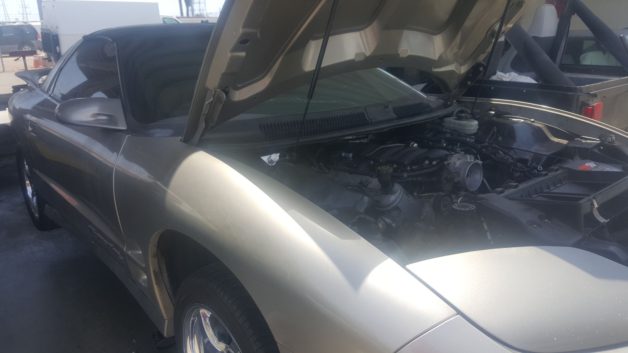

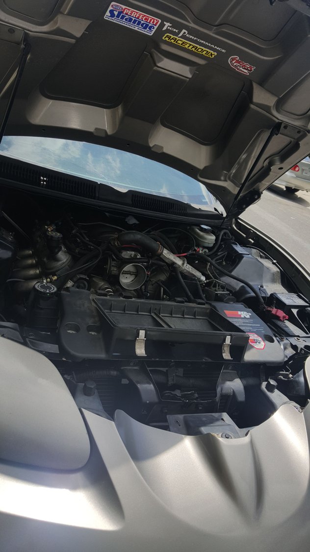

Here are some pics for you my buddy and I have been busting *** on it all weekend and i hope to have a firsr start video later on today for you.

Very nice man love the Tahoe too lol I've always been a fan of those. Nothing really new to report on my side. Nearing completion of parts collecting for this and my huron speed v2 twin kit. Just some hose & fittings and a griffin radiator, 00 or better gauge wire for the battery relo, and I believe I'm done with parts. Thanks to a fellow forum member I might also be looking to pick up an AC relocation bracket along with an alternator relocation bracket to mount both of those up on the heads to make room for the turbo kit.

Thanks man. So first things first before i forget. The reason for denting in the side of the tunnel is for the plug on the trans. Luckily everything was very close for me so i didnt have to deal with that yesterday. But when you do yours i would make sure you make quite a big dent. Engine is all hooked up now so now only have to hook up lines on tranny, shifter, and drill a hole for the trans temp gauge. Once thats done we can start it.

Yes as far as i know the stock cable works people have used stock shifters before. I cant remember if i just picked up a t56 one or a 4l80e one, they are both pretty much the same i think, definetly dont go easy on the trans tunnel, dent that sucker in big time. I had to constantly drop my trans to get to the plugs.
