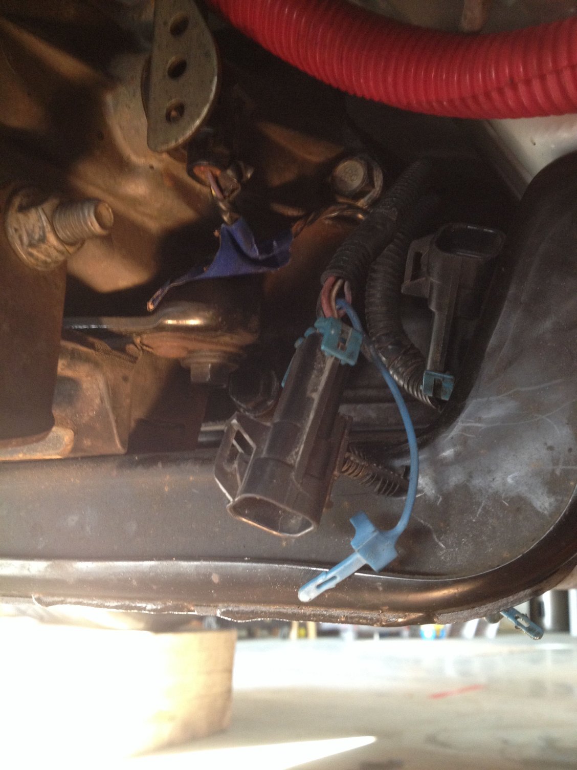

One last question:
Crawled under car to swap the solenoids tonight. Found a 4 pin female connector on the the passenger side tail on the transmission that the guy who repinned the computer didn't plug up. Can't find a connector for it though..
lol, Where the hell does it go?

Here is a pic of the connectors. This is what's so odd about it. It looks like they should plug right in but both connectors are 4 pin female??
