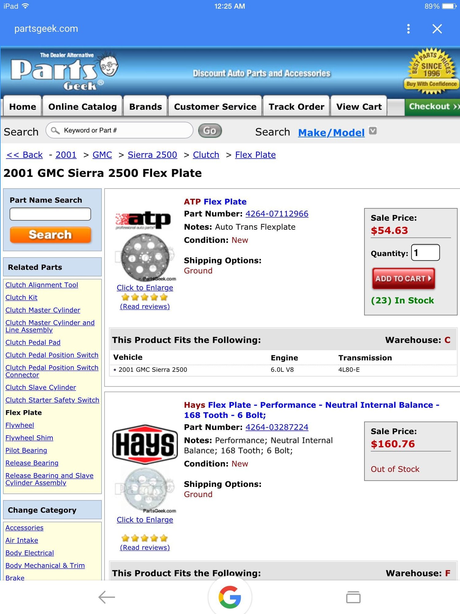

tried to bolt the torque converter to the flywheel but there a big space from the center hub. the flywheel its self only has three holes for the torque converter. is it possible to just drill out the other holes for the torque converter and get a spacer for the hub or just buy a new flywheel? what has other guys done to solve this situation. any part numbers would be great thanks.

Go to bone yard or order new flexplate . 02 gmc hd 2500 with a 6.0 should work fine

Old Sep 11, 2015 | 01:06 PM
916montels's Avatar
Joined: May 2012
Posts: 61
