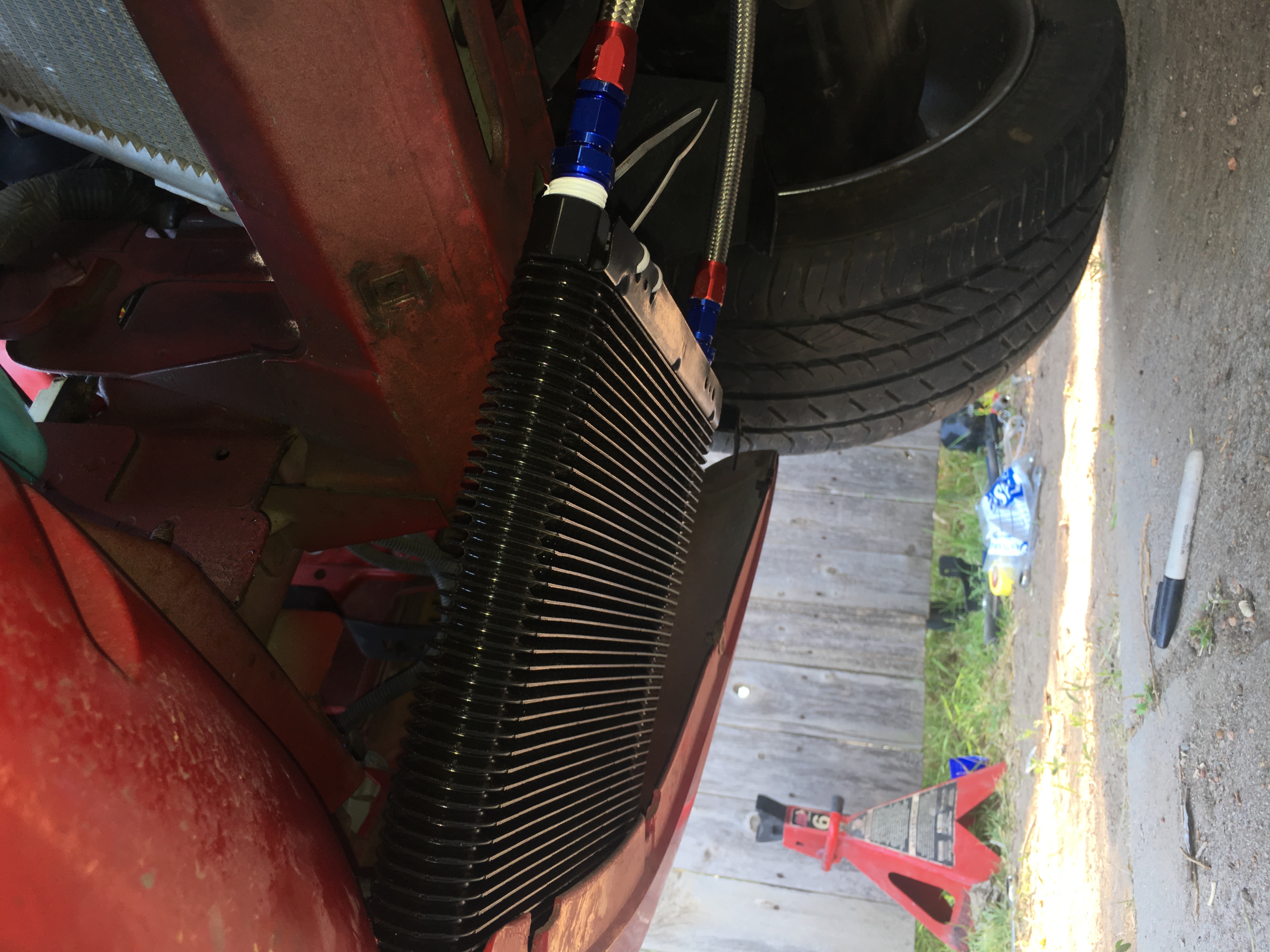

I just did stall and cooler about 3 weeks ago. I have the Tru cool h7b which is the same size as the b&m but it was only $70. I have the deeper truck pan, braided ss lines and mounted the cooler dope style on the passenger side bumper area. I have an autometer trans temp gauge and single pod like you were looking to get, I have the sensor threaded in the test port on the case which reads 15-20 degrees hotter then in the pan from what I've read.
With my circle d 4500 stall, i cruised around town for about 2.5 hours, my gauge never showed over 190 degrees and the converter was unlocked the whole time. Usually it was sitting at 180, the only time it got to the 190 was when I did a little pull. Also using my stock flex plate.
