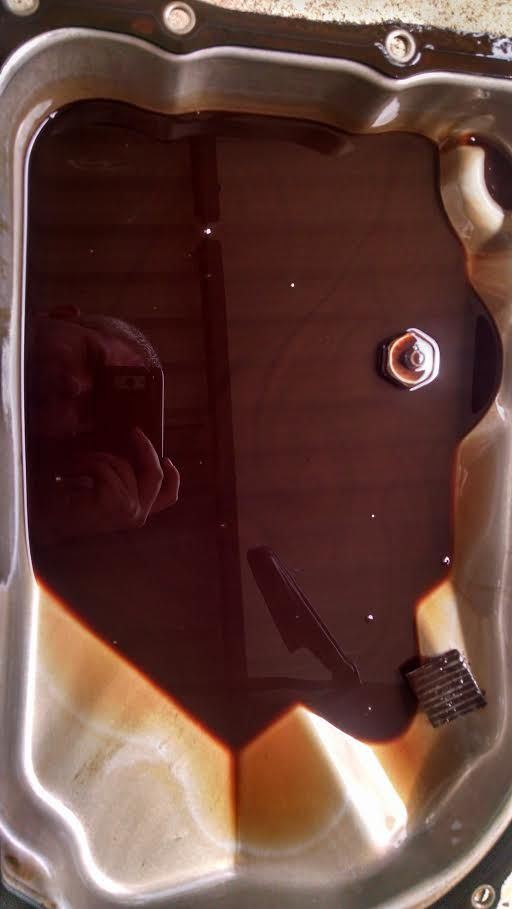

After getting it home today, I pulled the supply line off the transmission cooler and started the engine, to check for fluid flow. It sprayed all over the place, so the pump seems to be working (possibly intermittently?). I dropped the pan, and found no chunks or metal shavings. The fluid still has a red tinge to it, not that black at all. It does not smell burnt.
Some of the fluid left in the pan. Doesn't look bad at all.

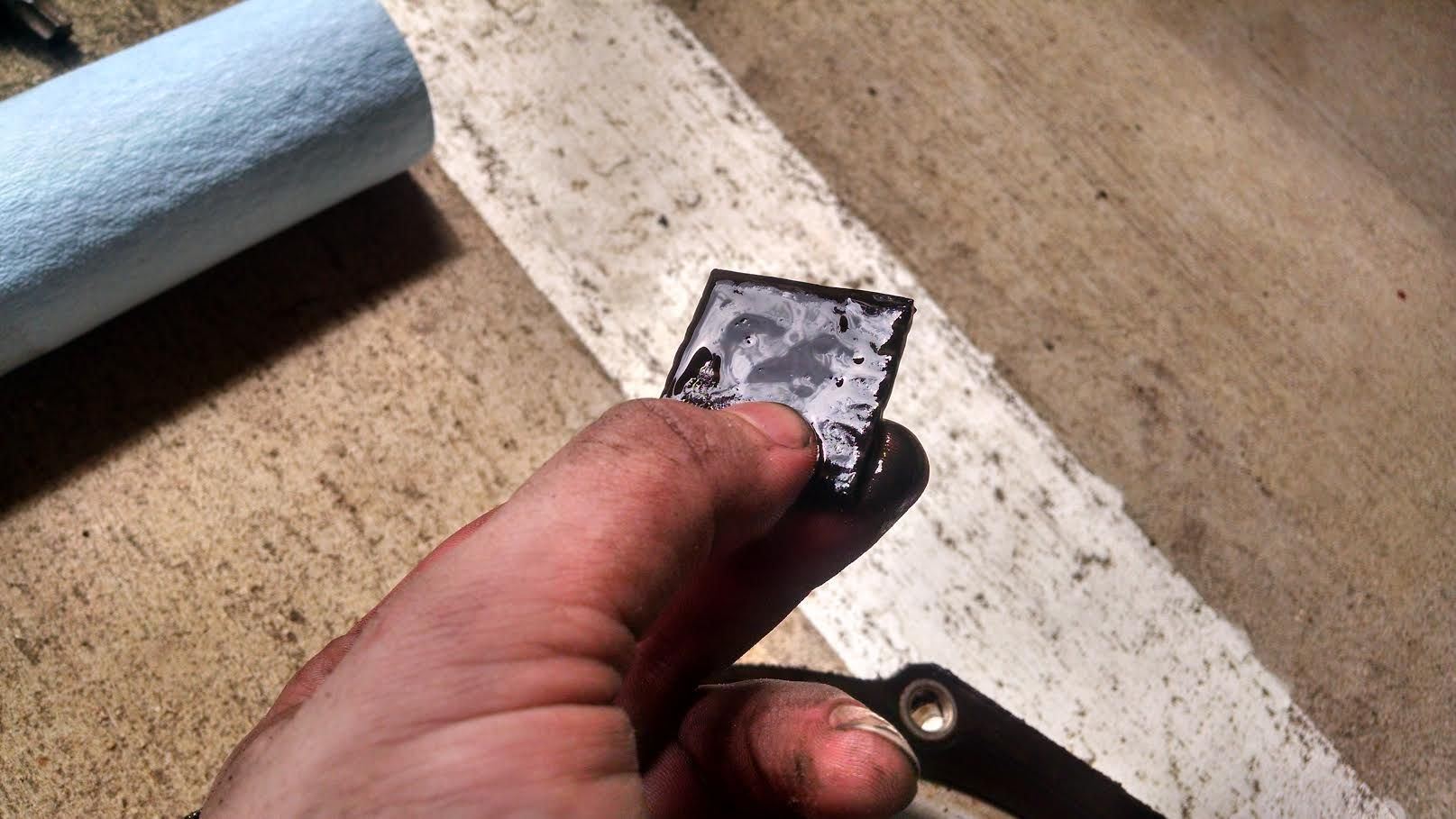

The magnet was attached to the filter near the pickup hole. It has no metal shavings on it, only a thin layer of sludge that wiped off easily enough.

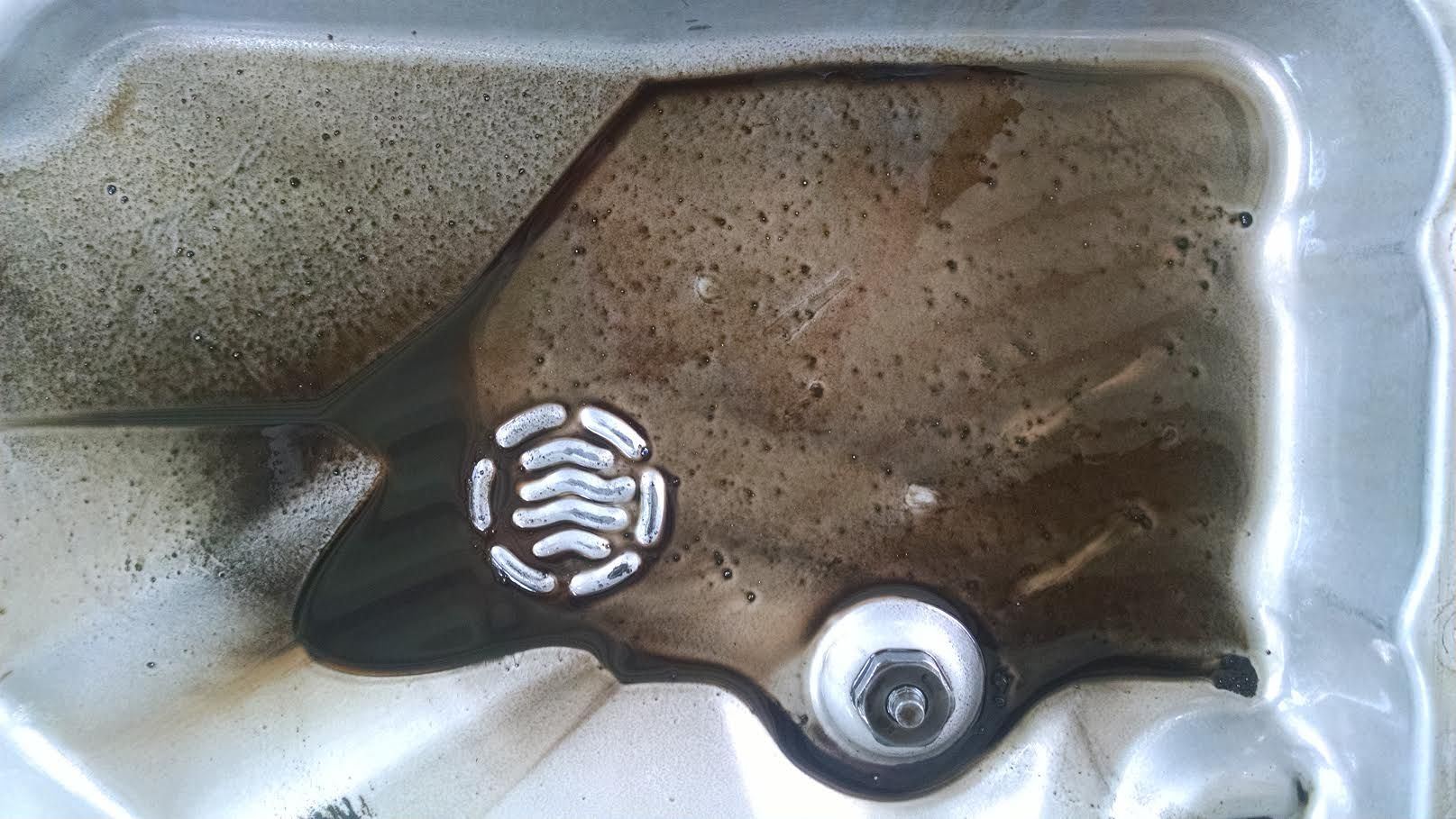

Pan drained completely. The dots are just debris, doesn't look like anything sinister.

Based on your pics, it looks like your clutches are gone. The black stuff in the pan is what is left of your clutches. I’m afraid it is time for a rebuild.

That doesn't seem consistent with all gears, including Reverse being lost at once.
Despite your test, I'm thinking a pump problem or major constriction.

We have seen the clutch debris clog the filter and cause a no movement situation. I think it's time as well.

Yes what Circle-D_Brian said. The clutch debris clog up the filter and when you shut it off some of this debris will drain out of the filter. When you start it up and try it again it will only work for a very short time before the clutch debris clogs up the filter again. Changing filter and fluid now I feel would be a waste of money and time, that is a lot of clutch debris in that pan.
