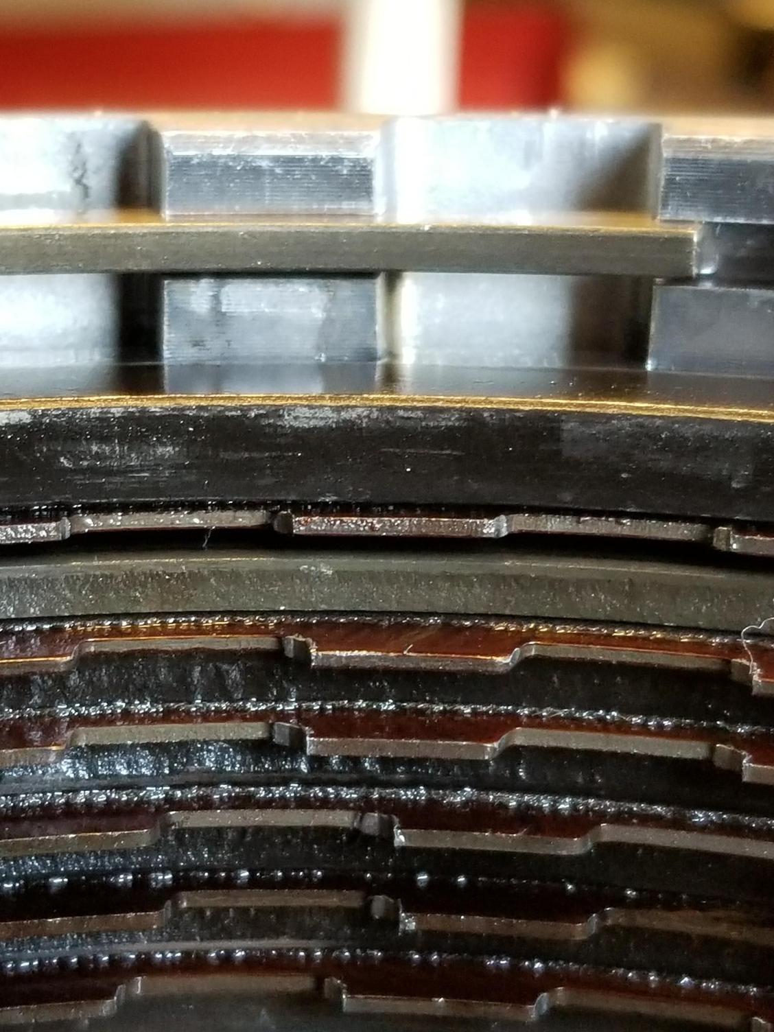

The 3-4 clutch pack along with the backing and apply plates are coned pretty bad. The kit I have came with hi-energy raybestos frictions and new steels. Tonight I purchased Sonnax backing/apply plate kit 74140-01k. I hope it helps the 3-4 stay flat. I think there are 7 frictions and the steels are .095" thick. I also received the new AcDelco reverse drum today.
Does anyone have any experience with the Sonnax backing/apply plates?

Here is a couple pics of the disassembled trans. 3-4 clutch was burned up and coned really bad. The reverse input drum has some wear marks... no. It really looks like someone took a grinder to it. There are marks in the metal running different direction from the band wear!
3-4 clutch pack was burned and coned pretty bad

Wow, I see the .170" end play on the 3/4 clutch.
Curious, how many frictions were in it - 6 or 7?
I suspect the Sonnax Apply/Backing plates are just the thickest GM ones and that will reduce the coning.

It was built up with 6 frictions. Sonnax claims their apply and backing plates are stronger...I hope so because I spent quite a bit more on the Sonnax plates than I could have purchased heavy duty OEM plates!

Thanks for the info on the Sonnax apply and backing plates.
6 frictions for ridiculous for anything claiming to be a performance rebuild.
Are you installing the Sonnax boost valve?
