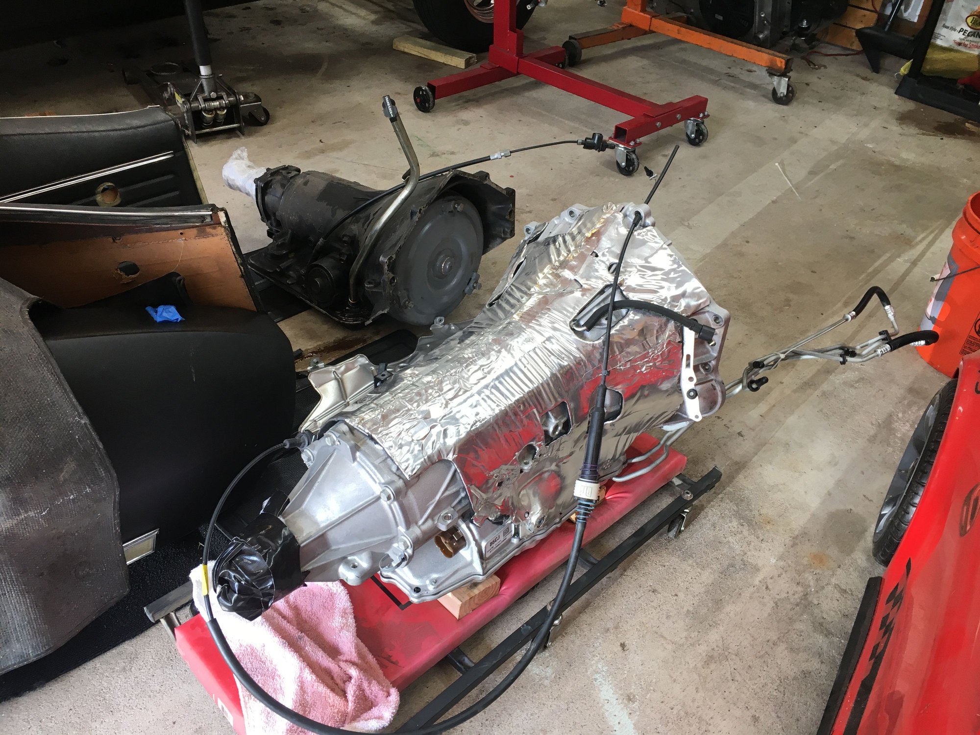

Its massive. Heres a picture of mine near my 700r4. Its roughly an inch longer and 3" taller in the center. Defanently wider and taller across the center of the trans. not a very good picture but you get the idea.

Thanks for the feedback guys, what as suggested I will start digging up the dimensions for the 6l80 and go off that. Maybe that I send up with a tr6060 , be a bit gutted if I have to though.
