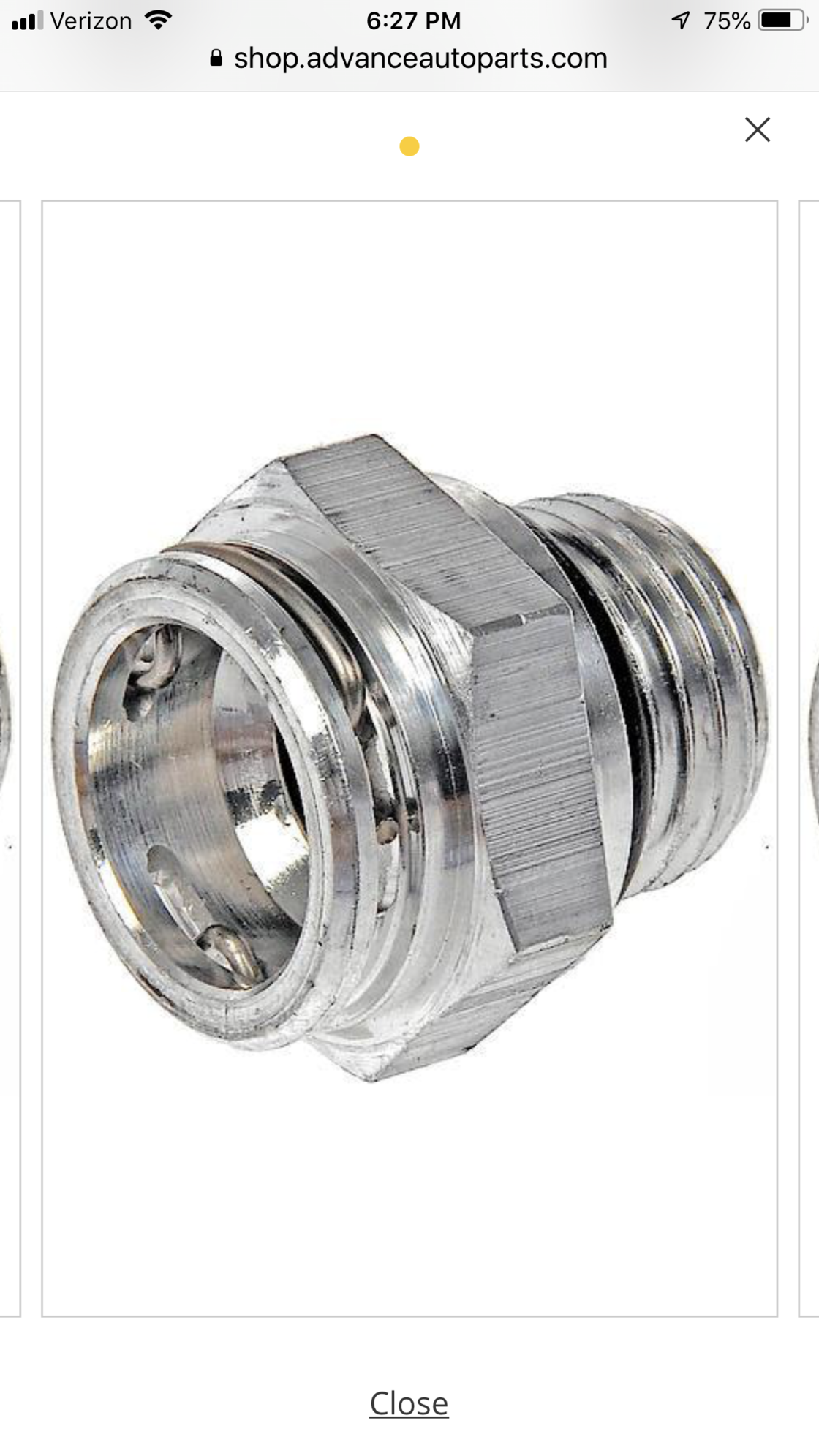

I have roughly 270 miles on my 68 Camaro after getting it running last November. On Saturday I was driving down the road casually and went to lightly accelerate and I heard a loud clank and suddenly smoke was pouring out from under my car. When we got the car back to my garage and got it up in the air we immediately saw what the problem was. One of the trans lines that fit into the Quick Connect Dorman trans fitting blew itself right out of the fitting. Has anyone else here ever seen this? I was told these fittings are pretty robust and the only way to get the line out is to pop the C-clip out. As you can see from the photo the C-clip appears to still be installed. What would cause this? Too much pressure? Or was the line maybe not pushed in properly?
Anyone else have one of these fail?

I would guarantee it wasn't pushed in all the way.

Agreed.
You can get them ALMOST pushed in...and they will feel good...but they aren't in

I agree with Jays_SSZ28 and MaroonMonsterLS, I don't see the plastic clip retainer either. I always replace those with new fittings. I have seen the clip worn and ...

The plastic clip is essentially useless.
It's mainly to keep dirt and debris out of there so you can pull the metal clip when you want to.
That plastic isn't going to retain the line or retain the clip any better

Tht plastic retainer is what keeps the clip from popping loose. U will know when the line is fully installed when u are able to install the plastic piece over the fitttings.
When its partially installed the plastic retainer want go on, because the metal clip is held up (hope this makes since lol).

^^^What he said! That plastic clip does double-duty as a dust shield, AND a clip retainer.
For the record, I've never liked these kind of connectors, and encourage everyone to eliminate them on their builds.

Dixie.....why do you discourage them? Is it because they are prone to failure like what appears to have happened here?
For the record I have not addressed the issue yet as I have been busy with other things but I hope to get under the car tonight. As you can see it appears the C-Clip is still in there so that was not the culprit (unless one of it's ears broke). The engine/driveline was finalized by a Speed Shop so I was not the one who chose to use these fittings. Not sure why they did. Is it possible it was pushed all the way in and the line worked itself out of the fitting or was blown out of there due to too much pressure?

it didn't work its way out...and it didn't get blown out.
either it wasn't pushed in all the way...or you have a one in a million case. a literal million...not a figure of speech.
I've seen those fittings at 100's of psi with no issue...and your trans didn't have that much pressure in the cooler circuit

Its very simple. YOU DID NOT HAVE THE LINE PUSHED all the way in. Thats it. I've seen then numerous times. Experienced it myself. When you push it "all the way in", try to pull it back out. Pull on it with a decent amount out force...dont pry it with a pry bar though. If it comes out, it was not in all the way. My buddy caught his car on fire because of this. I was in the car when it went up in flames. So, like I said....ive seen it.
The plastic cap keeps the clip from expanding. If you pull hard eoung on a line without the plastic retainer, it can come out....but you have to pry it or pull very hard. If i'm missing the plastic things, I put a zip tie around it for insurance.

Yup, that is exactly the reason why. I've always thought those fittings were a pain in the *** to deal with, but what really tore the issue for me was a series of incidents I had with a customer about ten years ago.
He had an early '00s Chevy Blazer, and one day the quick connect fitting (which didn't have the plastic retainer) popped off, spraying trans fluid all over the engine.
I chocked this up to an odd occurrence, pushed it back in, DOUBLE CHECKED IT BY PULLING ON IT A FEW TIMES, refilled the transmission, and away he went.
A couple of weeks later, it happened again, so I replaced the clip, ensured that the line was firmly in place by pulling on it with some force, and it held.
A few days later, it happened AGAIN, so I replaced that section of line with a good used section off of another GM truck, AND a new clip. It held for another couple of weeks until it popped off again.
At this point, he and I were both completely frustrated, so I replaced the quick connect fitting on the radiator with a flare-nut fitting and a new section of line : problem solved.
I'm not saying that the quick connect fittings NEVER work (otherwise GM wouldn't use them), but I've seen numerous times where a GM car was towed into the shop because it wouldn't move while in-gear, and it had a transmission line was popped off, AND IT DIDN'T HAVE THE PLASTIC RETAINER ON THERE.
Do you know how many times I've had a flare-nut fitting just come off on it's own? I'll give you a clue:
It starts with a "Z" and it rhymes with "hero."
The reason GM uses these fittings is to speed things up on the assembly line, NOT because they are the best option for line retention.

Those fitting and line set up's work very very well, these types of fittings are used on all types of connections including 1/2 lines coming in and out of Alison 2300RDS units on dump trucks and I've never seen one of them fail in the 13 years I've been working on heavy equipment. I've built many a line using that end with a mastercool flair tool. It kind of looks like these lines were custom made and the flair was put on them with the tool. I'd inspect that flair real good, it might be too deep past the retention hump and bottoming out in the fitting. Flip side if it's too short it won't make a positive seal.

For anyone reading this thread in the future...the fear of these fittings is unfounded and silly.
Use these fittings...push them in all the way...they will be fine.
In the millions...literally millions of GM cars these have been used in...they haven't shown to be a problem. They are still used today.
They're simple, effective, and in my experience seal MUCH better than any flare style setup. Because once its clipped in...it's in. It's sealed with an o ring and locked in place. I can't count the number of flare nuts I've seen that needed to be re-tightened to fix a slow drip. PITA

Do the clip retainers clip onto the line or do you have to slide them onto the line before you install the fittings? The reason I ask....the lines were built without the clip retainers installed.

slide them onto the line before they clip in
you can add them on anytime

Ive installed numerous transmissions tht didnt have the plastic retainers. I just popped the line back in and all was good!
Those small wire clips are tricky as hell to remove. So once u install the clip and snap the line in they are pretty much good to go. Tht lil wire clip isnt gonna just pop out. Trust me!!
Sometimes u can spray a lil wd-40 on the fittings. Helps push them in easier. Especially in a tight spot!
