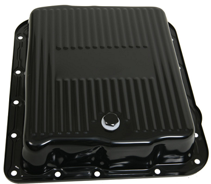

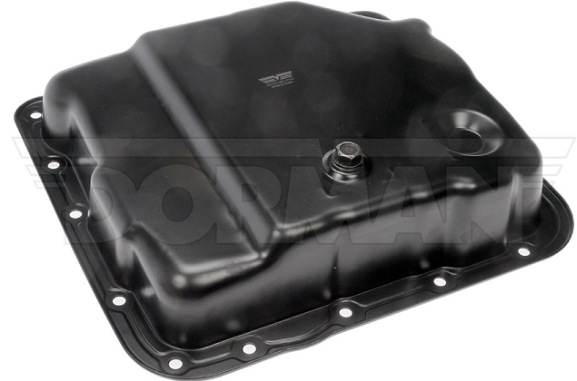

We do not have another steel pan with a drain plug that would match the pan you have described. The 4L60E and 4L65E pans do share the same gasket and pan rail shape. However, there was a shallow pan that was around 2 3/8 in. that was flat on the bottom. Then there was a deep pan that was 3 1/8 in. deep in the front with a shallow step in the rear and from what you have described you would have the factory deep pan. The shallow pan pictured is our Summit brand part number SUM-G3886B.The deep pan pictured is the Dorman RNB-265-811 that we previously recommended.
Shallow pan which has same depth front to rear.
Deep pan which is deeper in the front with a shallow step in the rear.

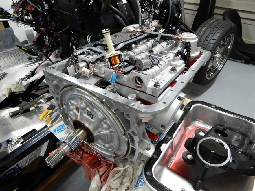

Deep pan which is deeper in the front with a shallow step in the rear.[/QUOTE]
I'd need to look at my tranny to make sure that low part of the pan (upper right corner in pic) won't be a problem.
My pan doesn't have that indent in it.
The back side of the Dorman is like my pan.

It might fit. That indent in the pan would be on the front right corner (where the solenoid is pulled out).

That pan will fit.

That pan will fit, I'm using it on my trans.
