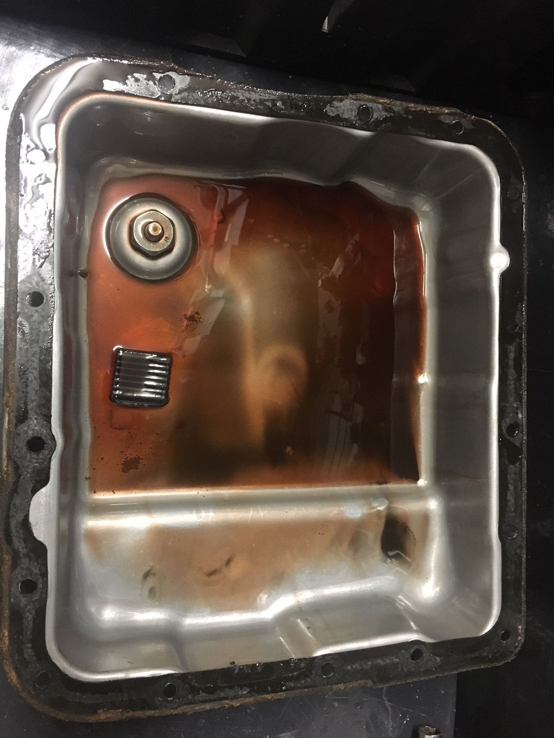

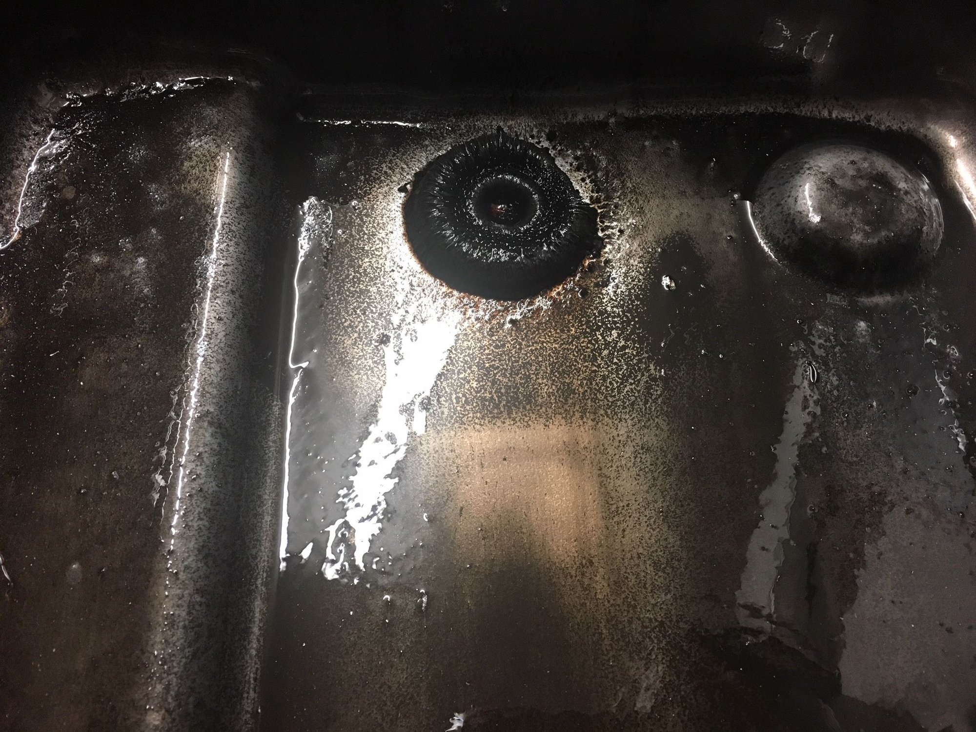

Old Oct 9, 2019 | 09:11 PM
2007V's Avatar
Joined: Jan 2013
Posts: 252
Here is what I have with the pan off. How bad is it?

Old Oct 9, 2019 | 10:16 PM
brandon6.0's Avatar
iTrader: (32)
Joined: Dec 2009
Posts: 2,331
Likes: 29
From: Glennville, GA.
Alot of clutch material and metal! Not a good thing!
Old Oct 10, 2019 | 12:01 AM
Tranzman's Avatar
Joined: Jan 2019
Posts: 677
Likes: 490
From: Roxana, IL
Yep you have a chia pet growing on the magnet. Time to overhaul or replace it. Flush cooling lines and install a bypass transmission cooler or replace the radiator.

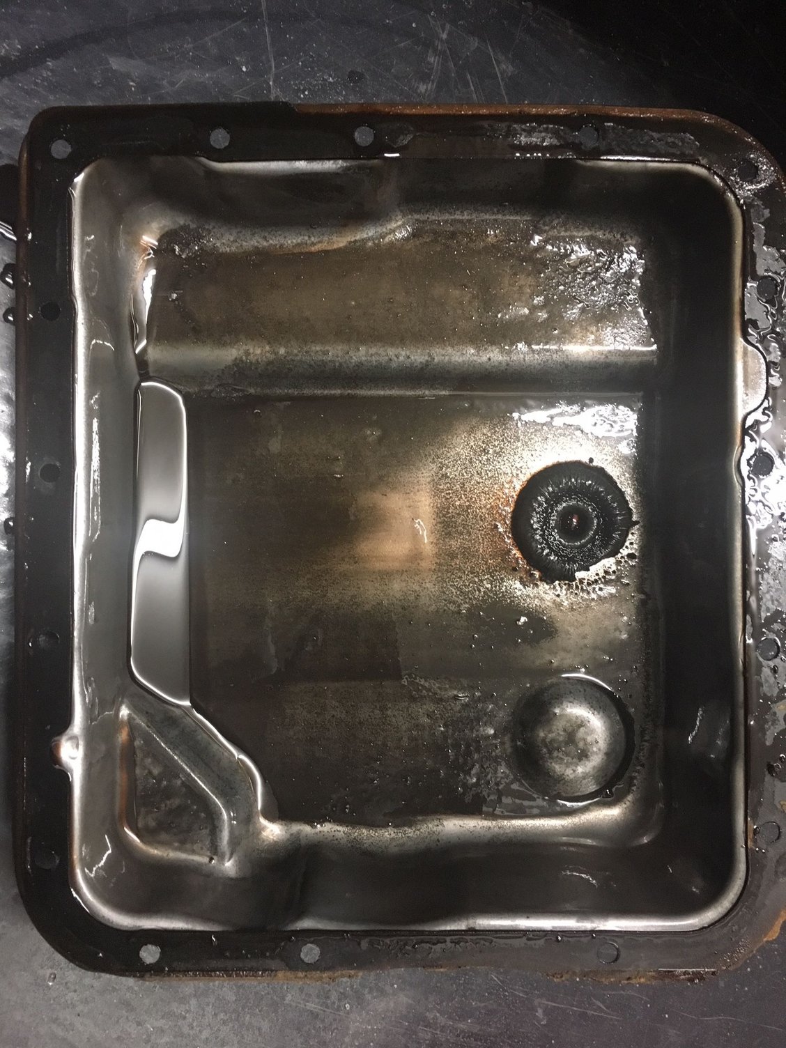

Old Oct 10, 2019 | 07:37 AM
2007V's Avatar
Joined: Jan 2013
Posts: 252
Here is the other used one going in. All ok? Anything that I should do it it while it is out, or anything easy to swap on it?

Old Oct 10, 2019 | 09:44 AM
Tranzman's Avatar
Joined: Jan 2019
Posts: 677
Likes: 490
From: Roxana, IL
Thanks!
Looks like that one is showing it's age too. The fluid is still a decent color. You have 2 options at this time.
1) Put in a new filter and risk the 4KZD unit. Hopefully it came with its own converter. I would drain that.
2) refresh that one and replace the converter.
Because I'm a builder, I would get into it and give it a good refresh. The reasoning for this is, I bench build and hear a lot of "I just put in a junk yard unit and it only lasted XXX time." It's a lot of work to remove & replace a transmission.
Best way to flush the lines/cooler is with a hot flush machine. Most DIY'ers don't have access to one of them. I recommend a can of cooler clean. Its available at most parts stores. I would definitely bypass your original cooler or replace the radiator.
