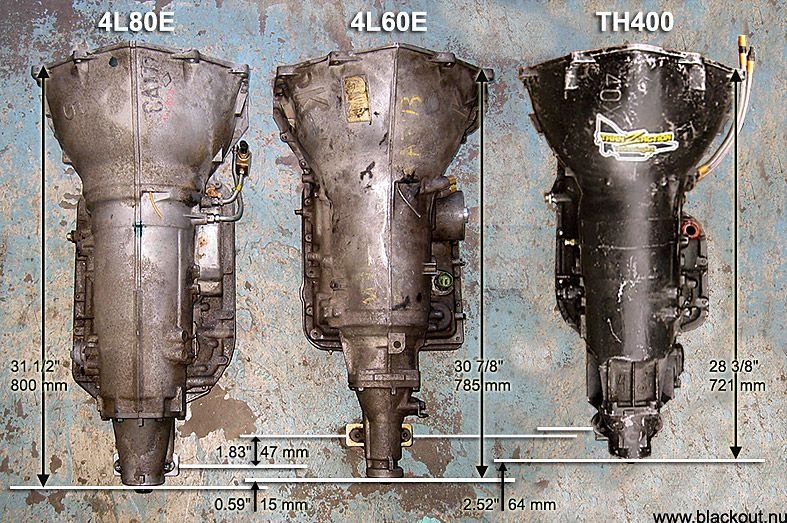

Hoping to minimize the amount of tunnel work required. A 4L80E will require quite a bit of work.
The THM400 units that were a factory option for your vehicle fit quite well...
I am curious... what power-train (engine/ trans/ differential) came in your vehicle originally?
So I would imagine that a 4L80E unit should NOT be much work. They are close in size.
The passenger side pan-rail is larger and the tail end is larger... The early cases with cooler lines at the pump make the unit an easier fit too.
My father was a huge BUICK enthusiast and mostly had Skylark/ GS cars... I have fit both THM200-4R units and 4L80E units in his cars (A-body) without issue.
Your car (Super/ Electra C-body) is much larger and has more room for the transmission (in most parts of the tunnel anyway).

A unit from the 4L60 family could work... Don't get me wrong.
I build these for customers, but hesitantly for the 1,000 HP mark (only in situations where another transmission is not permitted).
I feel the THM200-4R is a superior choice over the 4L60 family when approaching the 1,000 HP mark... or in your case for a big/ heavy car.
Even with all the improvements that have occurred with this unit from 1982 to 2008... OEM and aftermarket...
The 3-4 clutch is still lacking. The 4L79 drum makes a huge improvement for the 3-4 clutch in terms of clutch surface area...
But the 3-4 clutch apply piston is still lacking.
This alone is a big part of what makes the THM200-4R a better choice when building these units up.
As a builder who sells both transmissions for that power level; I have a hard time turning people to the 4L60 family units for:
-heavier vehicles
-medium to high powered light vehicles
-medium powered heavy vehicles
Your car should be in the 4,700 lbs to 5,200 Lbs range stock.. Possibly lighter with a small block Buick engine (small block Buick engines are lighter than small block Chevy engines).
The 4L80E would be a better choice over the other two transmissions by far. Second to a 4L80E unit would be a THM200-4R unit and lastly a 4L60 family unit.
A 4L80E unit would definitely outlast a comparable 4L60E, and usually for less money.
Not to mention handle more power (should you decide to build-up that 6.0L)
