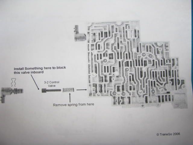

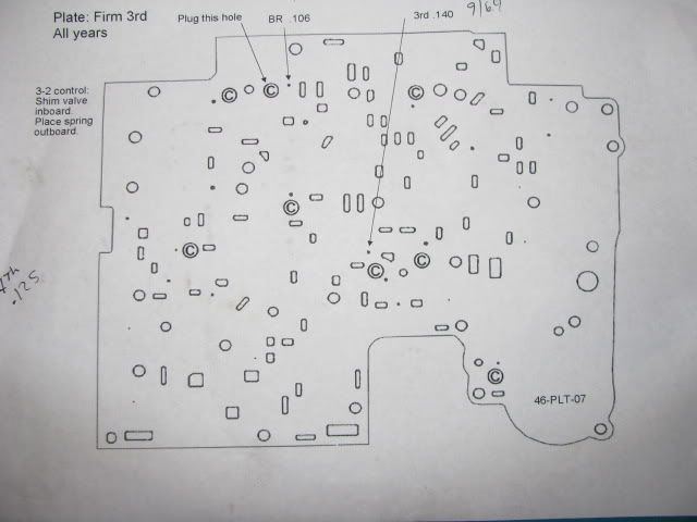

For a faster, more firm third you could do this.
From transgo.
Old Oct 13, 2019 | 05:06 PM
td1168's Avatar
Joined: Mar 2012
Posts: 427
From: Uniontown, Pa.
So in the lower picture you remove the spring and install a spacer to hold the valve in so it won’t move back and forth?
Old Oct 13, 2019 | 06:25 PM
Jays_SSZ28's Avatar
Joined: Aug 2009
Posts: 2,223
Likes: 56
Yes thats correct.

Yes, that is what I do too. Except that you want the band release at .099" - .101" and the 2-3 shift at .135" when using the Corvette servo. Keep the band clearance at a minimum. One thing not mentioned here, is that when you go over 6,000 rpm, the line pressure starts to drop (on all GM pumps) and if this shows up, it will always be on the WOT 2-3 shift as a "flare". The pump will need the TransGo Hi-rpm steel rings and priming spring to keep the pressure up and flat to 8,000 rpm.

Do you have a diagram of the separator plate that shows which holes these are in the plate?

In the top pic what does the “BR 106” mean?
That is the band release hole drilled out to .106"
Okay thanks.
