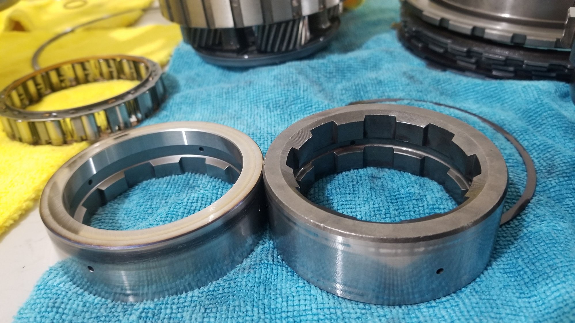

The inner race on the left is from my 2wd 4l60e out of my Trans Am. The one on the right is out of a 4wd 2003 unit. Will it work if that is the ONLY hard part I swap into my 2wd unit?

The one on the left is a Sonnax piece.
For their sunshell with bearing.
It redirects thrust.
If you swap the inner race, you need to have the shell and bearing to match.

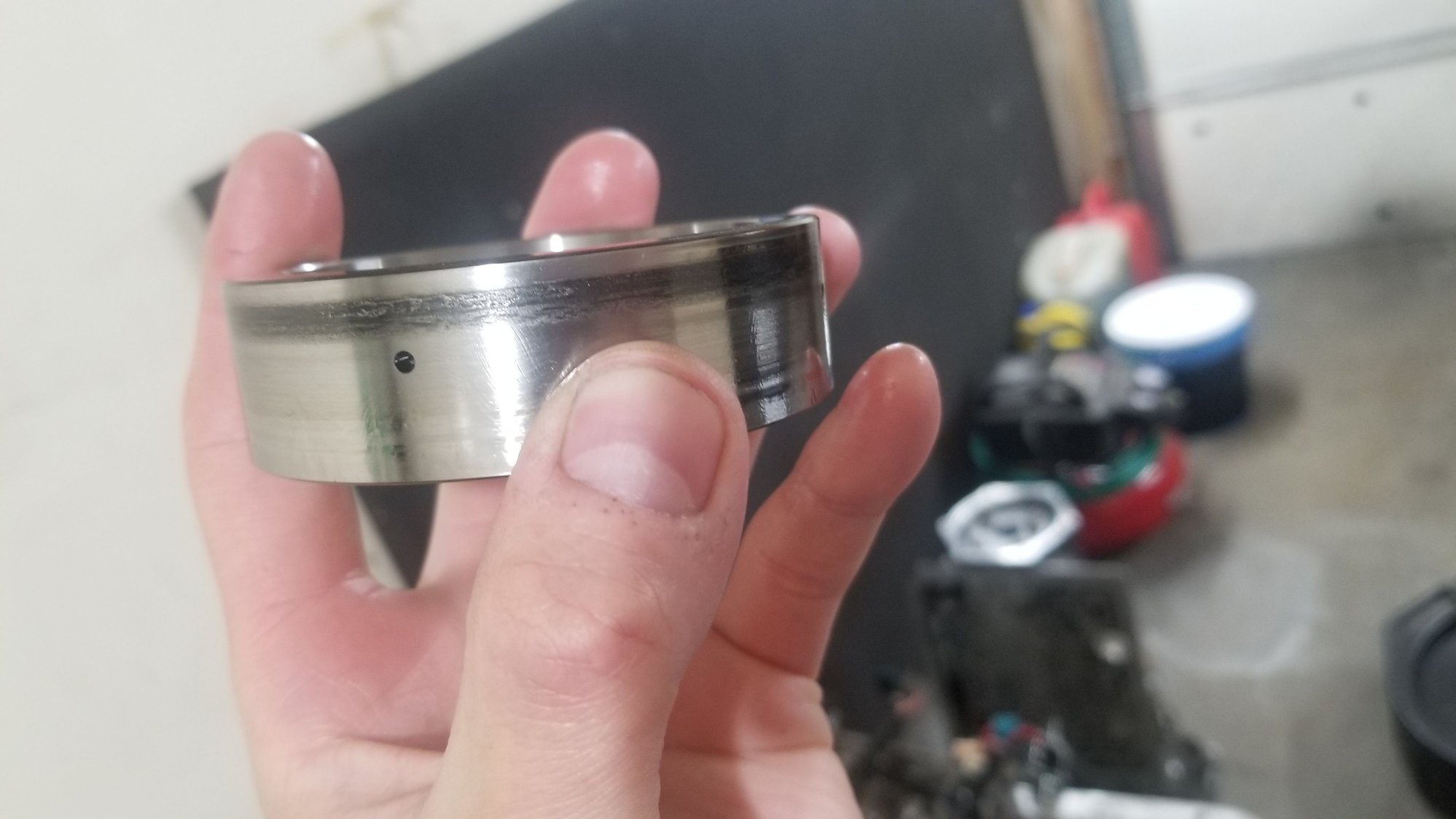

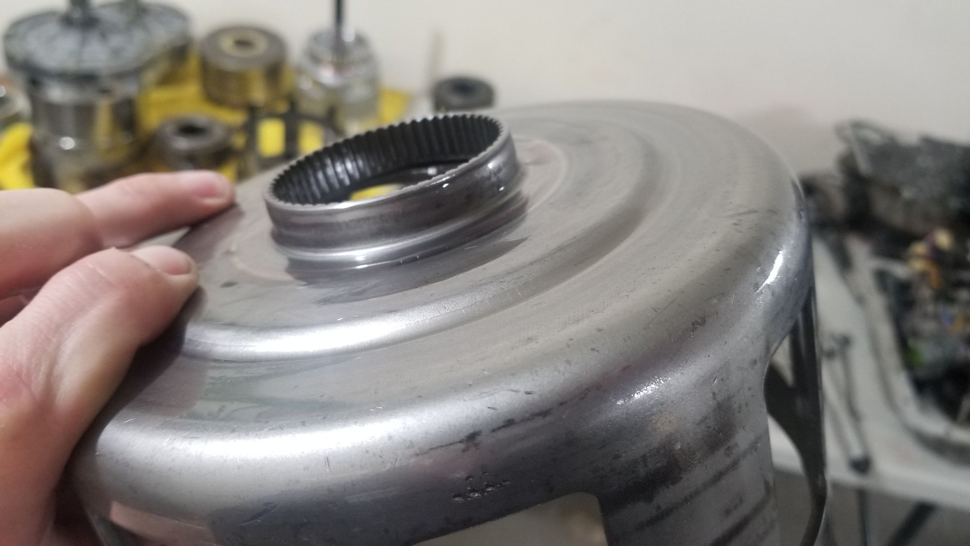

Also would I be nuts for reusing this inner race. Slight pits that catch the nail

Originally Posted by 98CayenneT/A
ok, thanks, Is this a hardened shell from my '03 unit or were those introduced later?
I think the middle part by the splines is usually discolored from the heat treatment?
Old May 6, 2020 | 03:58 PM
98CayenneT/A's Avatar
Joined: Nov 2013
Posts: 3,913
Likes: 366
From: White Bear, Mn
that's what I thought and it's not

MaroonMonsterLS1's Avatar
Joined: Dec 2012
Posts: 3,618
Likes: 1,328
From: Iowa
Does not look like a heat treated drum. 03 was the year they started to get reintroduced. Looks like you didn't get a hardened one.

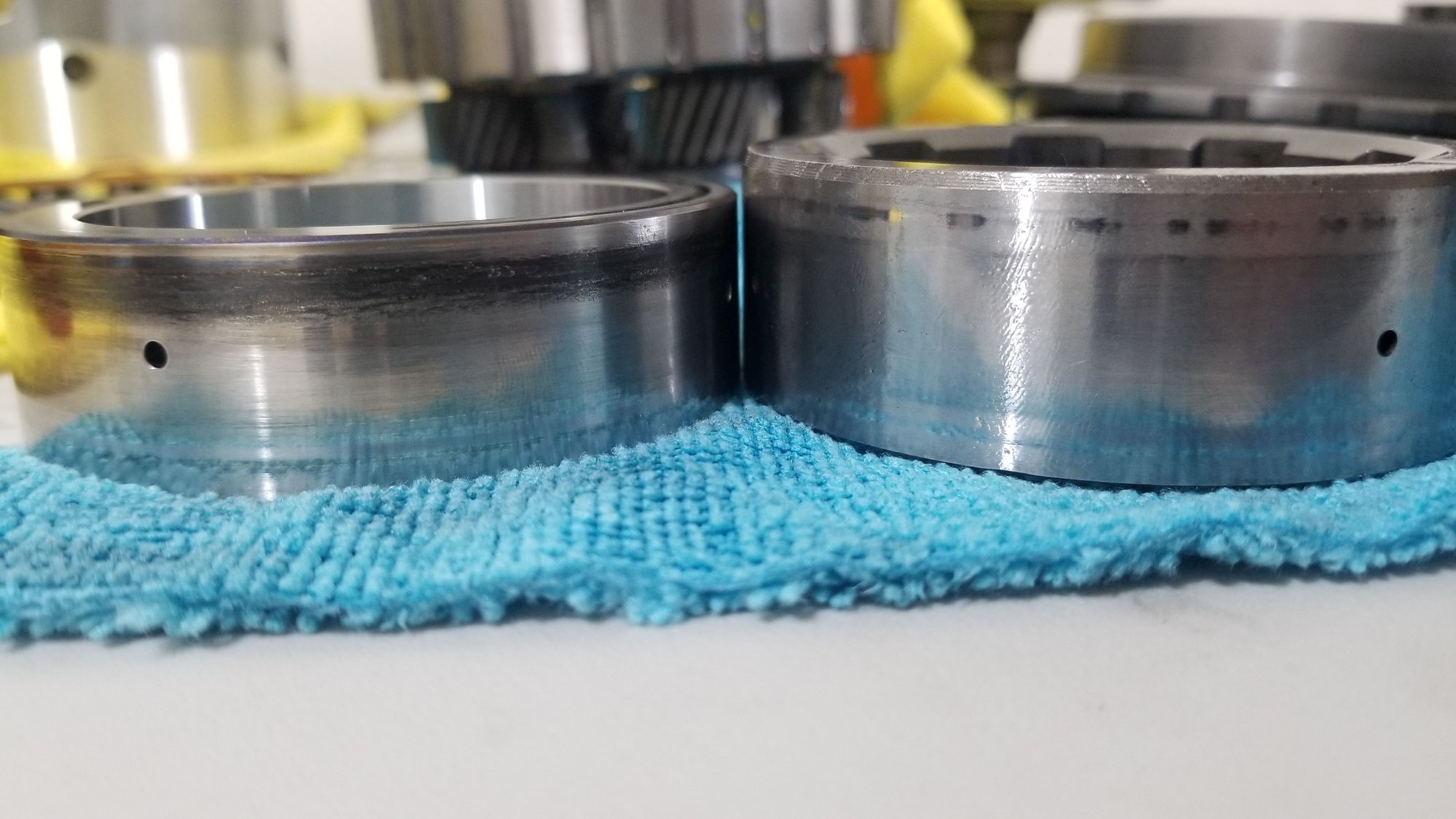

As you can see, the left inner race is VERY different from the right. It's been cut down and bored out.
That's for the bearing UNDER the sunshell. Putting that bearing under the sunshell redirects the thrust force away from the captured bearing under the sun gear.
So...you either need to find a buddy with a lathe to cut the one on the right to match the left...use all the parts from the one on the right, or use all the parts from the one on the left.
When I say "all the parts" I mean shell, bearing/washer under shell, and inner race. Those 3 parts need to match as a set

I attempted to cut into one of those inner races about 15 years ago... Talk about a hard material!
I should try this again... just to see if anything has changed.

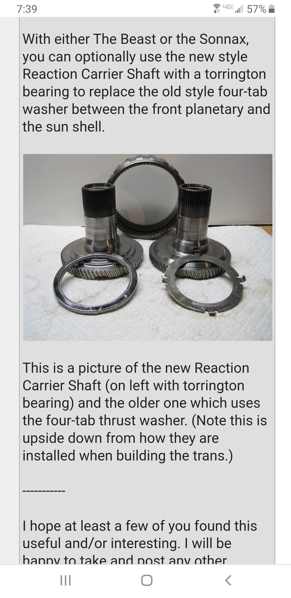

Can I use the stepped reaction shaft with the sonnax smart shell if I also use the thrust bearing with it or do I need to use the non stepped reaction shaft with the thrust washer when using the smart shell?
My reaction shaft has a good step in it but my stepped reaction shaft out of my parts transmission is nice.

Think I found my answer being asked in post #10
EDIT by mrvedit: This is from my post #29 in this thead from 2012:
https://ls1tech.com/forums/automatic...n-shell-2.html

you can use either. The reaction shaft must be matched to bearing/washer and used as a set...but the shell won't dictate which you use
As for cutting the race. Carbide and patience.

The induction hardened sunshells have a noticeable discoloration at the area where the low/reverse sungear attaches. If it does not have this, do not use this sunshell.

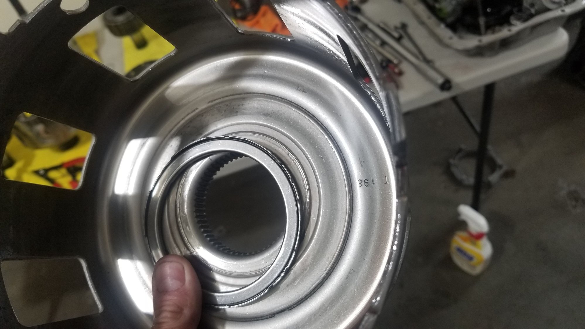

Whats it look like? The one you sold me has no discoloration. It also has no box or anything with a brand name on it. I called you and asked you about it. I also asked about the cracks around the splined area and you looked at a few others you had and said they all have the same cracks. Shallow looking cracks that may have come from the stamping process.
I've ordered stuff from you since 2003. This was my last order, probably 2018 and the packing material is why I'll never order again. That and the fact that now everyone says it should have discoloration (except when you're trying to sell one I guess). The ones at the GM dealer had no discoloration. Everyone I talked to says they don't have discoloration and I can't find a picture of a genuine GM sunshell that has discoloration from induction hardening.
So whats going on with all of this?
you can clearly see the lightly discolored area in this factory sunshell. This should answer your question. It’s not like a totally different color but you can tell it was heat treated.
https://www.summitracing.com/parts/ado-24229604

This is a factory one
this is a China one. I’d stay away from a China one. They don’t heat treat stuff correctly
