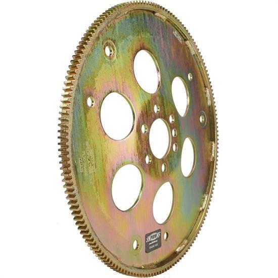

This is a similar flex plate to what I have. It doesn't require a spacer. Starter works fine so im going to assume its correct.

Is that a flat flex-plate or a dished flex-plate?
The 4.8L and 5.3L engines will normally use:
-A flat flex-plate with a spacer/ pilot extension assembly (The spacer goes on the between the crankshaft and the flex-plate).
-A dished flex-plate with a spacer/ pilot extension assembly (The spacer goes between the flex-plate and the converter).
It is possible for the starter motor to engage the flex-plate teeth... but have a mix-match that results in the converter pilot being unsupported.

So I have a dished flexplate and I don't think I have that pilot extension in it. Jacked the car up and pulled the bolts out of the the converter and flexplate and the converter pushed back one click. Theres about a 1/4 inch gap between the converter and the flexplate now so thats wierd. I don't recall putting that spacer in it so I think thats the main issue. I think I still have to pull the tranny which is fine.

Unless you have a custom torque-converter made; for the purpose of pairing a Small-Block Chevrolet Gen. 3 or Gen. 4 engine to a THM400 transmission...
A dished Flex-Plate alone, will not permit the torque-converter pilot to be supported by the crankshaft.
Note: some Gen. 3 truck 6.0L engines were produced with a crankshaft flange that is like a Gen. 1 (One-Piece seal type) engine and does not require a spacer.
Purchase the GM crankshaft to flex-plate spacer/ pilot support extension with longer flex-plate bolts.
Measure the torque-converter to flex-plate spacing (like the instructions with the torque-converter say to do).
Reinstall and pray that you did not do major damage!
Spacer= GM part #12563532
