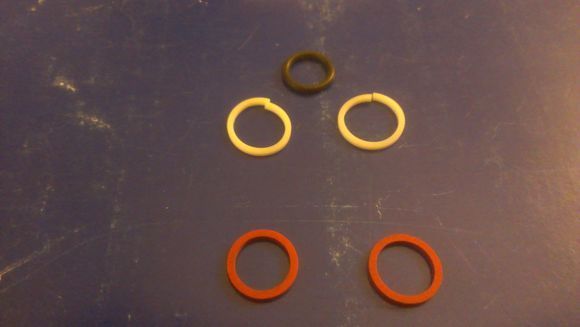

One added note.
Regarding the 2-4 Band Servo apply-pin:
-The Longest GM apply-pin is less and less available (GM is phasing-out many parts for this transmission currently). Not Good.
-The GM apply pin removed two sealing rings (and grooves) from the pin (seals nearly as well as with the 2 seals but also cant have a seal fail). Good.
-The GM apply pin does experience some wear in one location in the servo. Not Good. (The Sonnax apply-pin helps this issue).
GM pin shown below:
Sonnax pin shown below:
-The Sonnax apply-pin is the Longest produced. Good.
-The Sonnax apply-pin adds an O-Ring (and groove) to help with the wear at the servo -The Sonnax apply-pin. Good.
-The Sonnax apply-pin uses an OLD GM design with two white sealing-rings that were removed from the GM pin (easy failure point). Not Good.
There is a solution that can be added to the Sonnax pin.
It is a Solid Teflon Sealing-Ring instead of a "Split-Cut" Sealing-Ring (you will rarely find "split-cut seals as they suck. Not to be mistaken for "Scarf-Cut").
These better seals are GM THM200-4R Governor Sealing-Rings.
They can be purchased individually for about a dollar from Trans. Parts Houses (like Cobra Transmission).
Part number: 54189BT.
The red seals in the image below are the better seals that I have mentioned:
