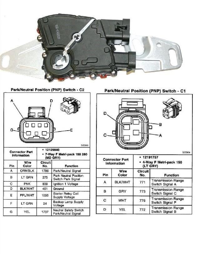

There are only two versions of the PNP Switch assembly.
Prior to 2004... Connectors shown in the image below:
Terminal placements are as follows:
The 2004 and Up version... Connectors shown in the image below:
So the transmission should be the same and work? What would be the reason I can jack the back end up and spin the tires in park?

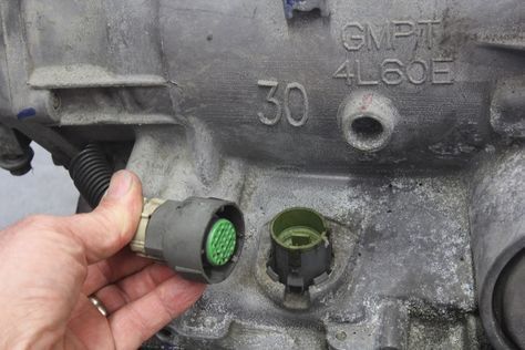

The PNP Switch Assembly is for Starting the Engine (Gear Selector must be in Park or neutral) and activating the Reverse Lights.
The Transmission (if good) will still work with all the Electrical Connectors disconnected.
The next step is to unplug the main Electrical Connector from the Transmission.
This one:
If the Transmission is good, it will work in Reverse and Drive with 3rd Gear ONLY.
