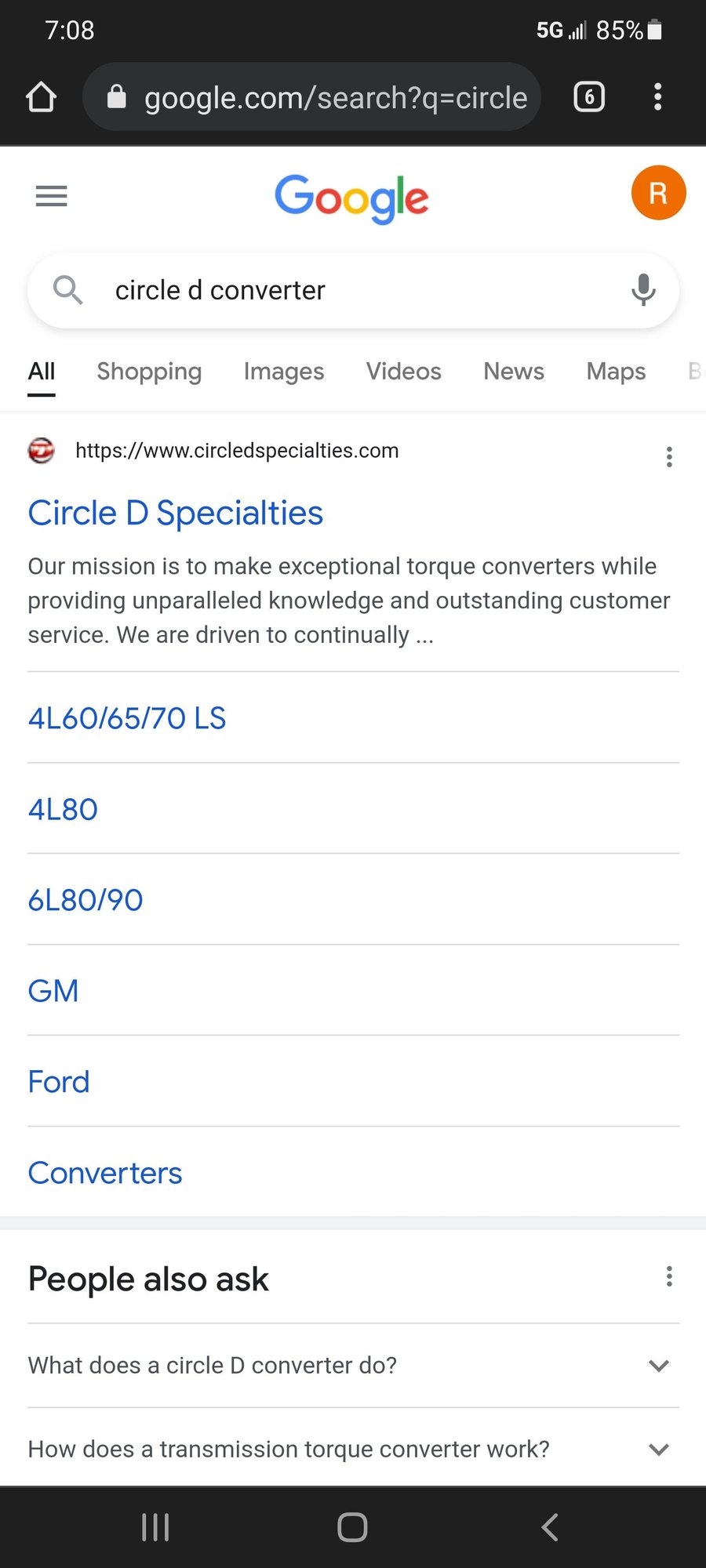

do you have a number for them by chance?
