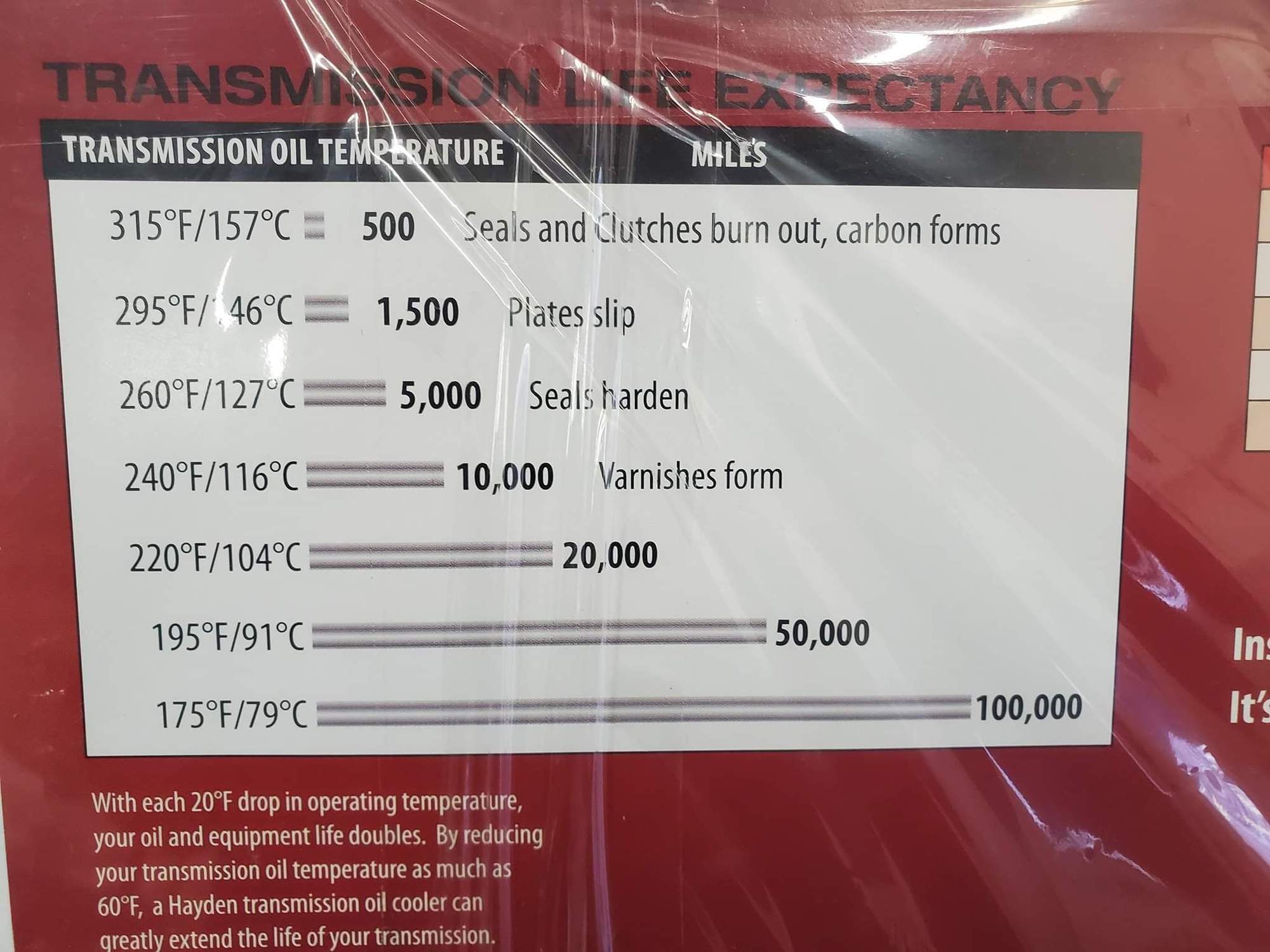

There is huge debate going 2 coolers vs 1. Im on the 2 coolers side in my climate and everything that doesnt have a minus temperatures. There are $hitloads threads like these : https://ls1tech.com/forums/automatic...ing-issue.html
Here is a proof that even with completely locked TC, the temps are high. You dont know what youre talking about.
So while me from long testing and personal expirience, and the rest of the industry debating on this, and 2 coolers wins most of the time except what Maroon said above, who the f are you to say what you say and to measure my knowlege? Thanks.
It's low, but only few people here can rate it. And they are not you.
