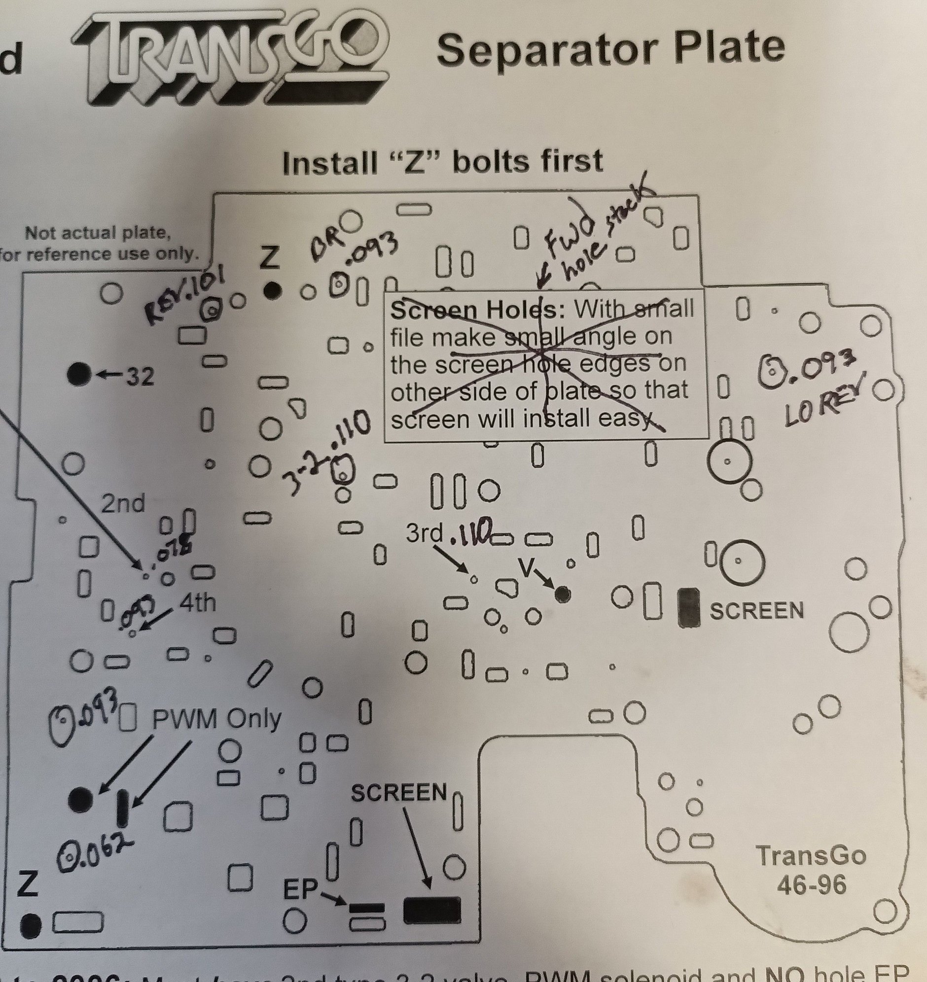

I've got my swap up and running. Trans is a 03 4l60e. 1 to 2 shift is very lazy. Not slipping just a very long drawn out shift. Rest of my shifts are quick and crisp. Converter locks and unlocks great.
Trans mods:
Sk4l60 kit, Plate drilled according to specs I got here, Clutch clearance and band clearance specs I got on here, Wide band, New drum, hardened shell, HD clutches, Sonnax painless 1-2 & 3-4,
sonnax hd 2-3 valve, Corvette servo , New stock pin..
I'm sure that I am forgetting a good bit of parts and mods done in the rebuild.
Why would only 1-2 shift so poorly?

Originally Posted by cantbuytime79
I have a TG .500 boost valve , sonnax hd 2-3 valve, the sonnax pinless accumulators for the 1-2 and forward. I blocked the hole in the 3-4th accumulator and leaving out the guts. I've blocked the 3-2 valves in the valve body as well. I'm using the transgo HD separator plate and sk4l60e shift kit. I've already done alot of reading on what springs to use with the pinless accumulators. I also pressed out the input shaft from the drum and reinstalled with 620 green loctite. Also using a Corvette servo and setting it up as I've seen recommended on this forum.
I'm waiting on the o-ring end plugs to come in.
Here is a better pic of my current separator plate holes.
​​​​​​​https://ls1tech.com/forums/automatic...r-plate-2.html

That's the thread where I was having issues with clutch clearances and plate hole sizes for my setup. My band clearance I believe came out to .072
