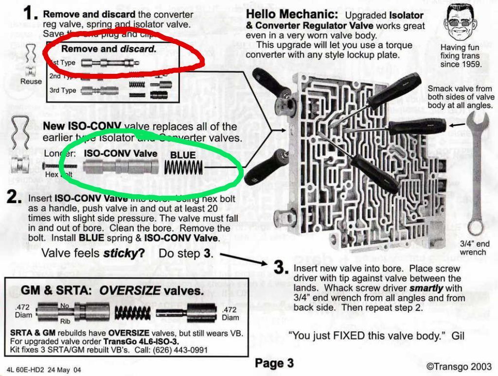

Is this the valve you are referring to?
if so, you discard that valve and install the new transgo valve & spring. spring goes in the bore first, then the valve last.
yes, that is the picture I posted from the older style VB I had purchased. I had asked because I didn’t have documentation on valve. And noticed the difference in those from mine to older one. I do indeed have the transgo one. Is that a on/off solution where it gets rid of PWM?

Yes, makes TCC an on/off arrangement, the Transgo valve also is slightly oversized so it should fix potential leaks.
