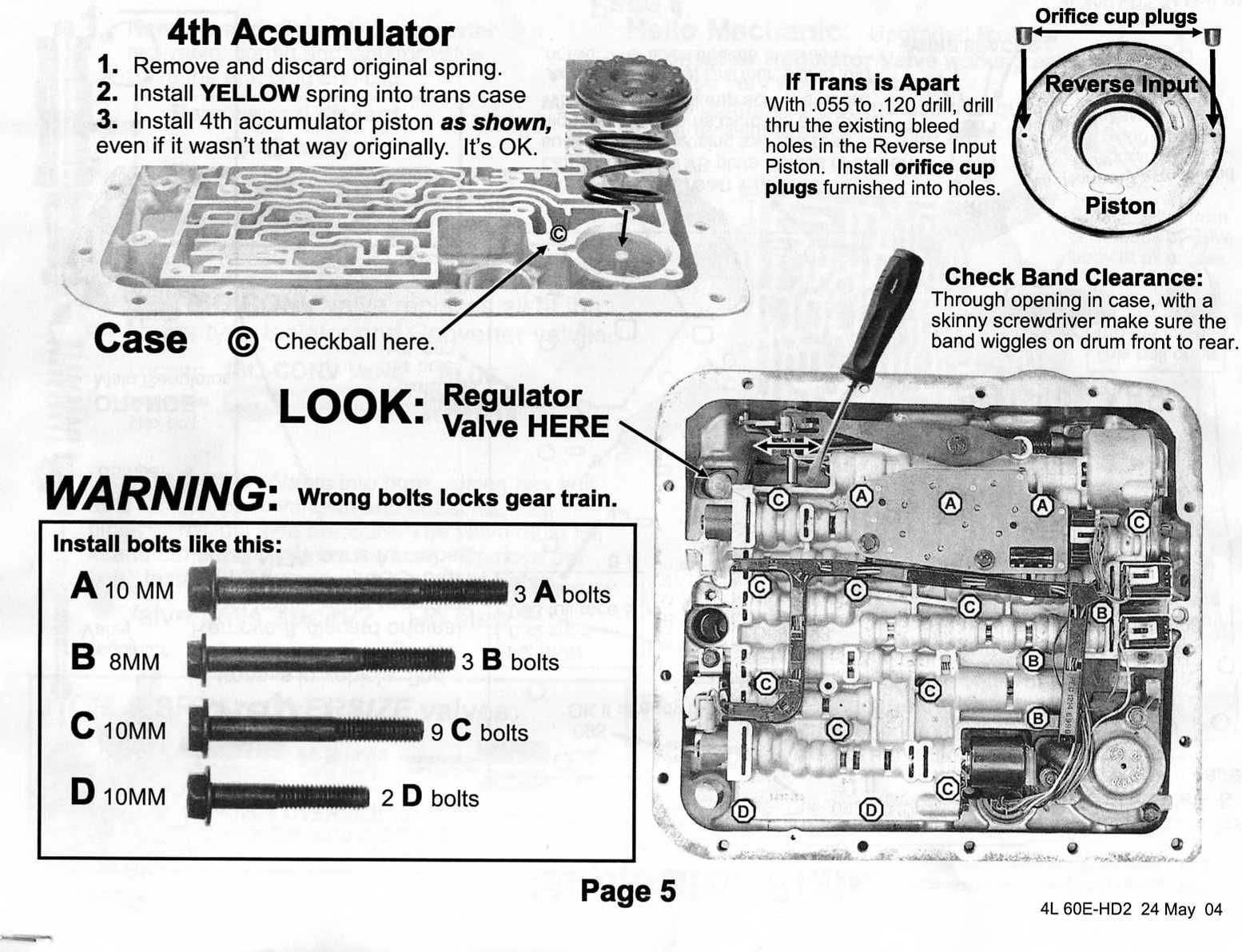

i (believe) i understand what blocking the accumulator does but have no idea whats needed to do it. can it be accessed with trans in the car?
Old Dec 4, 2022 | 10:29 AM
tayto's Avatar
Joined: Jan 2013
Posts: 463
Likes: 179
yes,you will have to remove valve body
Old Dec 4, 2022 | 10:56 AM
Dian's Avatar
Joined: Nov 2016
Posts: 371
Likes: 18
From: switzerland
is that the case when blocking the 3-2 downshift and the 3-2 control valve also? maybe i find some vids on how to remove valve body.
Old Dec 4, 2022 | 12:56 PM
tayto's Avatar
Joined: Jan 2013
Posts: 463
Likes: 179
yes.... pay attention to the v/b bolt length when reinstalling. transgo's shift kit instructions have a good diagram, they are available on their website.

Old Dec 15, 2022 | 02:24 AM
Dian's Avatar
Joined: Nov 2016
Posts: 371
Likes: 18
From: switzerland
thank you. i found good instructions on valve body removal here (maybe it helps someone):

If you block the feed hole in the case and leave the piston out what is the benefit in leaving the checkball out? I left the checkball as it was.
Old Dec 20, 2022 | 01:57 PM
2BFAST's Avatar
Joined: Apr 2005
Posts: 1,067
Likes: 234
From: N.E Missouri
Its pretty much useless at that point
