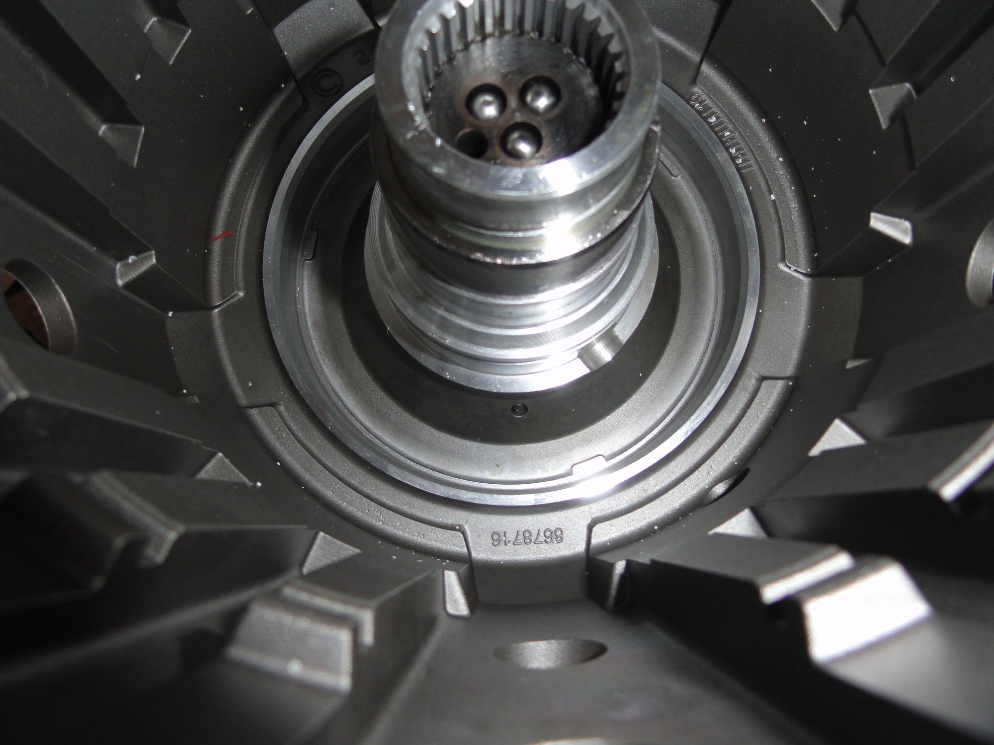

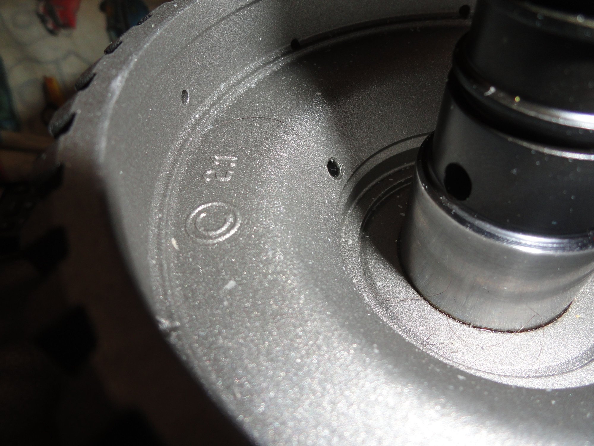

My son just redid his tranny for his 2002 TA with as much of good ol dads smarts as he could use. We decided to use the fancy sonnax input drum with installed billet shaft. Installed completed tranny and things went well for awhile, then 3rd started getting wonky and finally no 4th. Tranny comes out again...chase down every reason why you could lose 3-4...tore hair for a few weeks then finally found it !!!
The cupped orifice at the bottom of the drum with a tenny tiny hole in it was GONE
with the cup gone the piston held nothing as all pressure just leaked right out
my son called sonnax and they state that they get the drums new from GM and that GM stalks the plugs in the drums on assembly
I just so happen to have a new sonnax drum in my parts pile awaiting my tranny rebuild .....I see no stalking around that plug
moral of story ....stalk the plug on your drums !!!

see any stalking ?

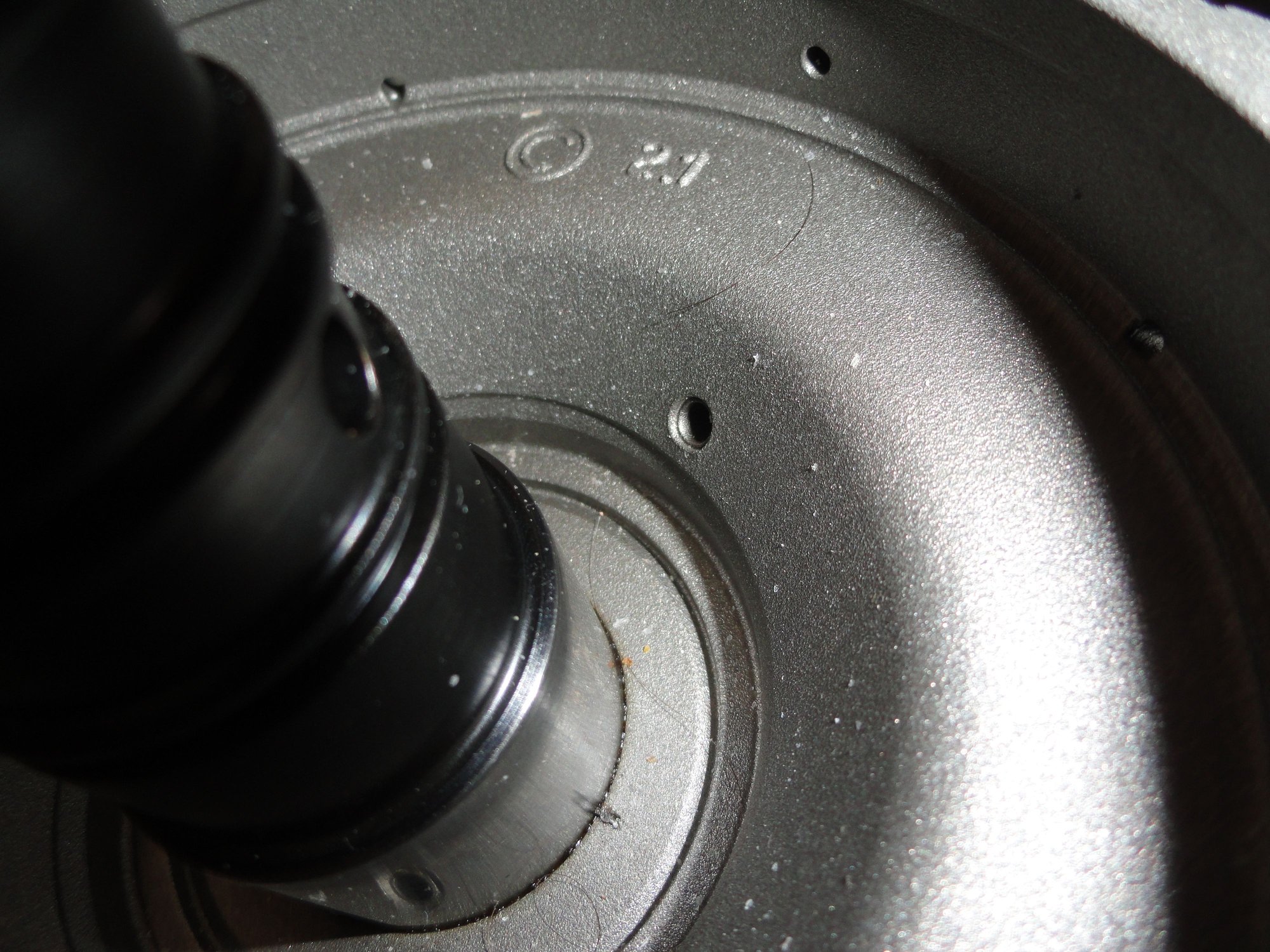

the hole in the cup is really really small
