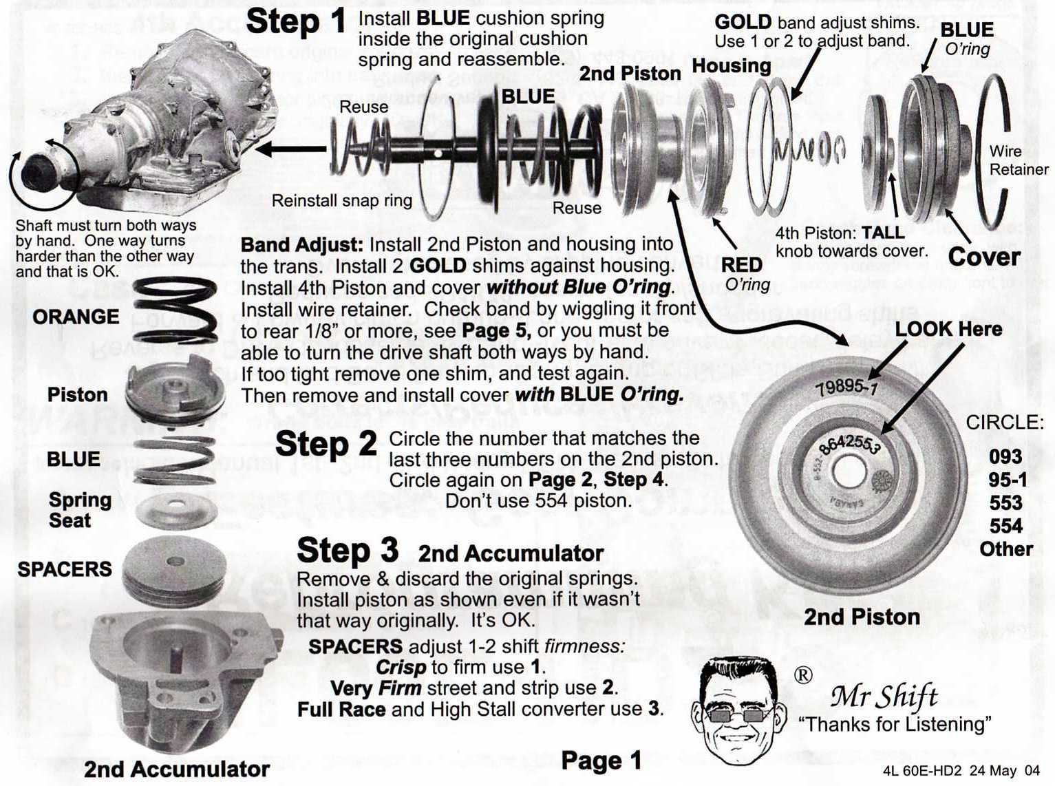

There are 2 teflon rings around the 2nd gear servo piston and 1 teflon ring around the 4th gear servo piston. There is also a red o-ring on the divider and a blue o-ring on the cover. All of that needs to be inspected for damage or missing. The pin in most instances goes right back in place on the band.

Nice pic bbond, I did miss that

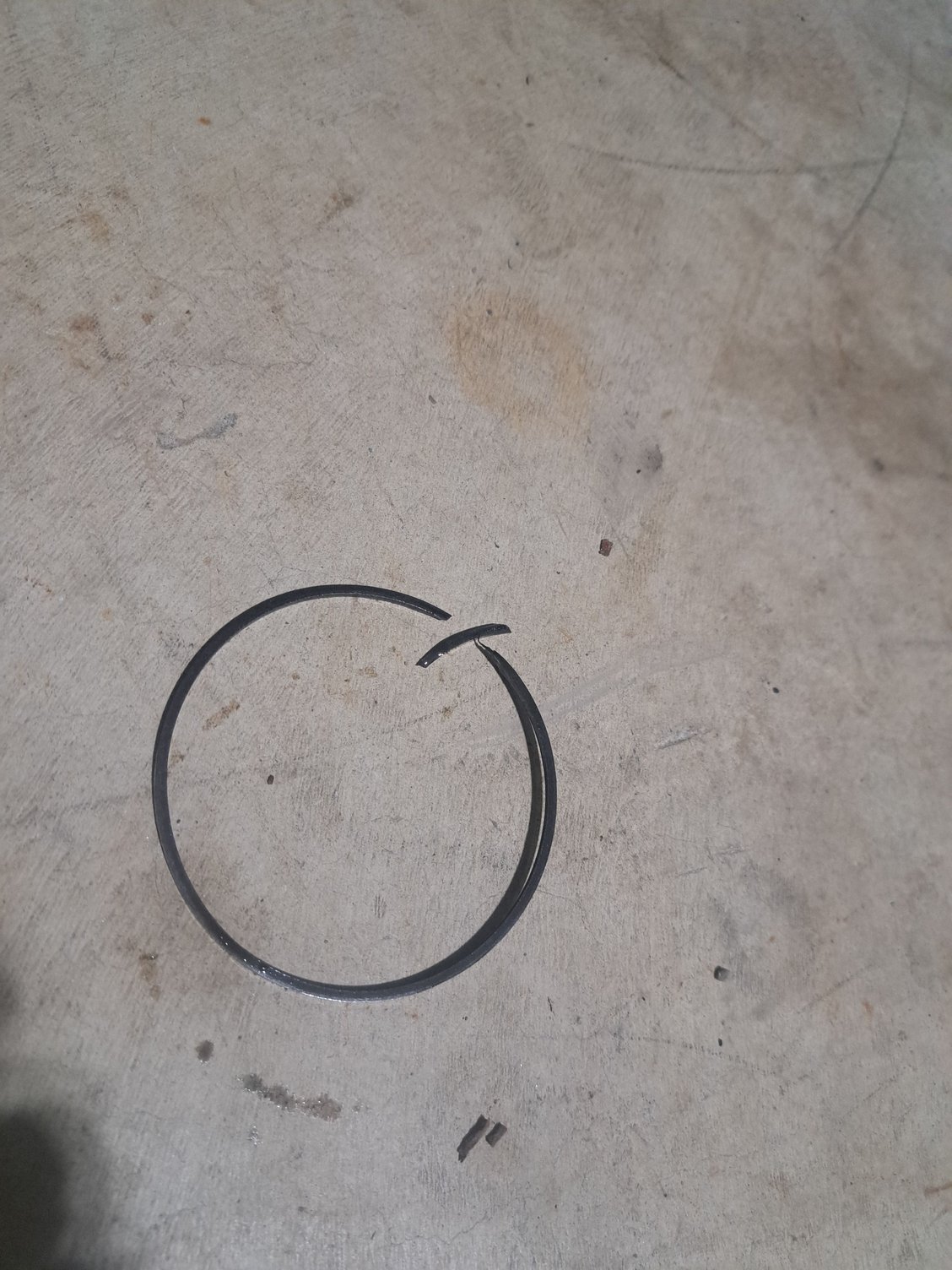

Tranzman and bbond for the win! Thanks guys. What was interesting was this was out of its groove as well as having the rip. So I'm assuming it was in its groove when i popped it back in, and that when doing so i ripped it, and knocked it out of its groove? Any tricks to install it when i put a new one in?
Old Feb 25, 2023 | 03:08 PM
bbond105's Avatar
Joined: May 2012
Posts: 3,050
Likes: 716
From: Poplarville, MS
Use Vaseline or trans assembly gel in the groves and on the sealing rings to hold in place.
