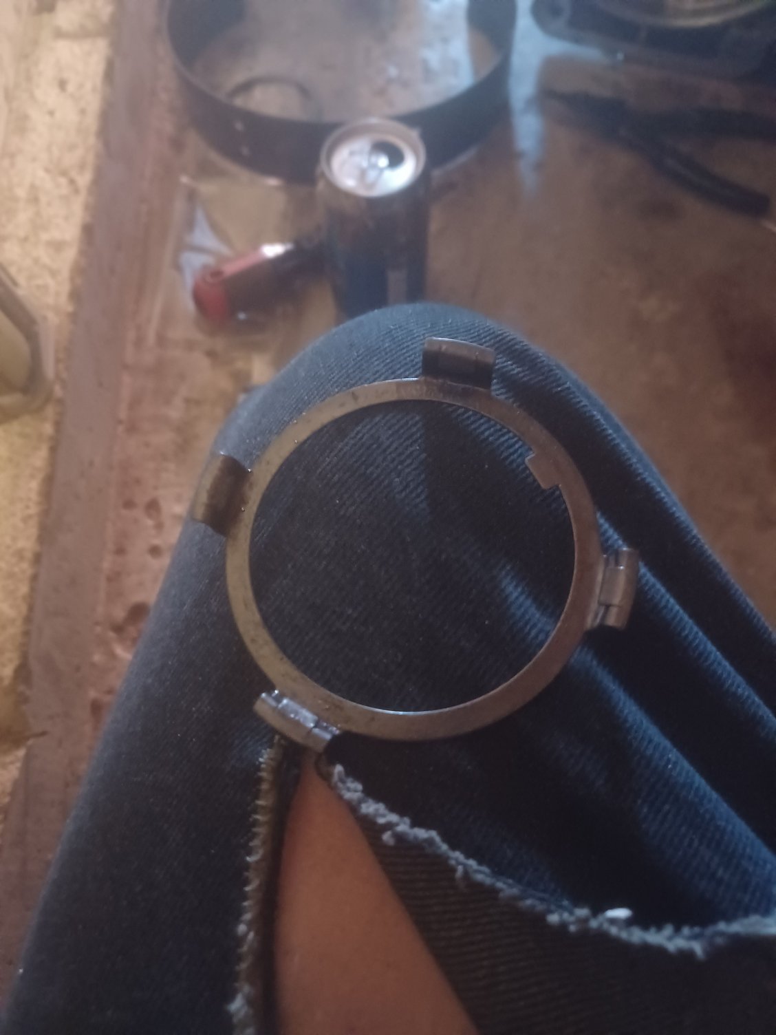

What is this? I must have set it aside and cant find it in any diagram. I went as far as replacing the sun shell and only see two thrust washers and i havw those. Second how bad is this damage on the housing? I cant see anything that would have caused it.

Thats not damage, thats just GM's casting and it was rough at times. Shiny Mark is a machining mark so no worrys. That small peice is your front pump seal retainer. Simply snaps onto the face of the pump over the seal.

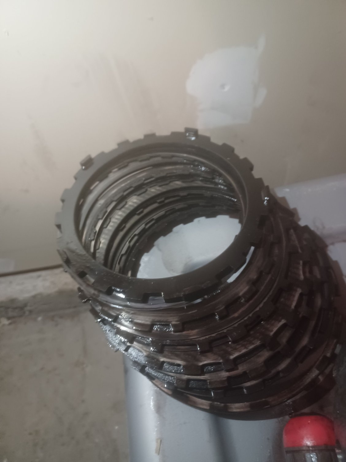

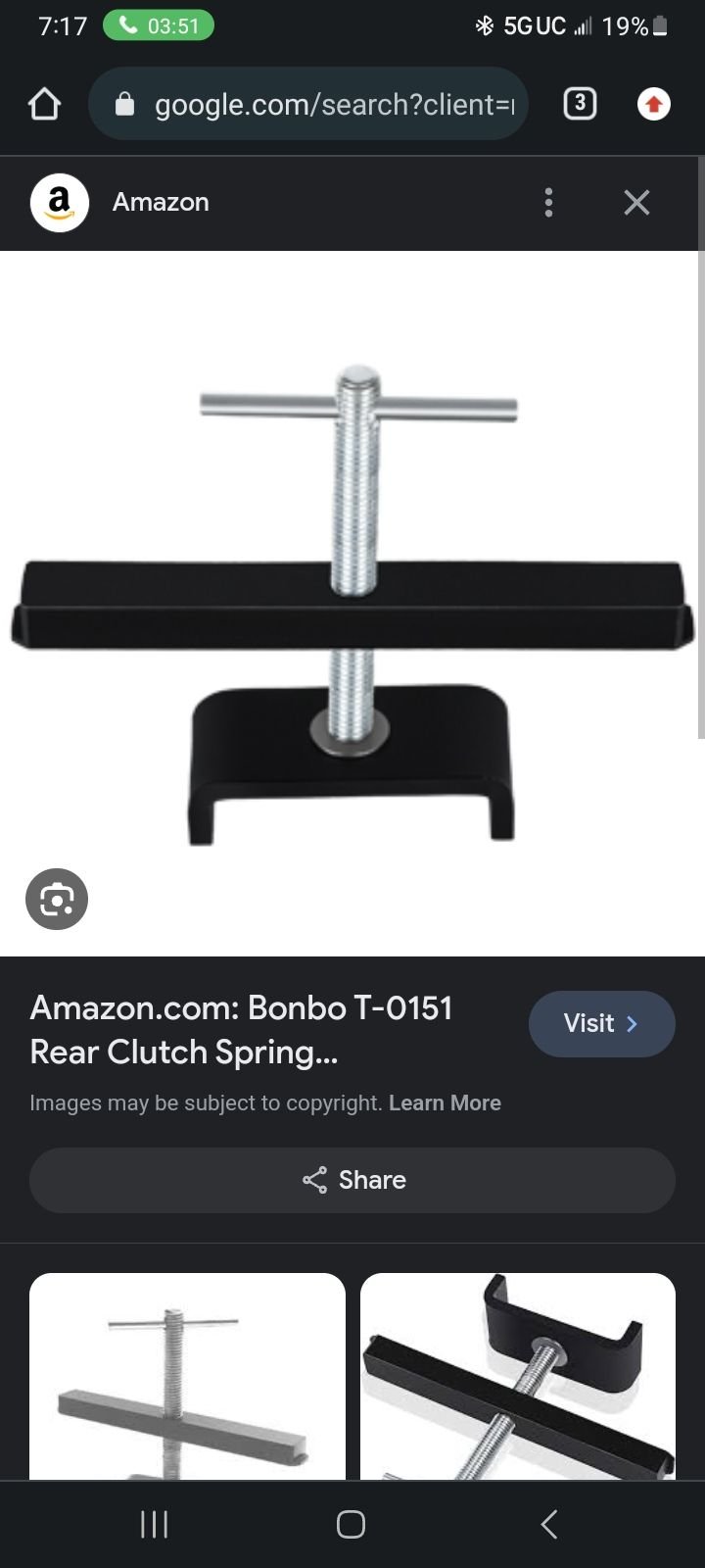

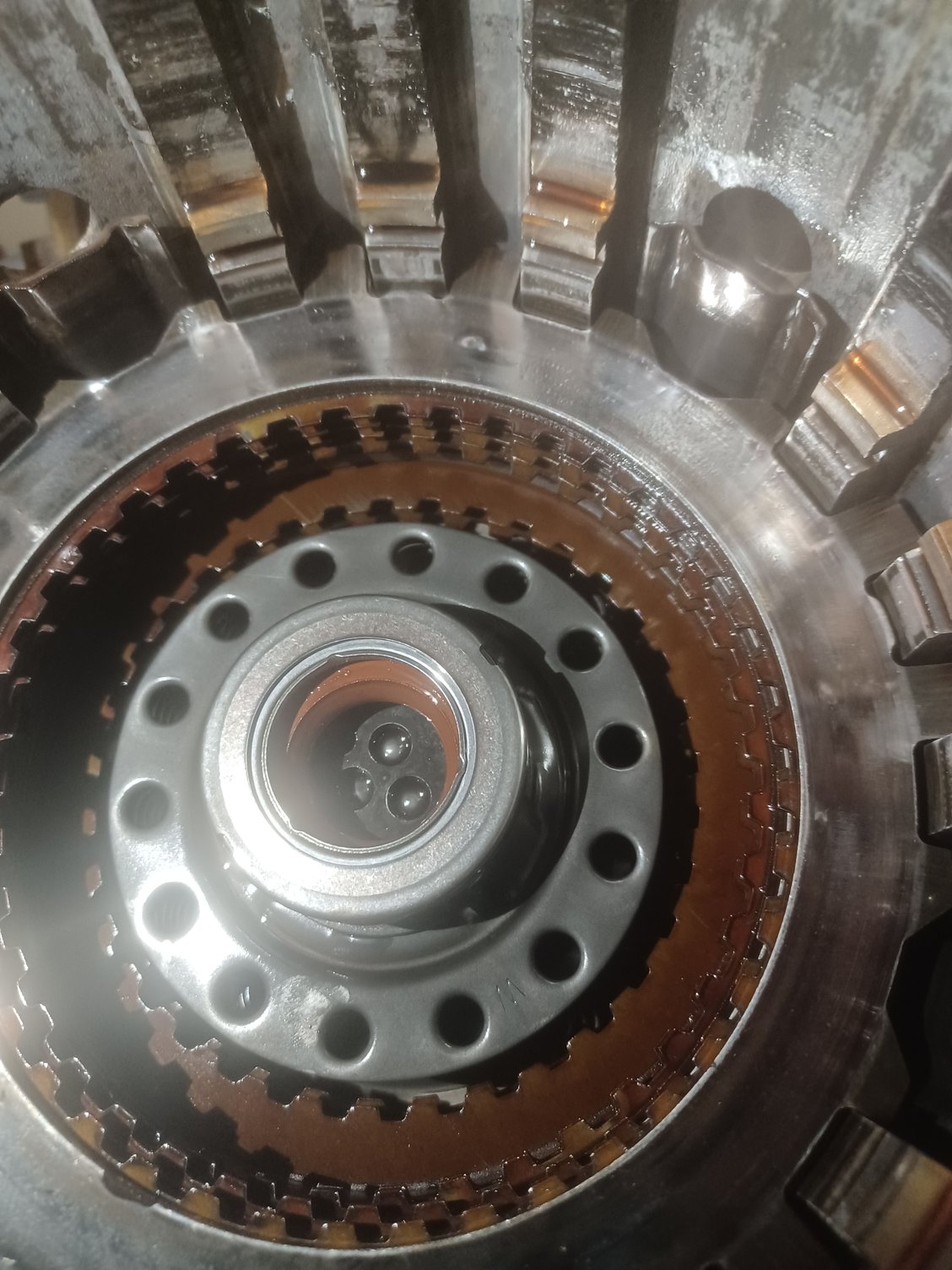

Can I ask the knowledge pool here another question? I ran into another speed bump. The tool I bought to compress the spring in the bottom of the housing was to wide to fit. Anyone know the size for me to cut it to tomorrow? First picture top bar is what I am talking about, second picture in the middle of the clutch pack is my hang up, third picture is the burnt packs if anyone wanted to see the damage.

Wrong tool. The tool you bought is for the low piston return spring in the Bottom of the case.
