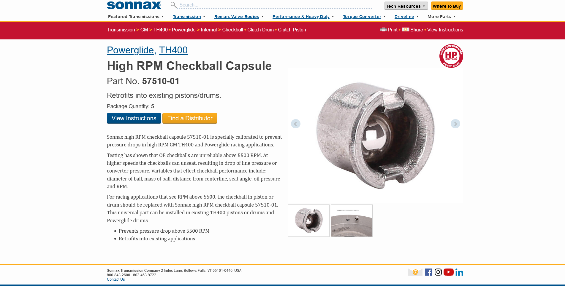

Another Option is to remove the Check-Ball Capsule, Drill, Tap, and Plug with a Set-Screw...
Then Add a Universal Check-Ball Capsule in a new location (Drill and Press-In/ Install).
In Older Transmissions where Hard Parts can be difficult to find...
Often the Drum or Apply Piston that is Obtained has a Check-Ball Capsule when one is not needed.
Or the Opposite, the Drum or Apply Piston does not have a Check-Ball Capsule, and one is needed.
It is common practice to remove one and plug with a Set-Screw...
Or to Install a new One.
