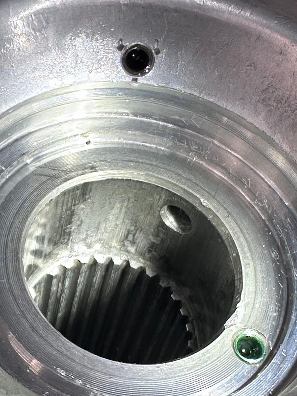

Ok a new finding for sealants for the shaft and input drum.
As I mentioned a while back I noted the following .
1-RED OR BLUE LOCKTITE = Useless as never hardens in this app.
2- GREEN SLEEVE RETAINER sealer LOCTITE = Will harden somewhat over time and or if heat applied but by time I mean days to weeks with my own test drum shft siiting on shelf.
3-SUPER GLUE REGULAR = hardens very quickly but not at all pliable and IMO would break up with normal tortional stress of shaft.
4-SUPER GLUE GELL = Hardens slower good but same as regular becomes extremly britle.
Best result tested thus far = REGULAR OLD JB WELD - Does not require air, oxegen , mosture or heat to harden- Hardened has great bond but remains somewhat or pliable enough not to easily break up under stress- impervious to all solvents and oils that I have tested anyway- stable to 500f plus degrees- Hardens within couple hours enough to seal well and air test apply frictions. fully in about 72 hours all conditions (wet dry sealed open hot cold)
So for now this is my go to, JB QUICK is not suitable as temp stability to low at about 200f .
If anyone has something else they would like me to test post up ill get some and do some test as I did these in my spare time, But for now a thin coat of regular old JB then pressed in and holes blown out to remove any potential un-intended intrustion into ports is the clear winner.
__________________
2- GREEN SLEEVE REATAINER sealer LOCTITE = Will harden somewhat over time and or if heat applied but by time I mean days to weeks with my own test drum shft siiting on shelf.
Best result tested thus far = REGULAR OLD JB WELD - Does not require air , mosture or heat to harden- Hardened has great bond but remains somewhat or pliable enough not to easily break up under stress- impervious to all solvents and oils that I have tested anyway- stable to 500f plus degrees- Hardens within couple hours enough to seal well and air test apply frictions. fully in about 72 hours all conditions (wet dry sealed open hot cold)
ill tell you one more time 😘, loctite 638 industrial strength is the best thing to use. It gives you enough time for assembly, but dries in minutes. Try to get the shaft back out without heat…..it ain’t happening. And the excess is easily blown out with brake cleaner and air.
i JUST ordered and will test , I tested the 620 it was a fail miserably was still liquid inside drum two weeks later .
awesome. Can’t wait to see how it fairs. I think I posted this earlier on in the thread, but if not, I used it on a drum that the shaft could be pulled out by hand. Was in a Trans am with a built motor and a kid with a lead foot. It held up over a year of him showing no mercy until he broke the sprag. I checked to see if it leaked and it didn’t.

Originally Posted by MaroonMonsterLS1
Loctite 648 is a better fit for this application IMO
It's basically the exact same as 638
4min set time
Anerobic
etc
BUT the 638 is designed for a .005-.010 gap fill
the 648 is designed for press fits up to .005 gap
The use case for this is already a press fit and we're trying to seal and prevent movement
I've used the 648 for...probably 10 years now
It's amazing stuff
You definitely will break a drum trying to press it out if not supported very well and pre heated
I'm sure the 638 works great and won't cause issue...I'm just saying the 648 would be a slightly better fit
Ill try that too, Just testing different things, I just noted people list this and that they use at various places and so of it well is useless . So looking for the best ,
Use the 648 on your pump bushings as well
4l60e as you well know have an issue with pump bushings walking out, blocking the vent hole and then blowing out the pump seal
Ever since I started using 648...zero (knock on wood) pump bushings have walked on our builds
the 648 is a thin viscosity so it also doubles as a pretty good sealant. That's why I like it on the 4l60e drums.
I’ve been using red loctite on those and the rear bushing from day one. I haven’t seen one walk out yet. My reason for NOT using the 638 on it is because I may need to change the bushing(s) one day. lol.

Another thing, the reason I like to use the 638 is because (two reasons)
- if you press the shaft in a 1/4”-1/2” and look through the splines, you can still see daylight. It looks like the splines do not fit perfectly tight the whole way around each spline. At least that what I can tell. So the 638 will fill all the gaps and make for a stronger bond. POSSIBLY aiding in keeping the drum from splitting right there, without a reinforcement collar.
-the other reason is I feel better with it filling the gap at the drum chamfer that gets really close to the 3-4 feeder hole. In my mind, every little bit helps and filling in that gap, makes me feel better. Does it do anything? I have no idea, maybe. But it can’t hurt!

I have a unit im currently doing. I pressed out the shaft the other night and I will be replacing the drum on this one for sure. It feels worse than it looks. It pressure tested fine cold but I dont trust those results
Good thing is I have a nice drum to replace it with already. Loctite 648 it is!

Originally Posted by jakeshoe
You do realize it's an anaerobic product right? Do you understand what that means?
Yes I am aware and my point is if it has not hardened by the time the first presurized oil hits it then its gone as far as being a sealer . I am just testing various products to see what I find serves this purpose best.
When used as a sealer/retainer in a condition that may or may not have oxygen present . It whatever it may be needs to harden in both conditions.
Of course in a perfect world we would all just use brand new drums and shafts. But personally I have found no reliable source for these . Sonnax uses new drums for the smart drum but prohibitive cost wise for most builds with probably the best overall availabilty but still at times iffy. A chinese company makes a nice one with a larger 3-4 PISTON and while reasonable at 490 dollars last time I checked availability very limited and iffy, But have seen some good test results by others with it.
I am just doing trying different things to see what works best in near all conditions as all conditions are a reality.
I also hear you have a drum also but not heard much about price or availability yet or it may be propreitary to your units ?
