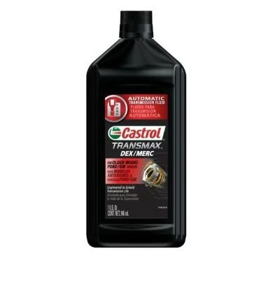

I was looking on Jake’s website and he has a section about his 4l80 builds about what fluid to use. And he briefly mentions hydraulic oil, does anyone use that and is it beneficial to do?
Old Mar 9, 2024 | 07:41 PM
5.7stroker's Avatar
iTrader: (36)
Joined: Apr 2009
Posts: 2,363
Likes: 278
From: OH
This is what Jake told me to run years ago so this is what I run. Usually get it for very cheap at Autozone.
