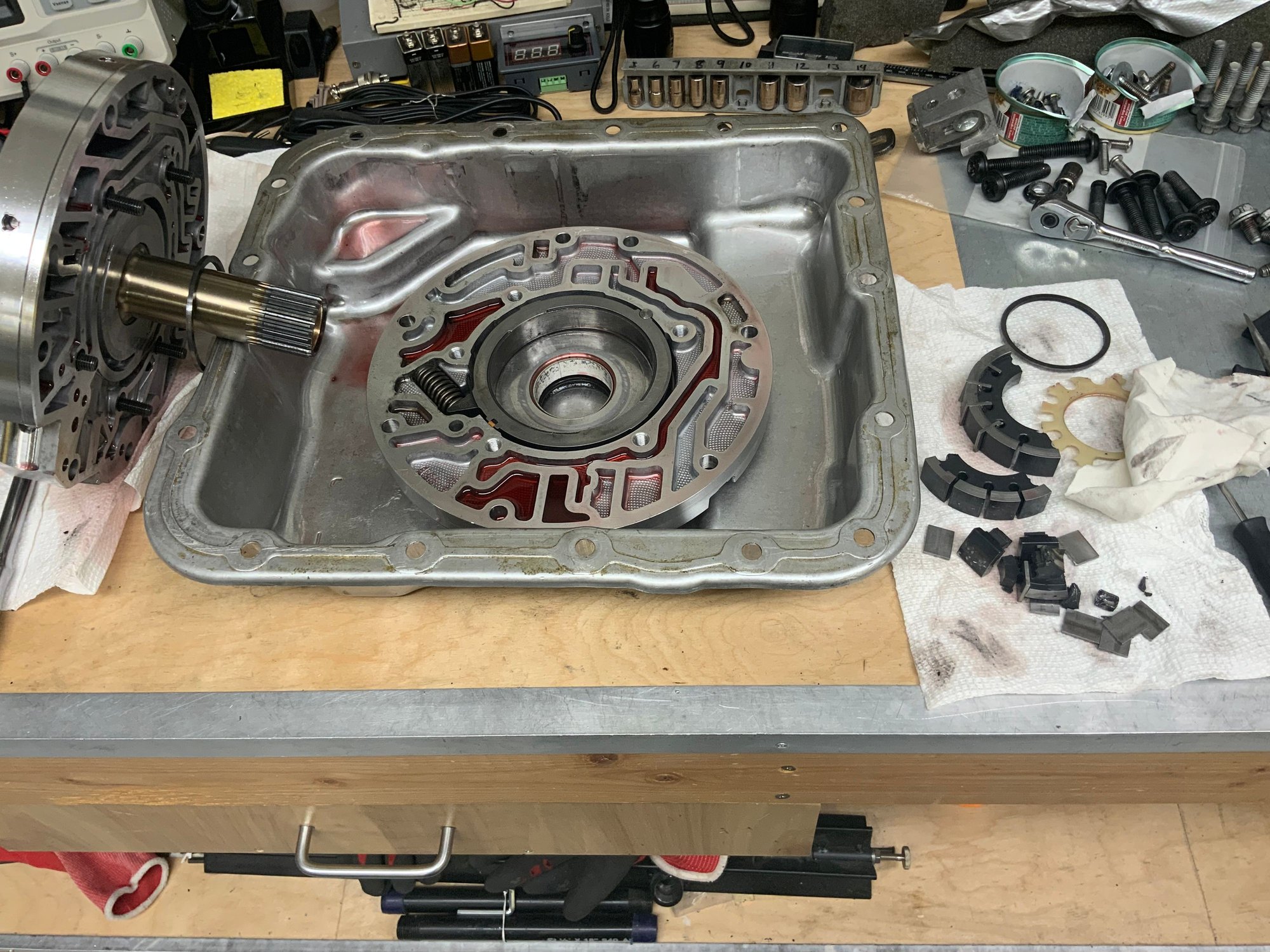

I pulled the tyranny and looked at the pump, it’s busted.
How does a pump just break?

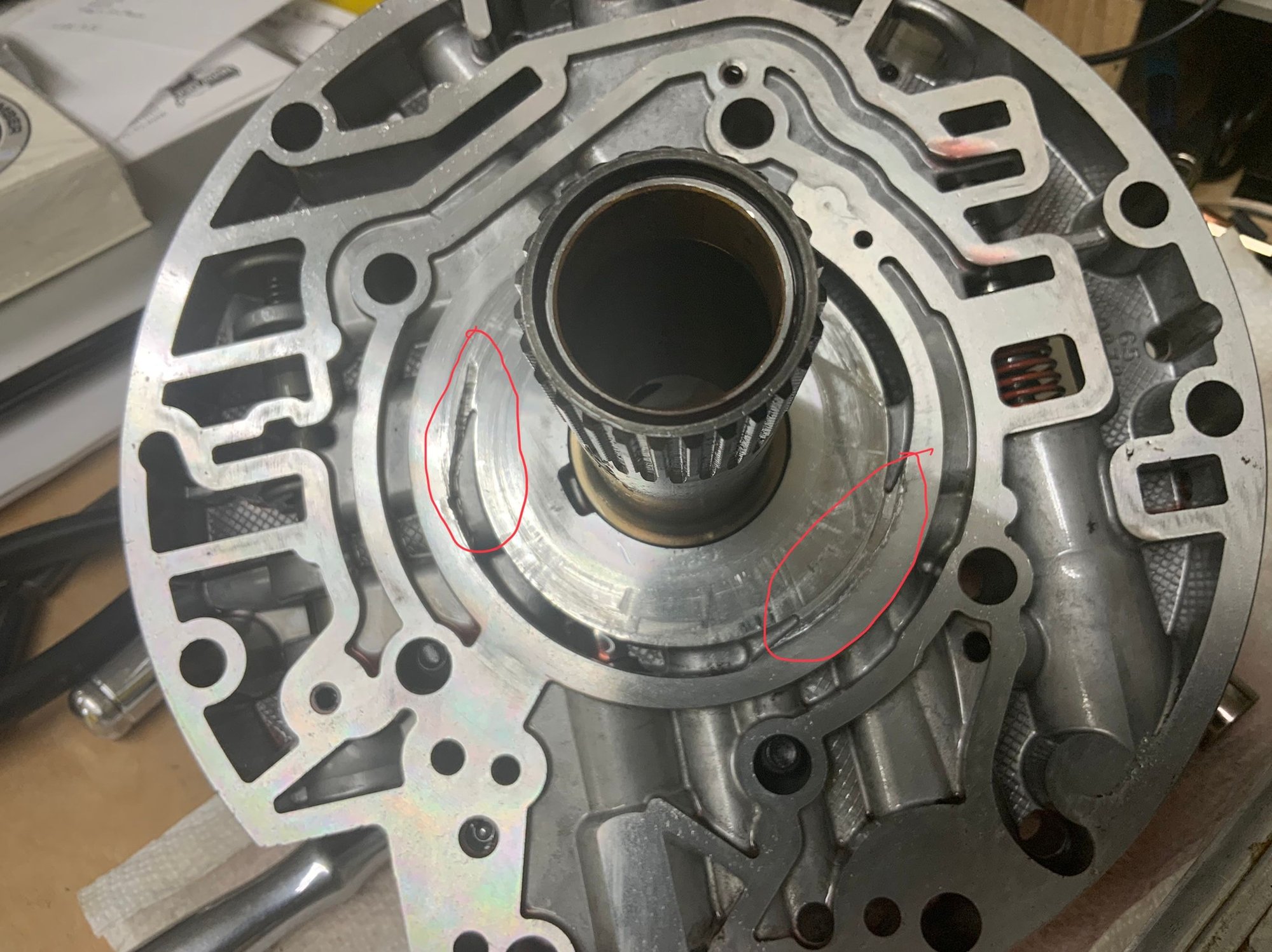

Here is a picture of a pump rotor I took out of a stock build. It was still running and driving. It had lost the 3-4 clutch. I almost re-ran this rotor...

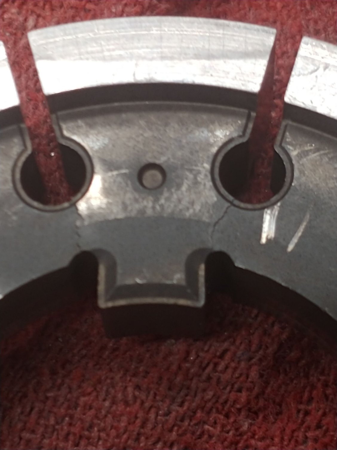

Just looked at the stator that I had put aside when I saw the pump in pieces.
I should have looked at it earlier, it’s toast. A few of the vanes got it.

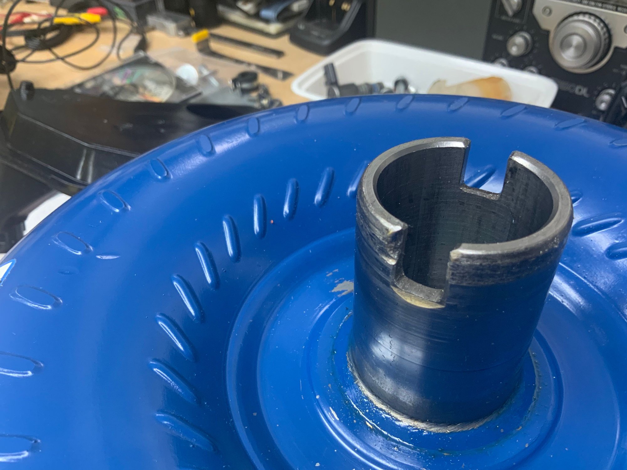

Originally Posted by FranksCustomTrans
Of course sometimes things well JUST BREAK, But more likley excessive converter clearance or low fluild the 60e is notorious for suckig the pan dry particulary if has the shallow pan and I can tell you watching on the dyno low levels or cavation will send that slide bouncing all over the place and that will brek a pump . But I would observe the tags on the converter side ussually you can tell if the converter got on top of it .
Frank, after looking at the tags on the converter this is what found.
Not sure if it was caused by one of the pump blades that got on top of the pump when it broke.
I guess I could weld some material back on and then reshape it.
Do you know the size of the o-rings (number) that are on the 7 bolts that hold the pump assy to the case?

You need to send the converter off to be repaired
A. it definitely needs a new hub
B. It is likely full of debris from the pump that grenaded and will need to be cleaned properly less you risk putting that debris right back into a fresh/rebuilt transmission
Old Mar 27, 2024 | 10:00 AM

Thanks again for all the info. This is the only tranny I’ve pulled apart, I’m still learning.
The 4L65e has a Corvette servo, a TransGo boost valve in it, stock OE diameter, and the wider band.
I did flush out the cooling loop in the radiator and the tranny cooler, only found a few small specks.
The filter in the pump assy had a few very small pieces in it.
I drained the converter and poured the fluids thru a paper coffee filter, only a few specks wire in the fluid.
I didn’t know the hub could be replaced, thanks.
