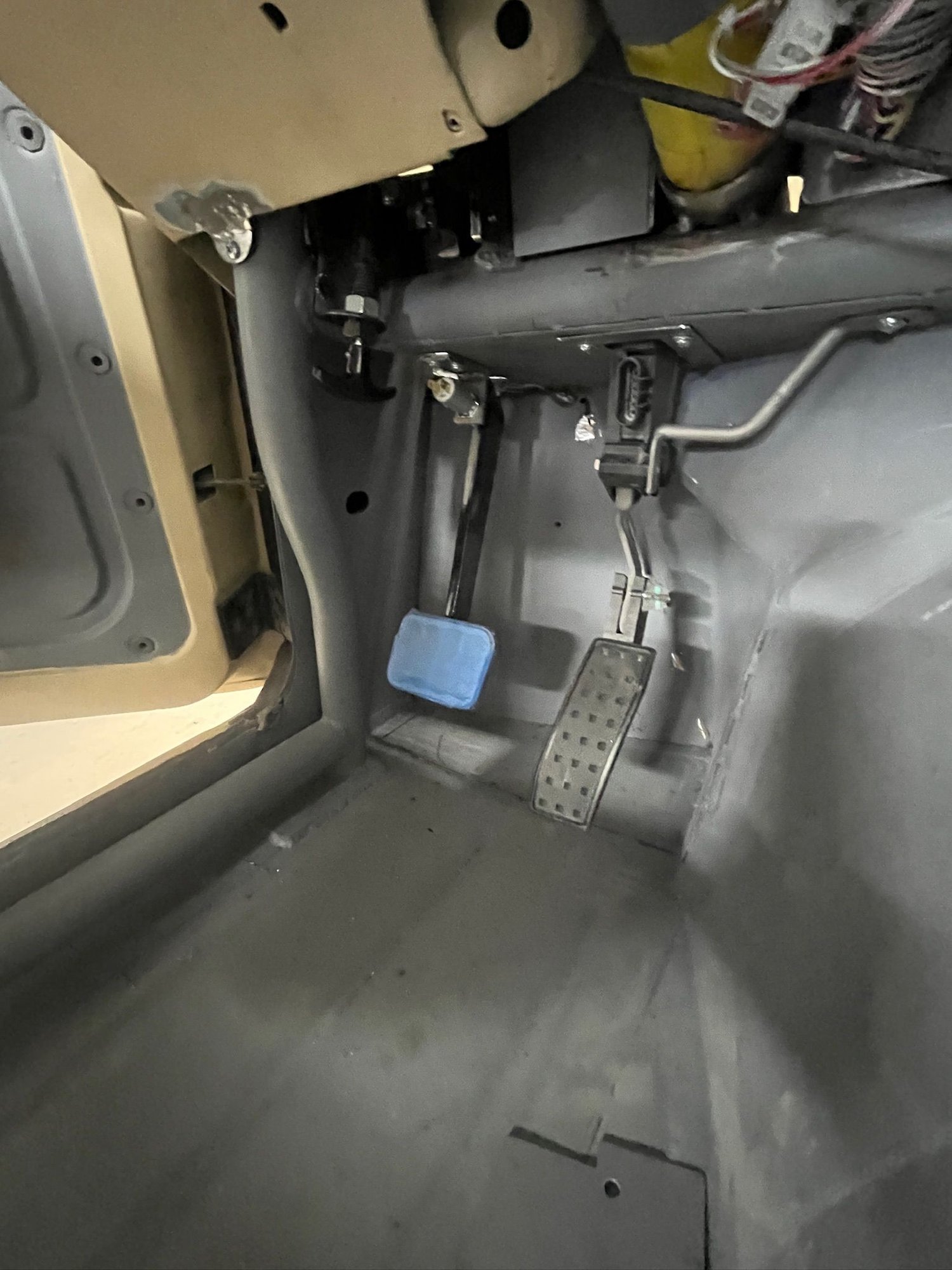

Here are some pictures of some a guy had i think on this site, ( i think he had a nova, but he had sold the car or switched to a different transmission by the time i found him, thought i would start fresh)
that he did, but my pedal looks a bit different

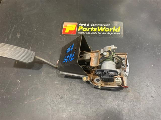

Easiest way to attach cable to pedal
You can buy Nissan accel pedal from 2000 -2008 era
They have strange manual to electric pedals that have sector for cable that goes to drum with sensor on it
Throw away OEM and install yours modern sensor for dual signal like inside BMW pedal (inside cover into it you'll find rotation type standalone sensor )
