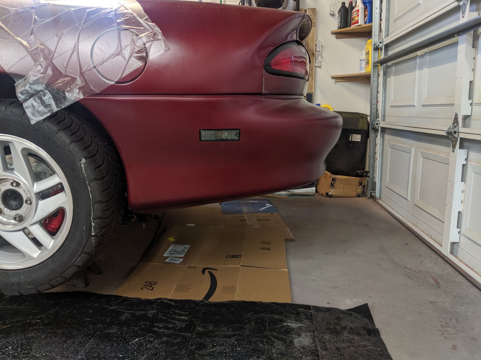

I am now working on the passenger side of the car. I had some small filler work to do, then sand, sand, primer, sand... Finally have some of the color on the car, ran out of paint again and the cold set in for the next week or so.

I am also working on the bumper cover, I have sanded, primed and started the color. I need to double check the wet sanding and then wait for more paint/warmer weather.

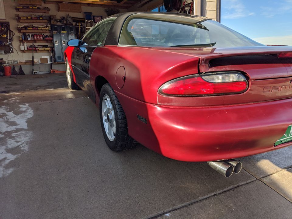

Finally made some real progress over the weekend. I picked up more paint, shot the passenger side and rear bumper, cleared everything and put the rear of the car back together.

I also sanded/filled the sail panel and shot some temporary black paint I had just to seal it and not be primer. Ha Ha

I couldnt resist installing the tips just to see how they look, they are not in the final position yet.

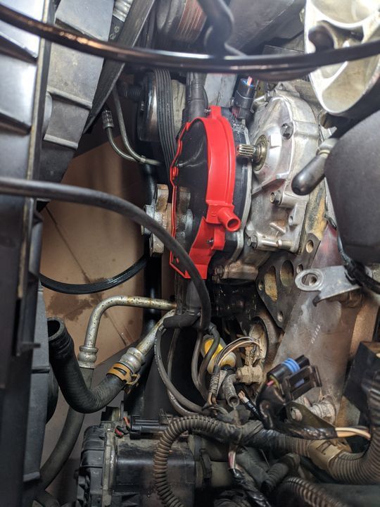

I took a break from the car for the last month or so, I did drive it apx 100 miles, but the last 50 or so was not good... The car would run for a few minutes (or less towards the end) and then shut off randomly... I assumed that it was due to the China fuel pump or Opti. I purchased a new Delphi fuel pump and fuel filter, installed those and no dice, car wouldnt run more than a minute or so and shut off. I pulled the Cardone Opti, rebuilt my stock Opti (50K) and put that back in. Same thing again, ran a bit longer yesterday and then shut off.

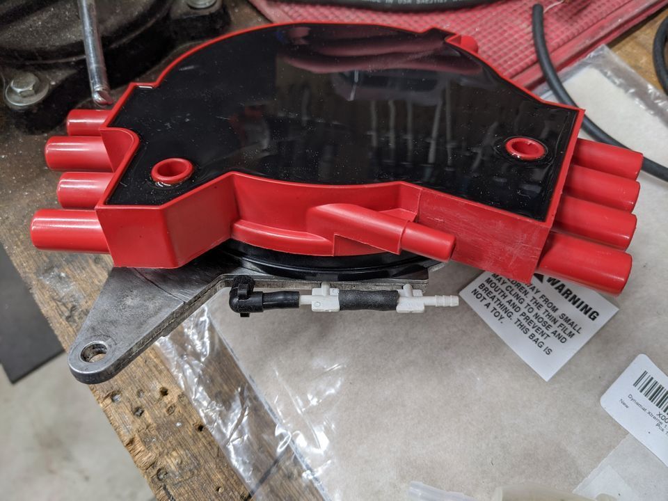

I pulled the Cardone Opti (which was not the problem BTW) and installed my original Opti that I converted to a vented setup. So far everything has been well on that end.

Installed in the car, I hooked up the vent line to my new cast elbow and a Y connector at the intake manifold for vacuum.
